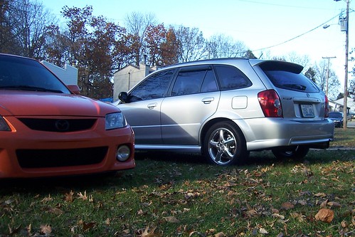

http://www.flickr.com/photos/diehonda/3076497322/
This is the best picture that I have of my painted calipers/rotors/dust shield.
Painting them on it allow you to hit up other brake components.
The link has larger pics.
wont the paint scrap off after a wile when u brake ?
The paint will only scrape off of the area that the pads have contact. the rest will stay painted, for the most part.
Prep is important. If your don't hit the edge of the rotor up with a wire brush or sand paper the rust will cause the paint to not last long.
I hit it up with a fresh coat when I change my pads.
