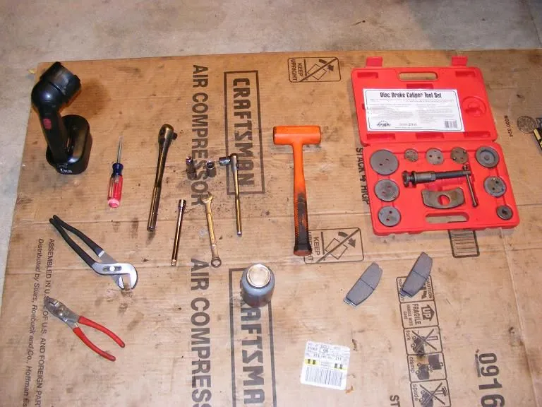

Tools needed:

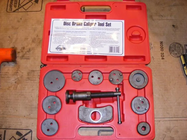

*Brake caliper tool kit* - you can use it for free from Autozone (with deposit of $55)
Floor Jack
Jackstands
New Replacement Pads
Anti-Seize Lube - very important!!!
9/16 socket and ratchet drive
9/16 combo wrench
various pliers - because you never know
Screwdriver - because you never know
Hammer - because you never know
Flashlight

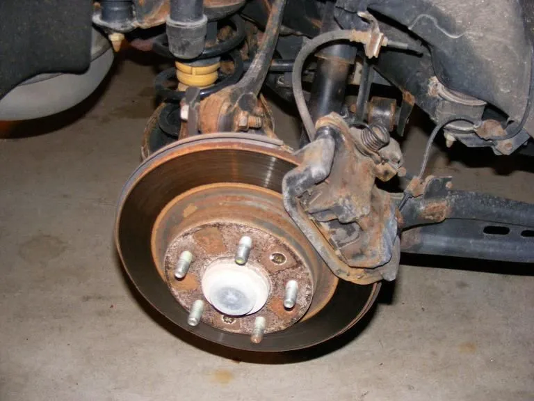

Step 1: Jack up car and safely secure the jackstands in the appropriate positions.
Step 2: Remove wheels and assess the situation.
Step 3: Get in there pussy.

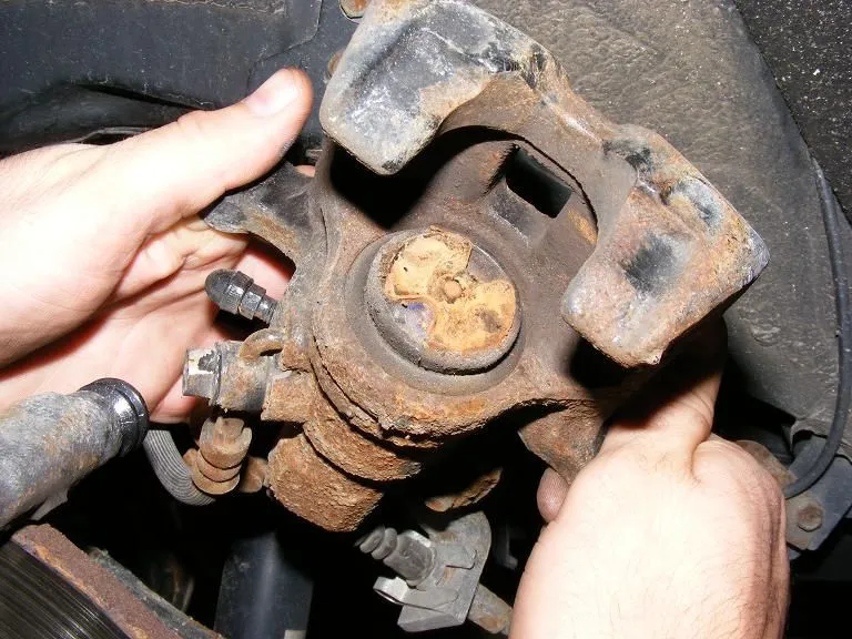

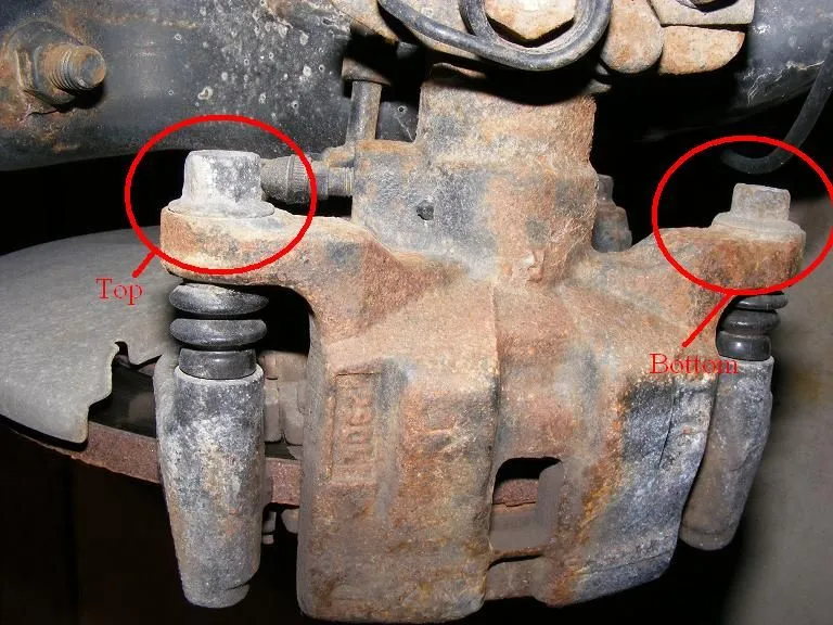

Step 4: Make sure that parking brake is not engaged!

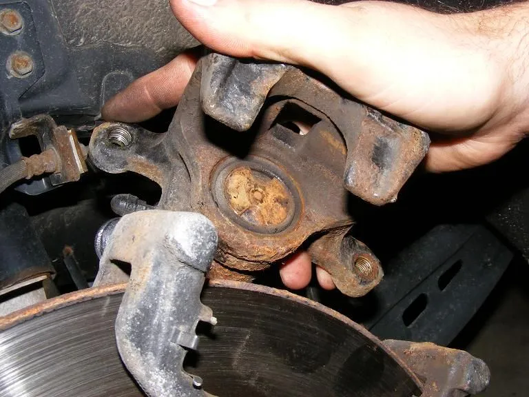

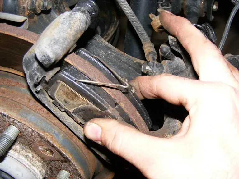

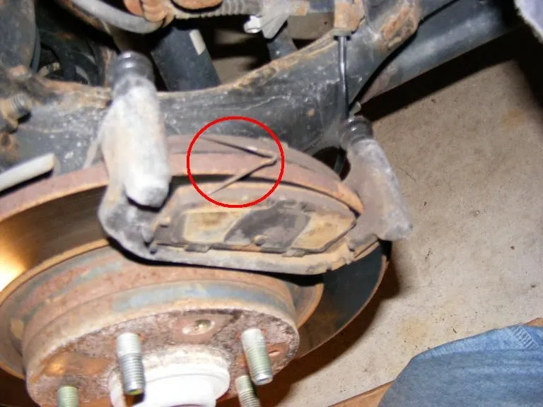

Step 5: Using the 9/16 socket or wrench, remove the slides from the top of the caliper and pull top off of caliper.

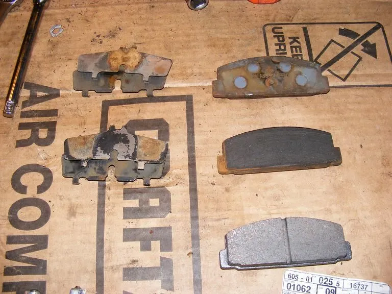

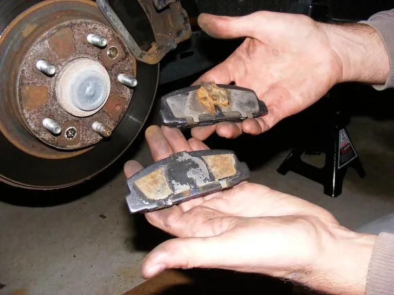

Step 6: Remove "V" shaped metal clip and pull off old pads. Remove both shims from both sides of pads.

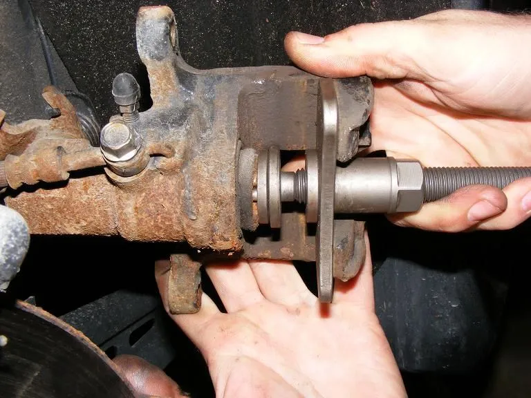

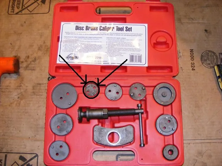

Next step, compressing the Piston.

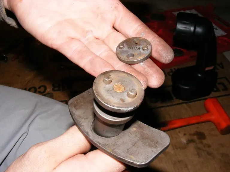

Step 7: Pull out your brake caliper tool and pull out the correct pieces for the piston.
Step 8: Once the tool is extended into position, turn clockwise to compress the piston making sure to leave the groove in a up and down position (see pic 5)
Step 9: Place old shims onto the new pads.
Step 10: Put new pads and shims into caliper bracket, and place the piston portion of the caliper back over the new pads.

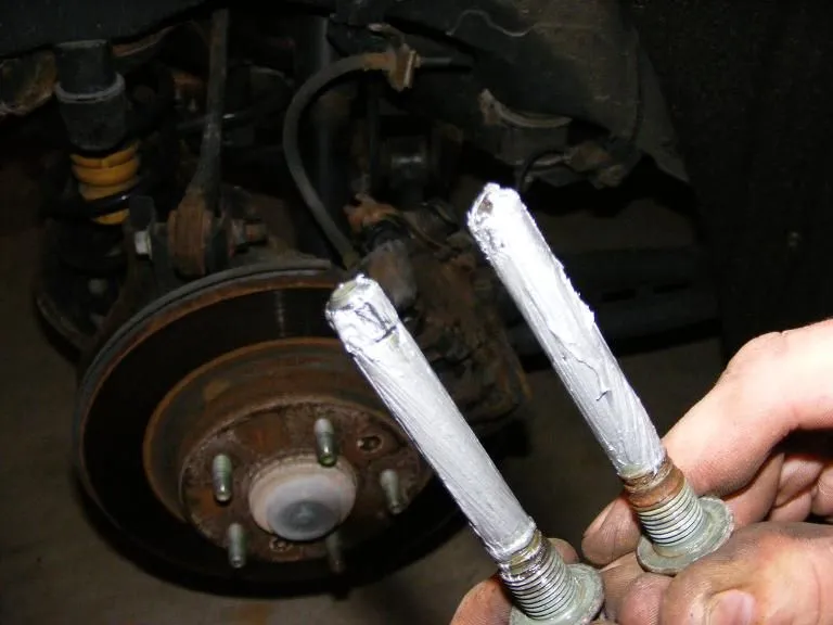

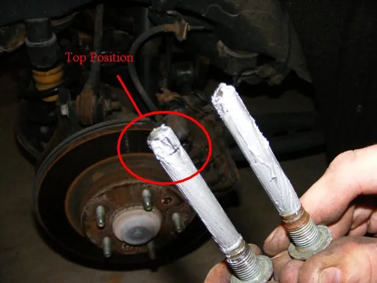

Step 11: LUBE UP CALIPER SLIDES!!
Step 12: Replace caliper slide with the notched/grommeted slide in the Upper/Top position and tighten up with 9/16.
