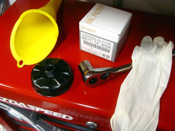

Here are the tools and supplies you'll need for the oil change:
Tools
1. 3/8" ratcheting wrench (something with a longer handle is better, more leverage that way).
2. 19mm socket for said wrench (preferably 6-point).
3. Oil filter cup wrench; your Mazda dealer should have them under part number 49G014001 and the cost should be in the $8-10 range. You could probably get away with using a strap wrench or universal adjustable oil filter wrench, but I prefer the peace of mind from knowing I'm using a tool that has the proper fit (and besides, it was only like $8).
4. Funnel for clean oil. I prefer to use two funnels, one for clean oil only and another for dirty oil only. The "clean oil" funnel I have has a long, skinny neck so it can also work for filling transmission fluid through the dipstick tube. If you clean it between filling the new oil and dumping the old, you can get away with only needing one funnel.
5. Funnel for dirty oil. I use this when dumping out the old oil from my...

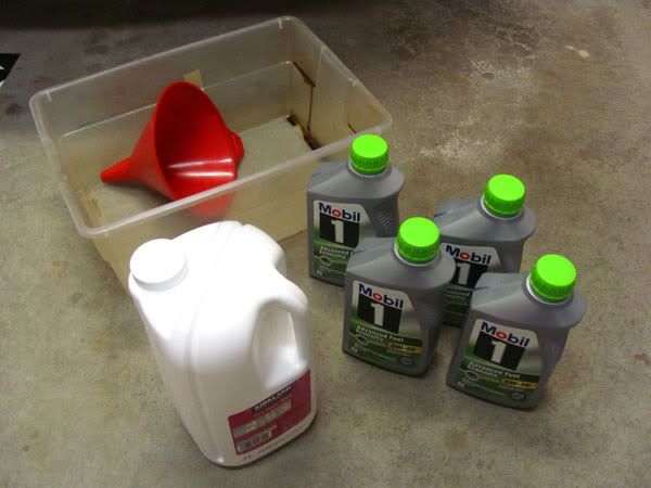

6. Oil drain pan. There are a number of different shapes/sizes/types of these out there, and I've tried a bunch but found myself preferring to use a plain Rubbermaid storage bin. I marked fluid capacity on the side of mine so I know how much fluid has drained into the pan (particularly useful when doing transmission fluid flushes, but that's another thread).
7. Ramps, or jack and jackstands (not pictured). The 2/Demio has decent ground clearance, but you need to get it further up so you can crawl under to drain the old oil. I have a set of Rhino Ramps (about $30) that are safe and easy to use.
Supplies
1. Oil, 4 quarts. The factory recommendation for the 2/Demio is 0W20. The total capacity, according to the owner's manual, is 4.1 quarts with an oil filter change, but you'll never get *all* the old oil out during a change so an even 4 quarts is just enough. I've decided to go with Mobil 1 synthetic as I've had good results with it in the past on MZR engines (the engine in the 2/Demio is a member of the MZR family). I found it for $6.50/quart, but supposedly it can also be found in a 5-quart jug for about $25.
2. Oil filter. I prefer to use OEM filters as they've been found to be of very high quality and are decently priced (about $7 from the dealer). The part number you want for the OEM filter is BY61-14-302A (there is supposedly another part number that will also work, but isn't compatible with the oil filter cup wrench above). Other brands I've heard of people having good luck with are Wix and Purolator.
3. Empty 1 gallon jug for old oil. I suppose you could just pour the old oil back into the empty 1 quart bottles the new oil came in, but when I've done that in the past it was a PITA and I got oil all over the place. Pouring it all into an old milk jug made taking it to the recycling center so much easier. (Note: In the USA you *have* to recycle old motor oil. It's illegal to throw it in the trash, and extra illegal to pour it down the drain.)

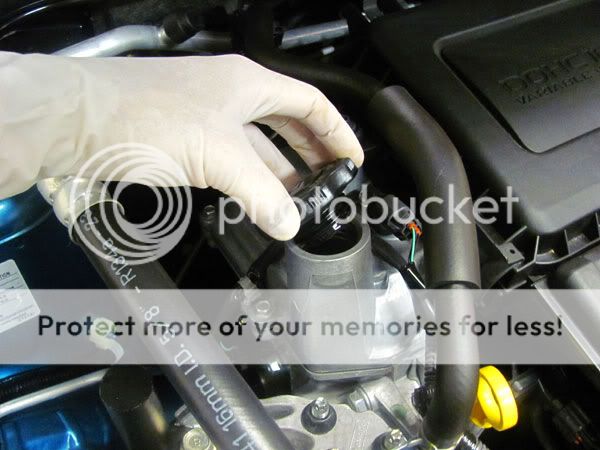

3. Pop the hood and unscrew the oil filler cap (this should help the old oil drain out a bit faster):

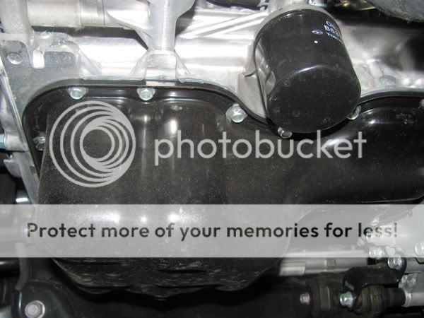

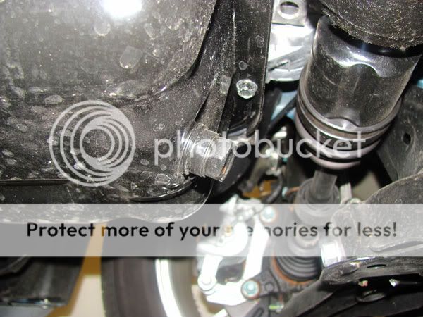

4. Under the car, locate the oil filter and oil pan drain plug. The first picture was taken from the front of the car looking towards the back and shows the oil filter. The second picture was taken from underneath the car looking towards the front right wheel and shows the oil pan drain plug.

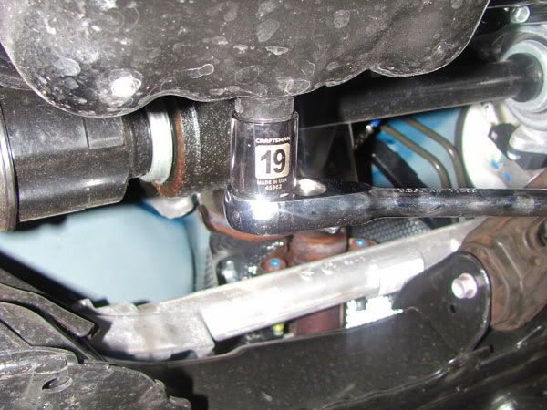

5. Position your oil drain pan underneath the drain plug, and use your wrench and 19mm socket to break the plug loose:
Only break the plug loose with the wrench, unscrew it the rest of the way by hand. When it comes out you'll likely get some oil on your hands, so gloves are a really good idea. Be careful to not drop the plug into the drain pan!

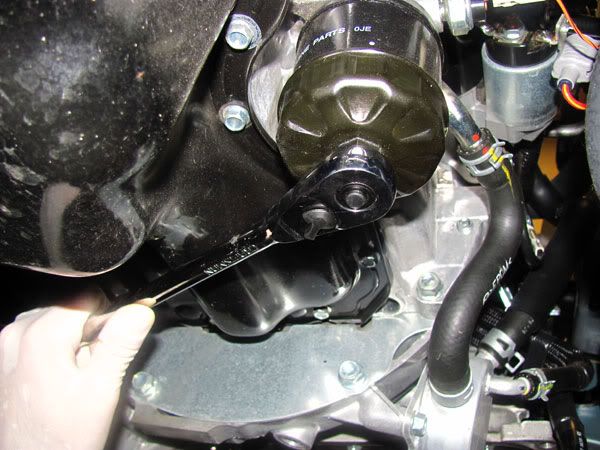

8. Time to remove the old oil filter. Move your drain pan to under the filter, then break it loose with your ratchet and cup wrench:
Once you've broken it loose, you should be able to unscrew it the rest of the way by hand. Again, you'll probably get some oil on your hands. Once the filter is off, dump the oil that's in it into the drain pan and set the old filter aside.

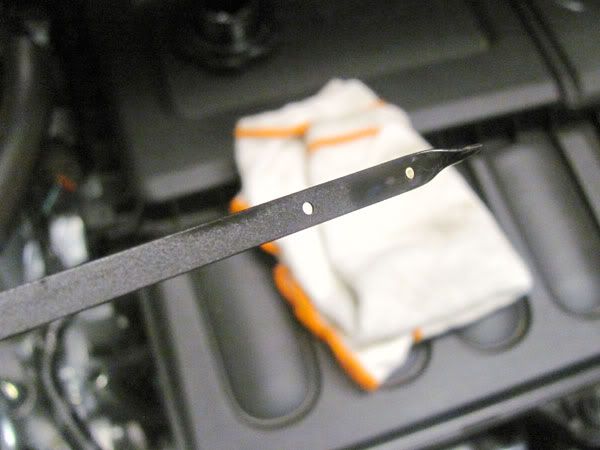

12. You don't want to overfill the oil, so check the oil level now before putting in the remainder of that last quart. Pull out the dipstick (yellow handle right next to the oil filler), wipe down the blade with a clean paper towel or microfiber, then reinsert it. After a couple seconds, pull it back out and take a look at the very end. You want the oil level to be between the two holes, preferably closer to the one farthest from the end:
Here you can see my oil level is halfway between the two holes on the dipstick.
13. If the oil level on the dipstick is low, add more new oil through the funnel and check the dipstick again. During the oil change I performed when making this walkthrough, I ended up using all four quarts of oil and the final oil level was right in the middle between the "MIN" and "MAX" holes on the dipstick.
