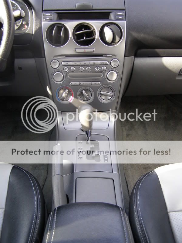

Actually mine looks like this. It's the button to the farthest right. It reads "Tape/MD" I'm guessing it's very similar. I have no tape deck/satellite radio/disc changer, so right now the button serves no function whatsoever. I'm thinking it will be my "media" button and switch to my ipod if I get it.
