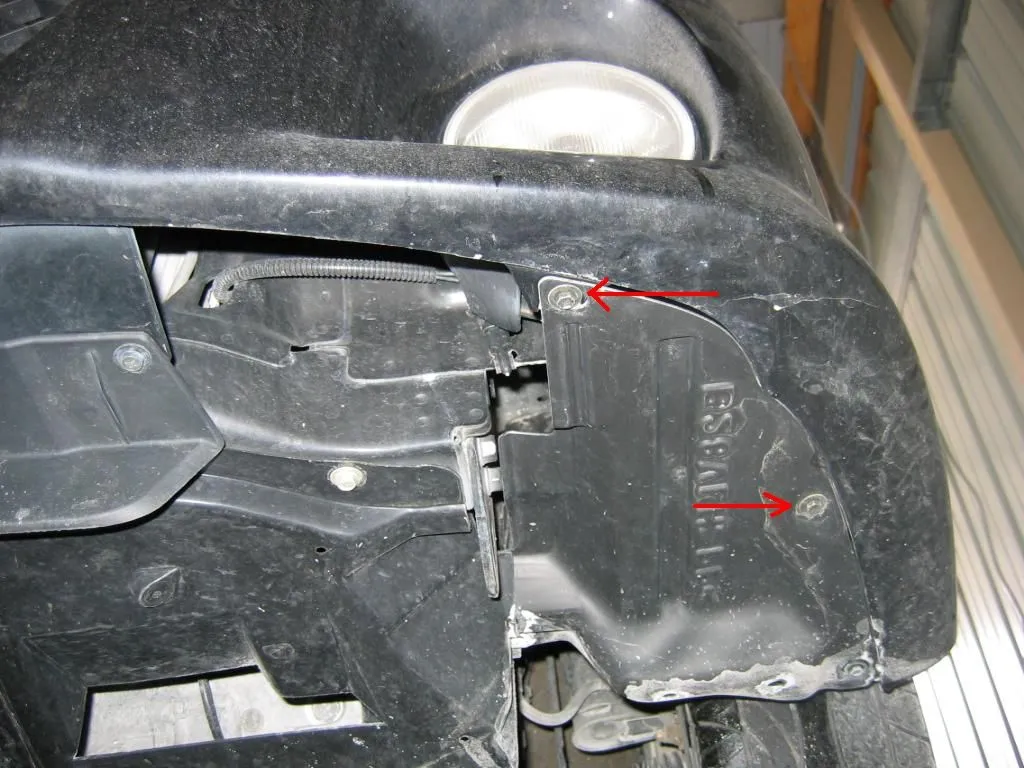

Step 1:
Lift up the car and locate the panels that are under each foglight. Remove the two screws that hold the panel in place. You can then pull back the panel and gain access to the back of the foglight.
See picture 1

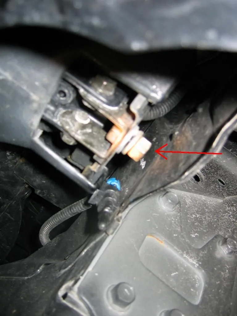

Remove the one bolt that holds the fog light in place with a 14mm crescent wrench. It might be on tight, but you should be able to break it free pretty easily.
See picture 2
Step 3:
Pull the fog light out of the car as far as you can. You don't have much slack, but you will be able to expose a blue clip that sits right behind the fog light.
See picture 3
Use the flathead screwdriver to pop the blue clip backwards. Then you can pull the foglight out even farther, and you will be able to see the blue clip on the wire harness.

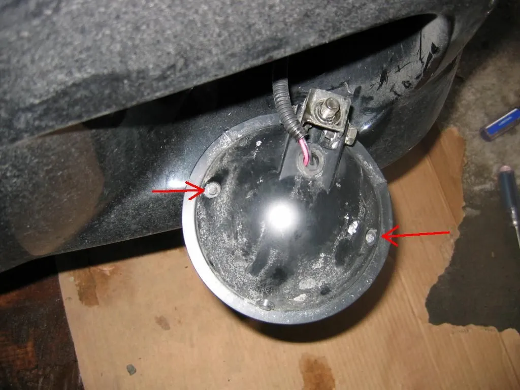

Use the philips screwdriver to remove the two screws that hold the glass onto the body of the foglight.
See picture 5

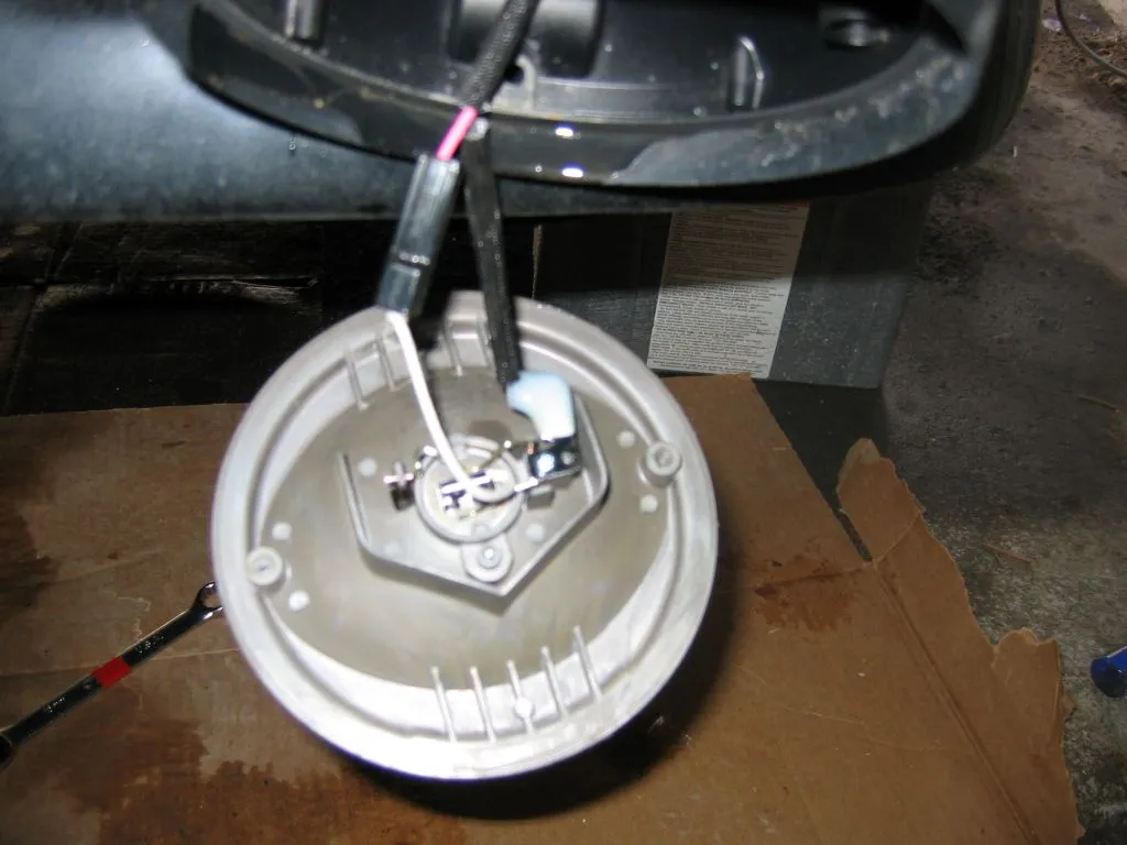

Once both screws are out, you can pull the glass off the body of the fog light. You will see a metal clip that holds the bulb in place. It works the same way as the ones that hold the low-beams in place. Undo the metal clip and pull it all the way back so that you can remove the bulb.
See picture 6
Step 6:
The H3 bulbs have an attached wire. Disconnect that wire from the plug and remove the bulb. Put your new bulb in, connect the wire, and push the metal clip back into place. When putting the new bulb in, you will notice that the metal flange has a half-circle indentation on side and a square indentation on the other side. This makes it so the bulb has only 1 correct orientation.
