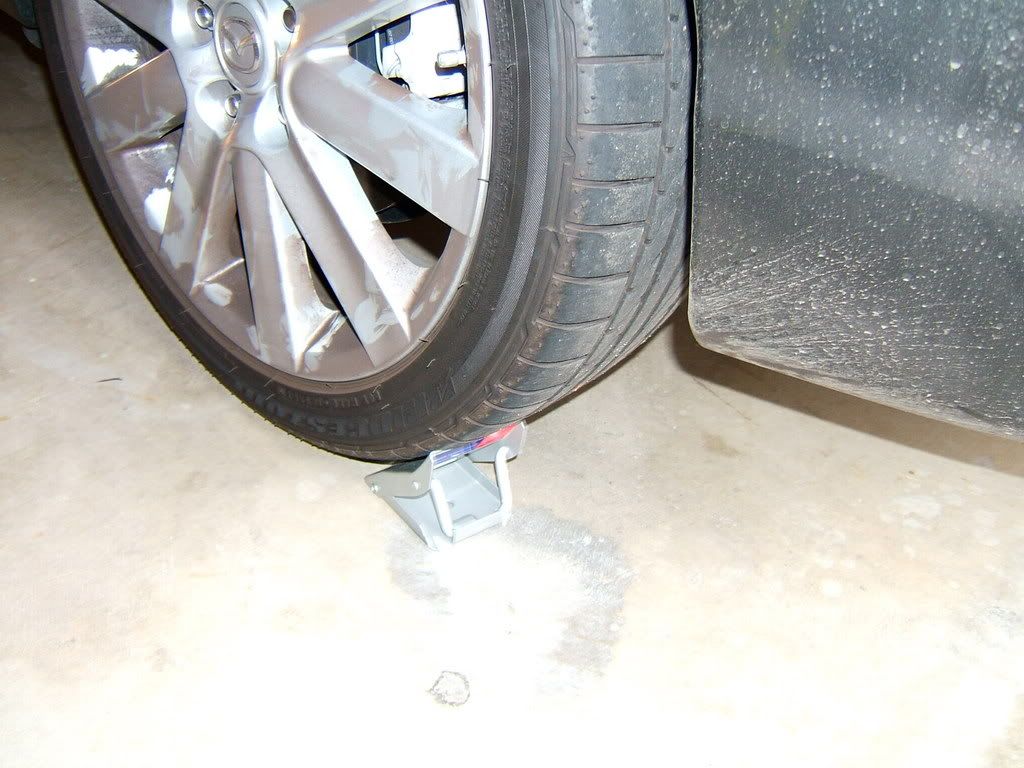

First, you'll need to chock your wheels in the rear. SAFETY IS PARAMOUNT
Don't mind the brake dust, I haven't washed my car yet.....(hand)

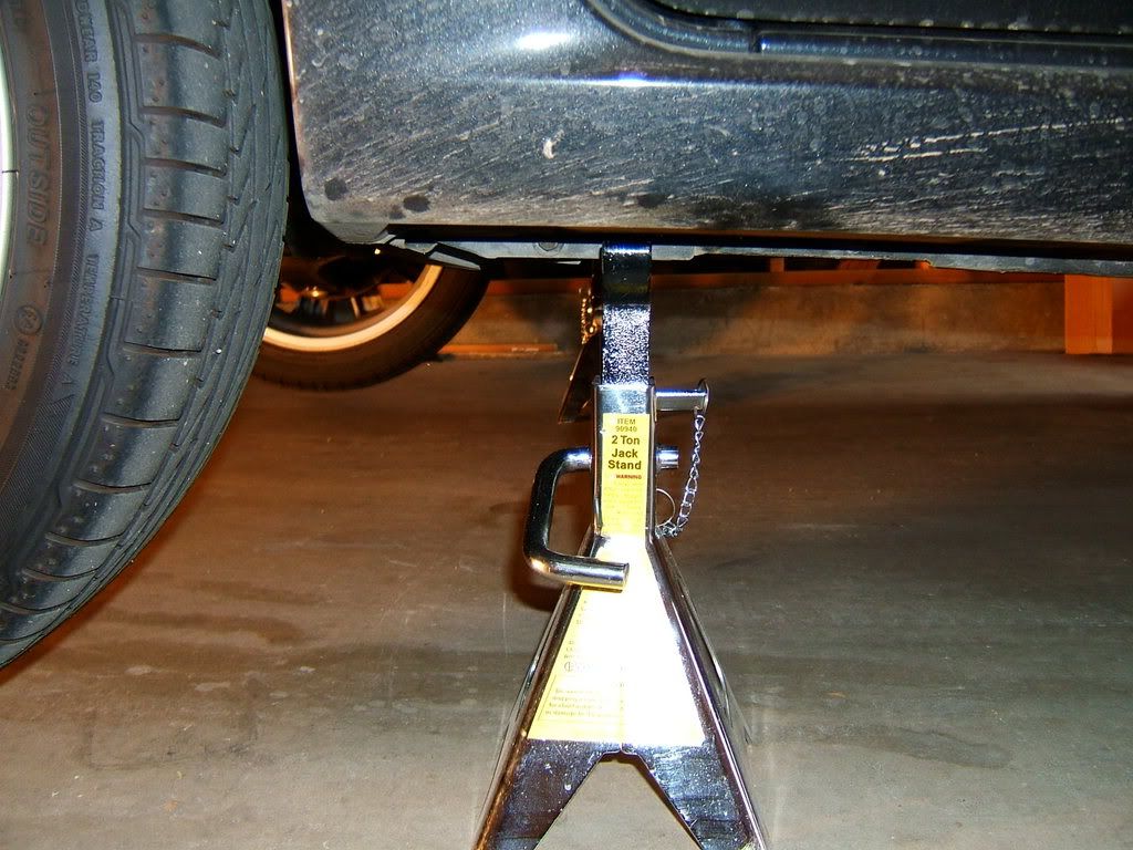

Next you'll want to get your car up on jackstands, do that to both sides as pictured here... you'll need the ground clearance to get underneath your car if you're wondering why. (yes)

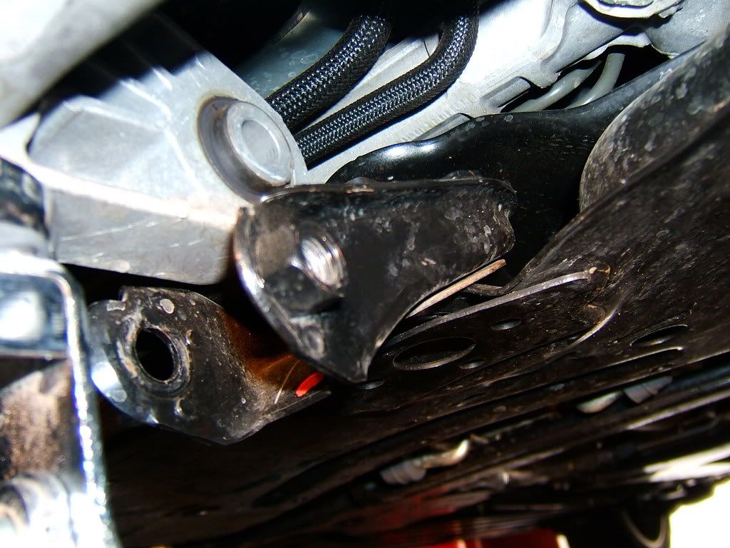

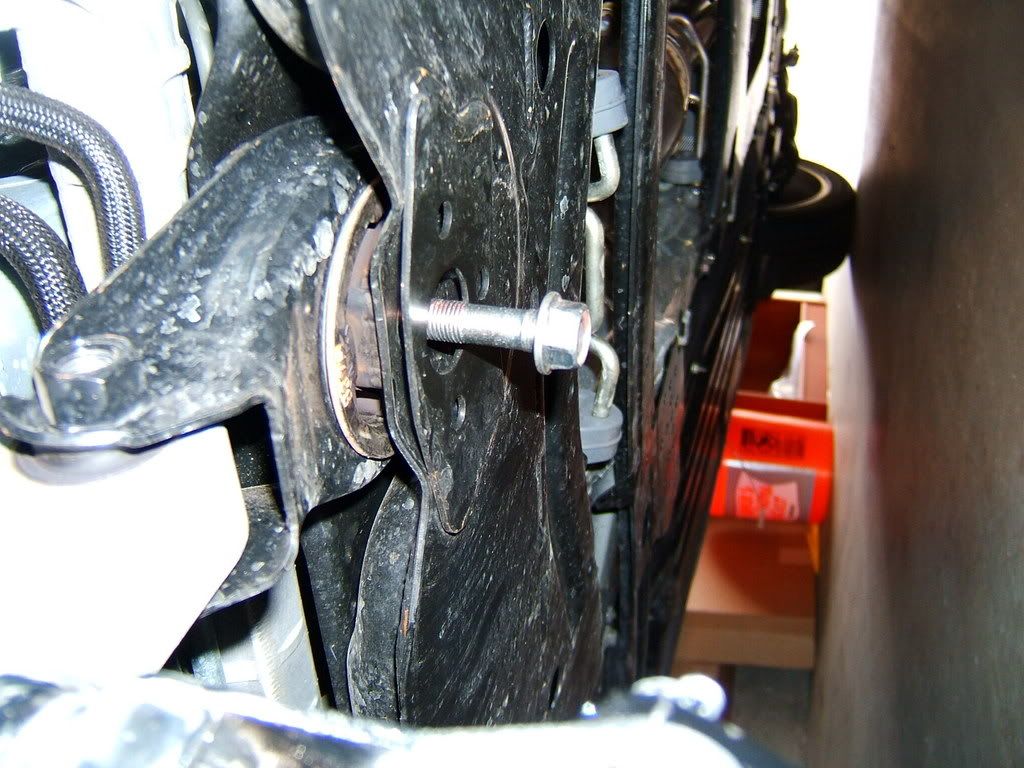

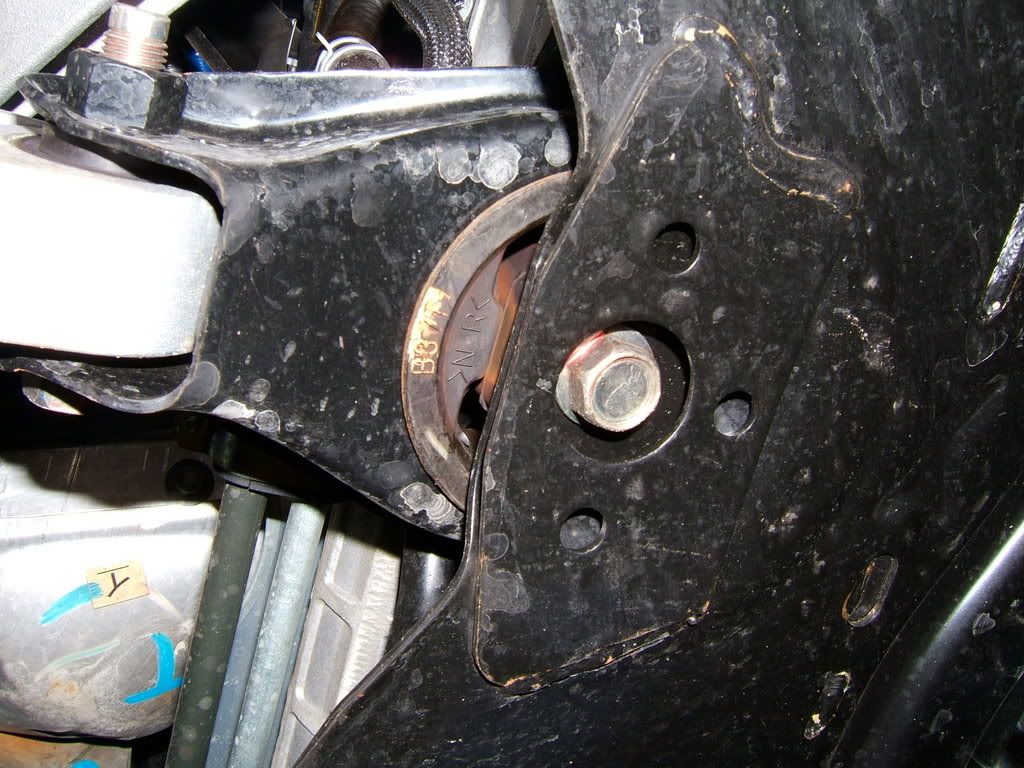

After that, you'll need to crawl underneath, with your ratcheting tool, and socket in hand... and undo this bolt,
then undo this next bolt.
Pop them out, and voila, you're halfway finished with the uninstall of the stock mount.

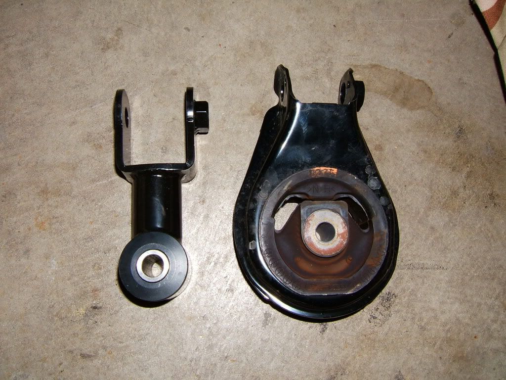

Here are the mounts side by side. Nice, eh?

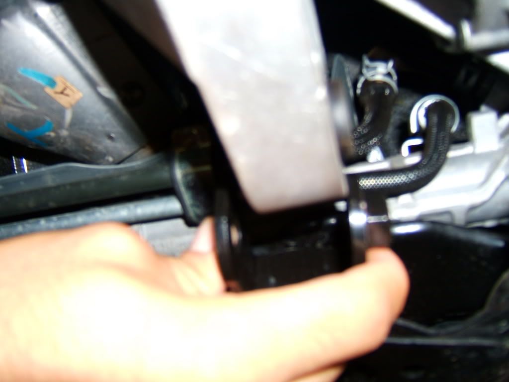

Remember when you pulled that mount out? The perch where the STOCK motor mount sat will be the starting point of inserting the TRZ Dog Bone mount.

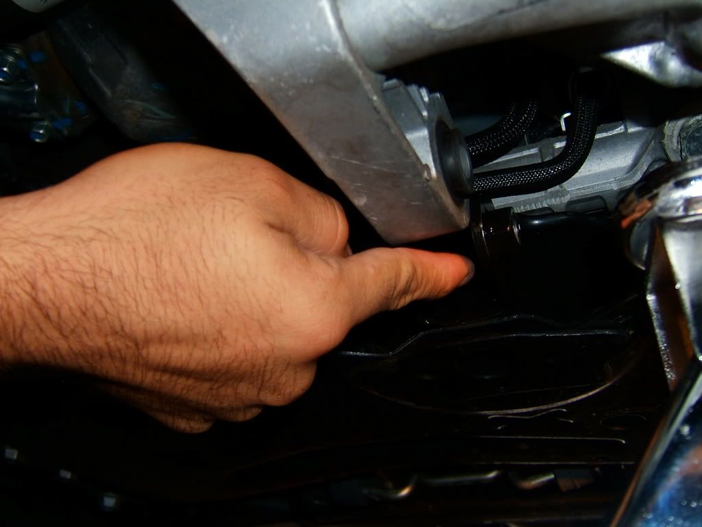

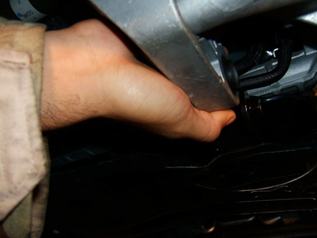

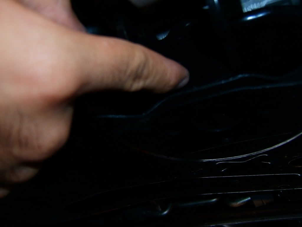

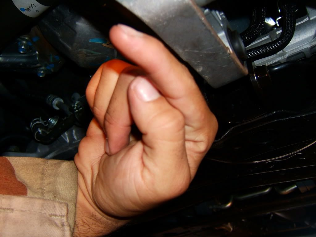

First, you'll want to insert the mount ALL THE way into the perch. That'll give you enough clearance to push the rest of the mount into position where the bolts will be inserted into. I'm pointing at it here, it's hard to see since its all black and dark in there, but you'll see it when you're under your car.

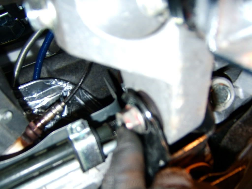

See the way I'm pointing? That's the direction you'll want to pull the tranny in order to get the DogBone in there with enough clearance.
Now pull.
And you should have enough clearance to feed the mount into position here.
almost in.
There, now it'll go in perfectly. Good job!

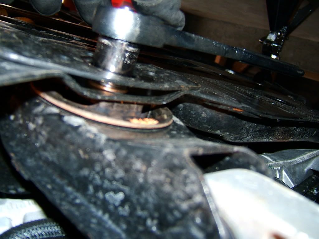

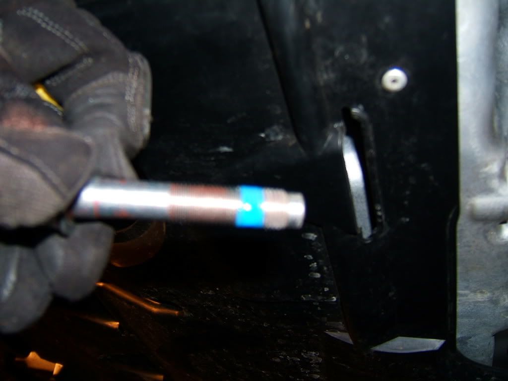

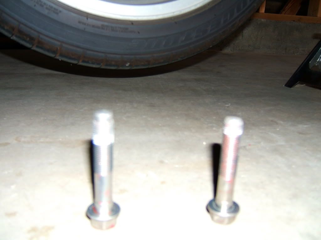

Now once you have the mount in; this is where you'll want to put lock-tite on your bolts before inserting them back into their resting place.
If you look on the bolts when you took them off, you'll see some risidue where "lock-tite" was put on from the factory. I just cleaned off what I could, and put on some new lock-tite in those areas. Then insert, and tighten. Like so.
With fresh lock-tite:
I'm not sure exactly what the torque specs are for this bolt, but I tightened it as tight as it was when I took them off. You'll be able to figure this out on your own when you do this.

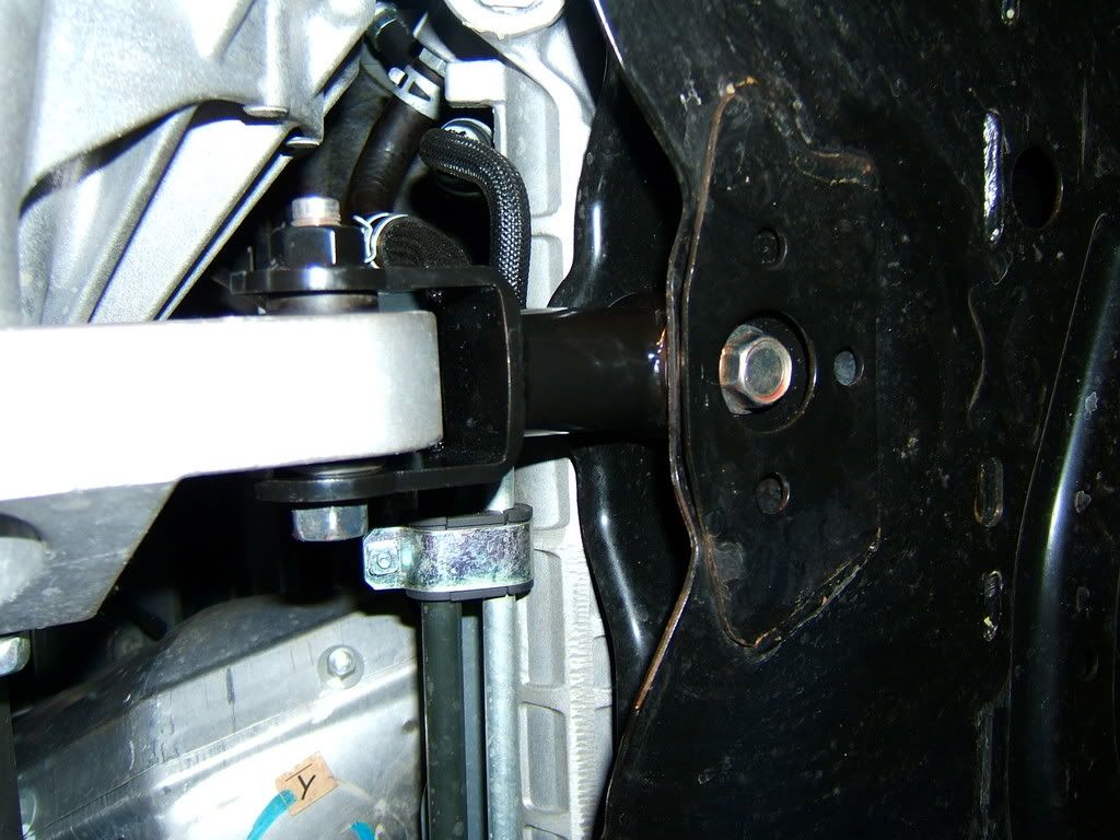

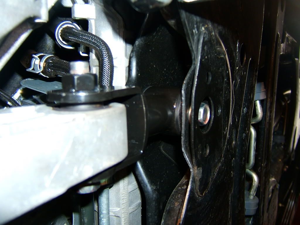

Here is the finished install!! If you made it this far, congraulations!!!
