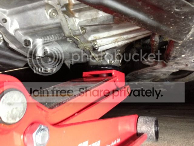

This thread is based on my experiences installing the 3 engine mounts, and allows you to install your mounts with the greatest amount of ease possible. Please reference the pictures for jack placement, this is crucial in lining up the bolts correctly

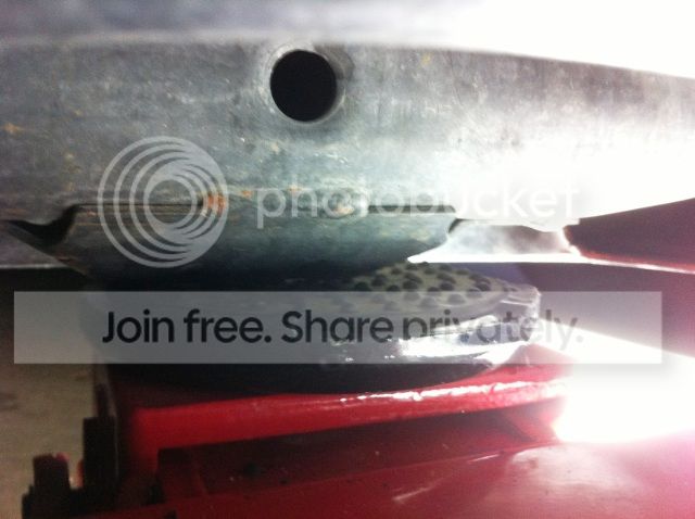

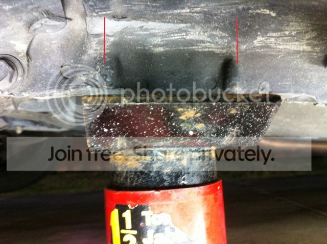

  2. Jack up ONLY the front of the car using the front jack point-see the pictures below for the jack point (this allows engine to lean backwards, greatly aiding in the rear mount install)
  3. Place one jack stand on both the driver and passenger side, in between the two metal bulges marked with red lines in the picture below. Once both jacks are in place, gently lower the floor jack, leaving the car on the two jack stands

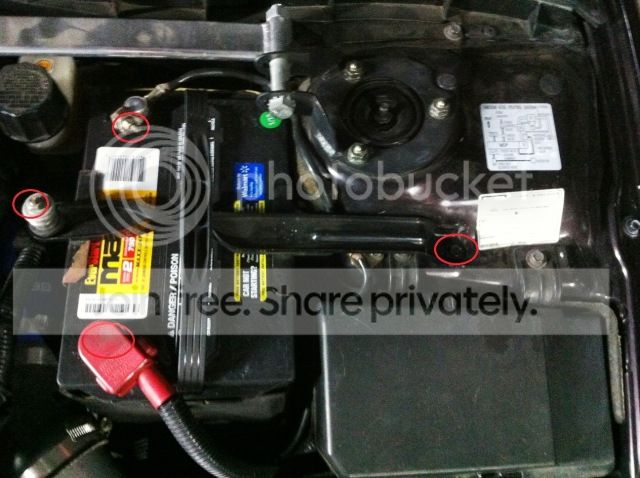

  4. Disconnect the negative and positive battery terminals using a 10mm deep well socket or open ended wrench (negative first)
  5. Remove the battery tie down bracket using a 10mm socket (2 bolts)
  6. Remove the battery

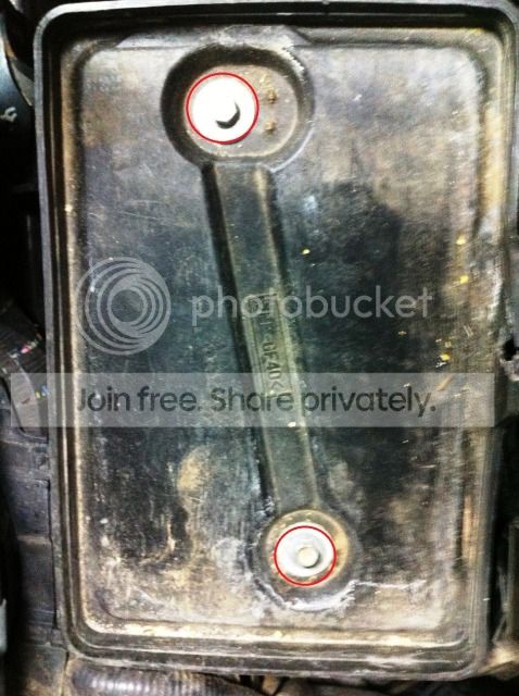

  7. Remove the battery tray using a 10mm socket (2 bolts)

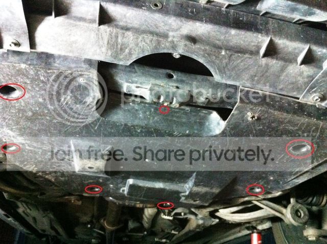

  8. Remove the under tray of engine using a 10mm socket (7 bolts)
  9. Support engine using a padded jack, or with a piece of wood in between the motor and jack, to avoid damage. Then, lift engine 1 inch to relieve pressure from engine mounts (see picture for jack placement)

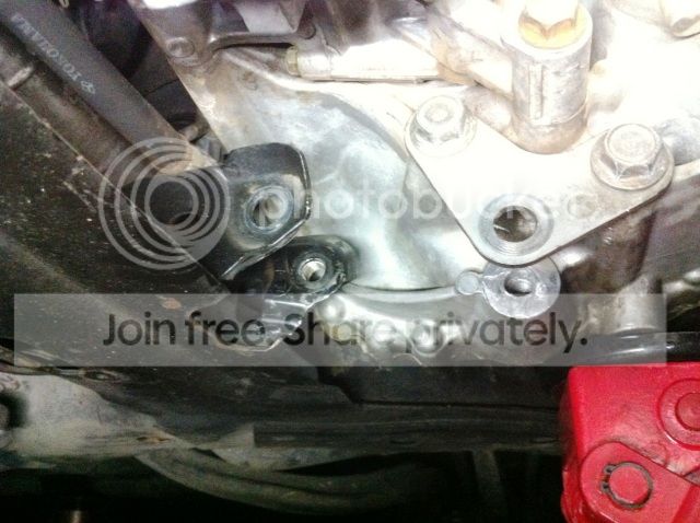

Rear Engine Mount Removal
  1. At this point, you should be on 2 jack stands, with the engine supported using the floor jack (see the above picture for jack placement)
  2. Remove the lower bolt from the triangle bracket using a regular 17mm socket (breaker bar may be needed)
  3. Remove the rearward engine mount bolt using a regular 17mm socket
  4. Remove the engine mount, some wiggling and pulling may be required (use a crow bar or rubber mallet if stubborn)

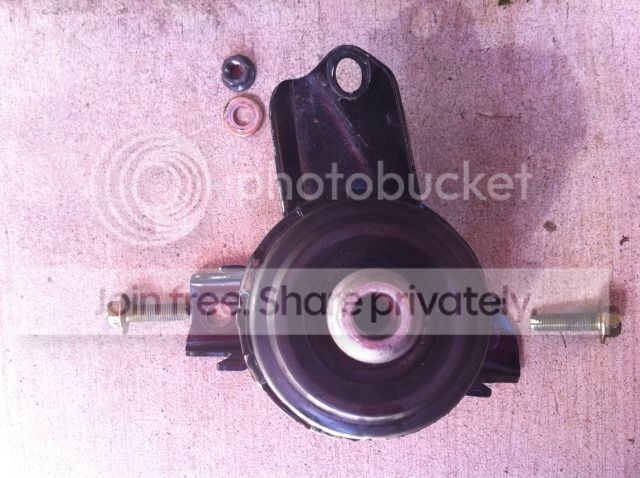

Rear Engine Mount Installation
  1. To allow for easier install, use plyers or a crow bar to slightly bend back the two tabs on the engine mount bracket to allow for easier installation
  2. Hand-thread the rear bolt through the mount, leaving the mount hanging downwards
  3. Hand-thread the front bolt of the mount into position
  4. Tighten the lower triangle bolt to 85 ft/lbs using a regular socket
  5. Tighten the rear engine mount bolt to 85 ft/lbs using a regular socket

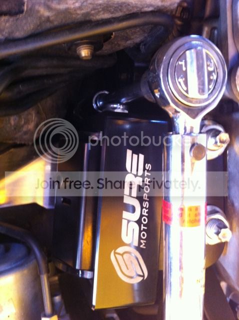

Transmission Mount Removal
  1. Support engine using a padded jack, or with a piece of wood in between the motor and jack, to avoid damage. Then lift engine 1 inch to relieve pressure from engine mounts (see picture for jack placement)

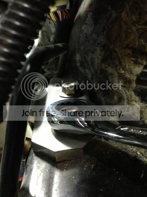

  2. Slightly loosen, but do not remove the 17mm bolt/nut running through the OEM mount using a regular socket with 6" extension (2 turns of the bolt)

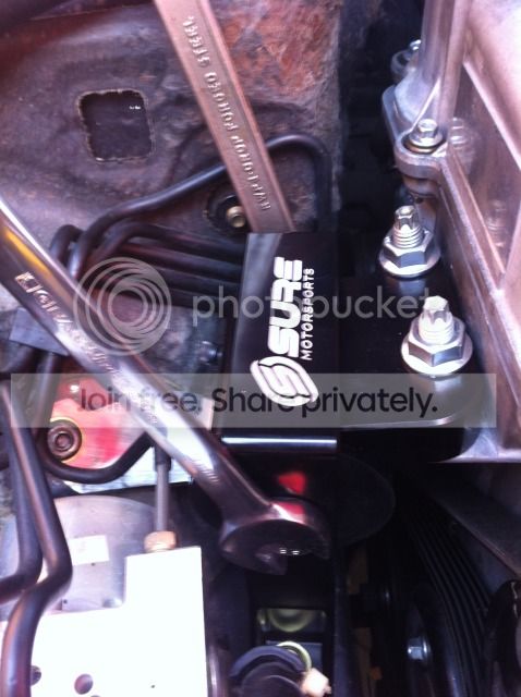

  3. Loosen the 4 14mm bolts 2 located on the top and side of the mount using a ratcheting angled wrench (use a hammer to tap the wrench to help break bolts loose if needed)

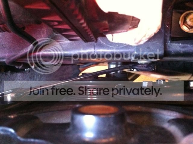

    Driver Side Rear
    Driver Side Front
    Top Bolts
  4. Remove the previously loosened 17mm bolt running through the OEM mount (slightly lifting or lowering the engine to line up the bolt for extraction WILL be required, do NOT force it through)
  5. Remove the 4 previously loosened 14mm bolts using the angled ratcheting wrench
  6. Remove the mount

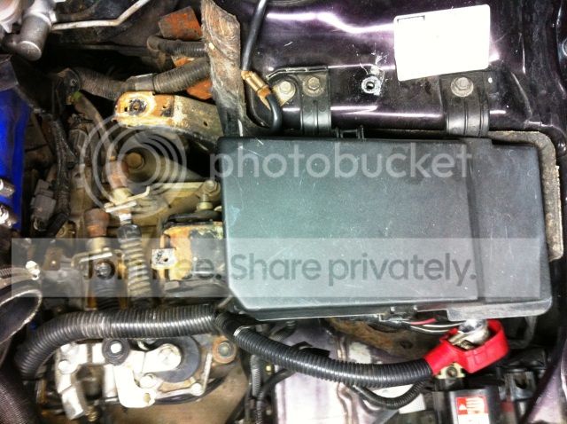

**Removing the Fuse box is NOT required, but may help if you have large tools-3 10mm bolts/nut
See Jamie's instructions for more info on removing the fuse box. Please note my jack point is different, which makes my install guide easier: Link

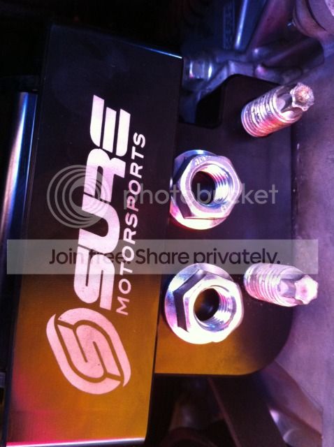

Transmission Mount Installation
  1. Lift/lower engine as needed to align the 4 14mm bolts/align mount into place
  2. Hand tighten the 4 14 mm bolts
  3. Hand tighten the 17mm bolt running through the mount (lifting or lowering the mount to line up the bolt WILL be required, do not force it through)
  4. Tighten the 2 top bolts as much as possible with the ratcheting wrench (55ft/lbs is OEM spec)
  5. Tighten the two side bolts as much as possible with the ratcheting wrench (55ft/lbs is OEM spec)
  6. Lastly, tighten the main bolt running through the mount to 85 ft/lbs using a regular 17mm socket with 6" extension

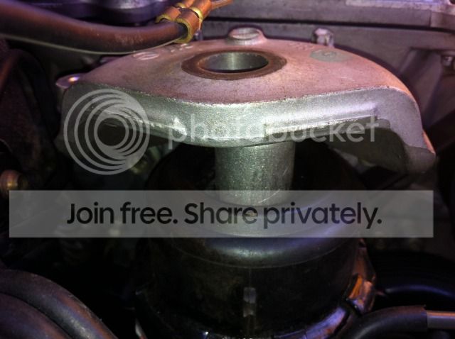

Passenger Mount Removal
  1. Support engine using a padded jack, or with a piece of wood in between the motor and jack, to avoid damage. Then, lift engine 1 inch to relieve pressure from the engine mounts

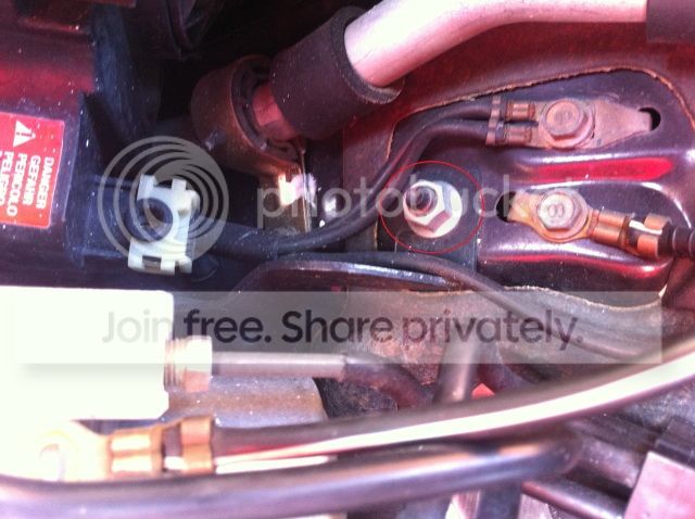

  2. Remove the engine ground from the engine joint bracket using a regular 10mm socket (circled below)
    Loosen all 3 of the 17mm nuts/bolt using a deep well socket with extension (breaker bar may be needed)
    Remove the mount's main 17mm bolt
  3. Remove the engine joint bracket by first removing the two 17 mm nuts, then lift engine until bracket becomes loose ~2inches
  4. Remove the 2 bolts and 1 nut securing the OEM engine mount to the frame using a 14mm socket with either a 6" or 12" extension as needed
  5. Remove the OEM Mount

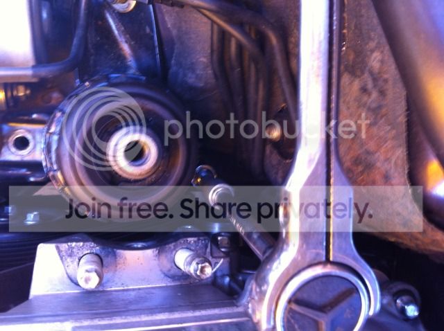

  5. Tighten the mount's main 19mm bolt to 65 ft/lbs. To do this, first, tighten using two 19mm wrenches on either side to make the bolt very snug.

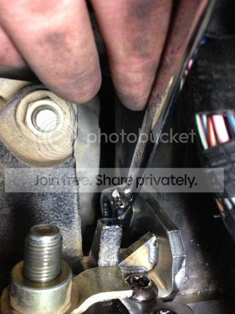

    Loosen the electrical assembly
    Now, loosen the two 12mm bolts (circled below) using a socket with 12" extension and ratcheting wrench, to allow for a torque wrench to be used.
    Use a ratcheting wrench on the side bolt
    Use a regular 12mm socket with 6" extension on the nut
    Once the two bolts and one nut are off, gently move the assembly to align your torque wrench onto the mount's nut.
    While using a wrench to hold the nut, torque the bolt to 65 ft/lbs
