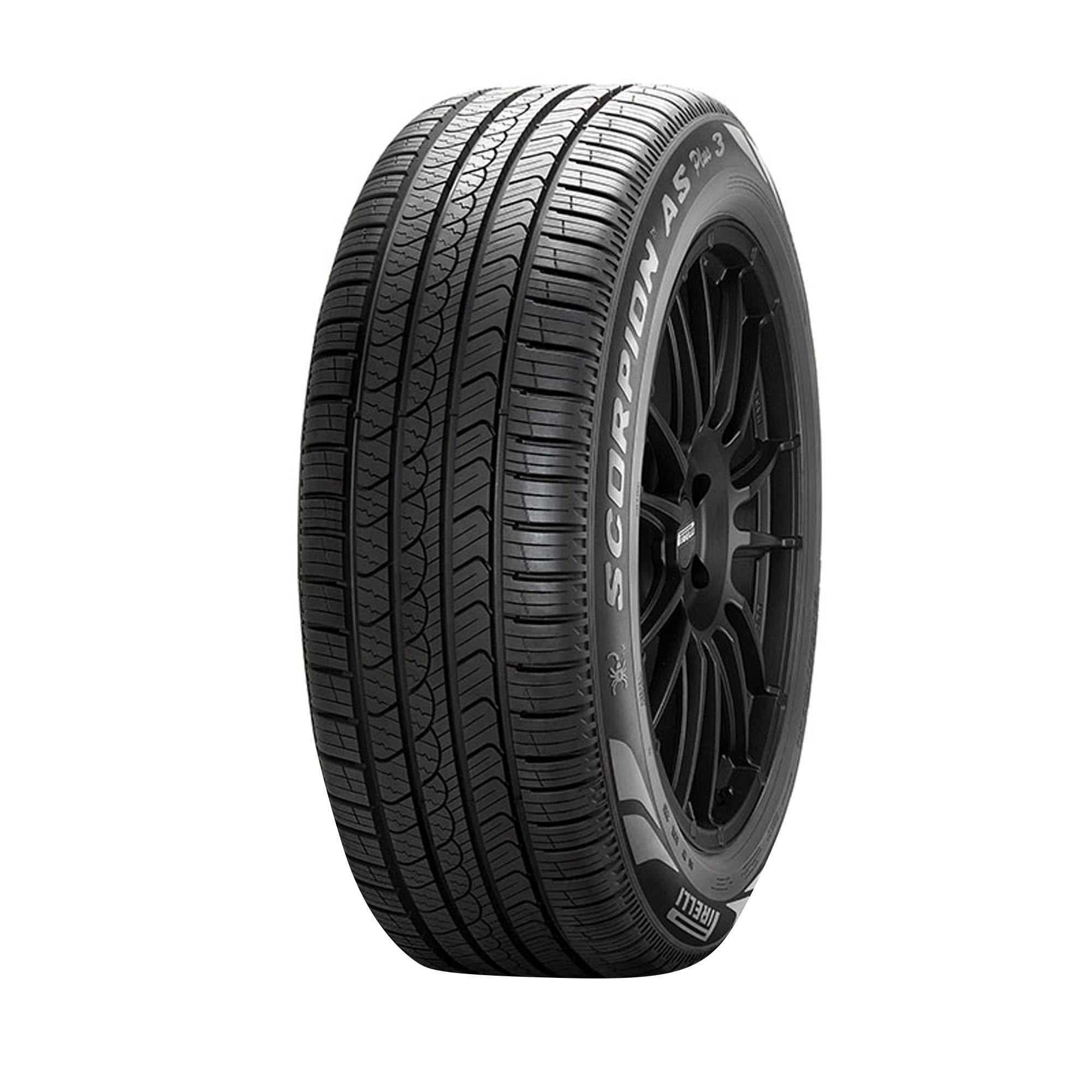

I too was looking for a replacement for my oem Toyo's that wore out way too soon. I was looking at the Conti LX25's, Michelin CC 2's and the Pirelli Scorpion AS plus 3's. Don't get me wrong, the Toyo's were a great performing tire but who wants to buy an expensive tire then have to replace it way to early. I compared the ratings of my other choices and the Pirelli Scorpion AS plus 3, which was a new model in 2021, came out on top. I bought mine at COSTCO (here in Canada). They tried to sell me the Michelin CC2's but I resisted and I'm glad I did, as my neighbor bought the CC2's and loved them for 8 months until they started to get REALLY noisy, so bad, that he returned them to COSTCO. I absolutely LOVE my Pirelli Scorpion AS plus 3's, so far.

Pirelli Scorpion AS Plus 3
