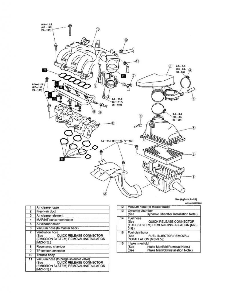

Procedure to Replace Spark Plugs
Removal of Intake Plenum:
1. Remove the air cleaner outlet pipe.
2. Disconnect the throttle body electrical connector.
3. Disconnect the evaporative emissions (EVAP) tube from the intake manifold.
4. Disconnect the brake booster vacuum hose from the intake manifold.
5. Disconnect the positive crankcase ventilation (PCV) tube from the PCV valve.
6. Disconnect the PCV fitting electrical connector.
7. Detach the wiring harness retainers from the upper intake manifold.
8. Remove the 2 upper intake manifold support bracket bolts.
9. Remove the 6 bolts and remove the upper intake manifold.
10. Remove and discard the gaskets.
Removal of Spark Plugs:
1. Disconnect the 6 ignition coil-on-plug electrical connectors.
NOTE: When removing the ignition coil-on-plugs, a slight twisting motion will break the seal and ease removal.
2. Remove the 6 bolts and the 6 ignition coil-on-plugs.
NOTICE: Only use hand tools when removing or installing the spark plugs or damage can occur to the cylinder head or spark plug.
NOTE: Use compressed air to remove any foreign material in the spark plug well before removing the spark plugs.
3. Remove the 6 spark plugs.
Installation of Spark Plugs:
1. Install the 6 spark plugs. Tighten to 15 Nm (133 lb-in).
NOTE: Apply a small amount of dielectric grease to the inside of the ignition coil-on-plug boots before attaching to the spark plugs.
2. Install the 6 ignition coil-on-plugs and the 6 bolts.
Tighten to 7 Nm (62 lb-in).
3. Connect the 6 ignition coil-on-plug electrical connectors.
Installation of Intake Plenum:
1. Using new gaskets (no need for adhesive, just make sure they are seated correctly), install the upper intake manifold and the 6 bolts.
2. Tighten in the sequence (Middle front, middle rear, passenger rear, passenger front, driver front, driver rear) to 10 Nm (89 lb-in).
3. Install the 2 upper intake manifold support bracket bolts. Tighten to 10 Nm (89 lb-in).
4. Attach the wiring harness retainers to the upper intake manifold.
5. Connect the PCV fitting electrical connector.
6. Connect the PCV tube to the PCV valve.
7. Connect the brake booster vacuum hose to the intake manifold.
8. Connect the EVAP tube to the intake manifold.
9. Connect the throttle body electrical connector.
10. Install the air cleaner outlet pipe.
Hope this helps you!

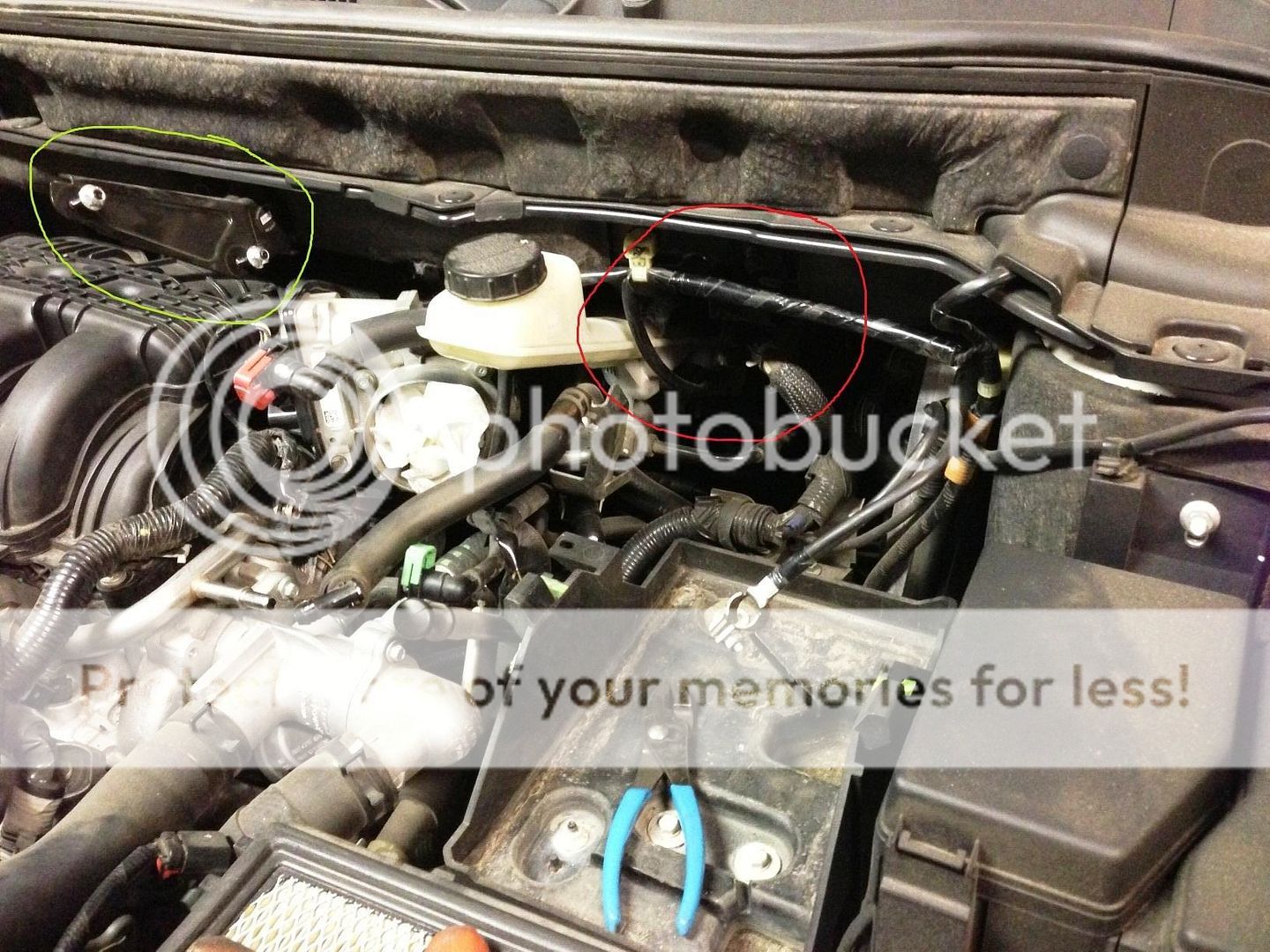

Thought I would add my experience here. Just did them on my 2008.
Thanks for the info thus far. It's helped me move through the job.
Here are my tips:

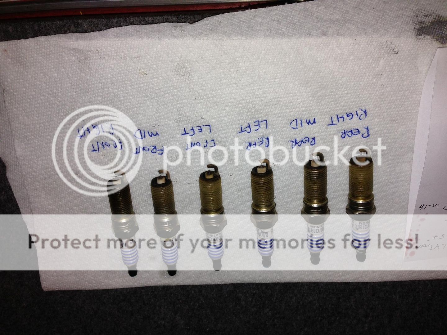

1. The Motorcraft plugs DO NOT COME PRE-GAPPED. You must gap them to .051" - .057". I used .055". DO NOT use the electrode tip to pry against.
2. My car had 80K on it and definitely needed the plugs changed. The gaps had eroded to about .070"
3. I have read that some say you can reuse the green gaskets. Mine looked good but compared to the new ones, they were not very flexible and felt "dry" and hard. These should be replaced.
4. This job is a bit of a PITA, buit with some clever hose removal, it's not so bad. BLOW the engine and crevices out with compressed air prior to diving in. Removing the plenum is fussy and hangs up on numerous things. This can knock debris into the intake runners.

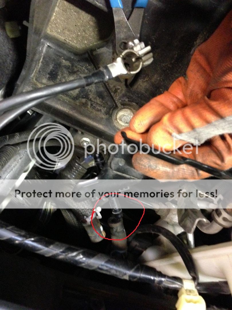

5. The two back hoses are the toughest. For the passenger side one, I waited until I had the plenum lifted off a bit and could get to it. I pulled it off from the valve cover end. Slight twist and off it comes. Right next to it is an electrical connector that is almost hidden. You can remove it "blind" if you try.
6. For the hose with the "fishnet" behind the throttle body, I traced it to behind the battery. I removed the battery and then removed the bracket shown (in red circles). Pretty easy. I could then get at the hose end there and fished it around and removed it with the plenum.
7. I needed to remove the valve directly above the throttle body for clearance (green circle).
8. The plenum is a tight fit but comes out straight towards you with a little fussing.
9. Be VERY careful not to drop anything into the intake runners. I placed a towel over them once I could.
10. I agree with the warning not to use power tools on the plugs themselves. This seems like an engine that is not very tolerant of brutality.
11. The coils were a bit stuck. I pried carefully from under and to the right of the screw mount hole to ensure I was prying against the full thickness of the bracket and they popped up with a little effort.
I can only imagine a careless mechanic doing this job. Small washer down the plenum or dirt/debris. It's also easy to lean on the air conditioning hose on the passenger side. Too much leaning and this thing is going to leak really soon. Easy to "break" the thin wires of the numerous electrical connectors. Each one of these will not manifest itself right away, but will almost certainly result in frustration and difficult troubleshooting to come- all without the culprit to blame and your time and money as the casualty. I strongly recommend participating in watching your mechanic do this job. If they mind, find a different mechanic. In all, took me about 2.5 hours, working steadily. 2 hours I suppose the second time around.
