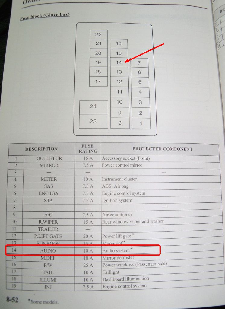

Hi guys,
hoping to save fellow members a trip to the stealership,
just happened today, my NAV button wouldn't respond at all (see video) , no matter how hard I pressed the button
removing and re-installing the GPS SD card did not help.
So I figured nothing to lose and try resetting the audio system by removing and
re-installing the 10 Amp "Audio" fuse located behind the glovebox
Low and behold, the GPS NAV button now works :
hopes this helps anyone else experiencing the same problem.
