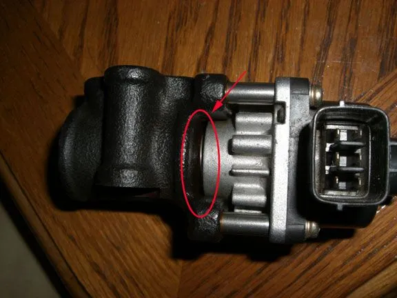

Anyone had problem with EGR leaking air? I hooked a smoke machine to the intake and saw that smoke are coming out from the EGR. It seem to be coming out by the shaft (the hole where the shaft go through) . Is it suppose to do that?
MY engine was burning lean, and that seems to be the place where air was leaking in.
That's the whole point of this thread being created. It gets gunked up and won't shut causing a vacuum leak...so you take it off and clean it!
I'm not talking about that the valve being stuck open. When I took mine off, the valve wasn't stuck at all. I am talking about the EGR leaking air even when the valve is fully closed. And that air is coming into the intake from outside of the EGR (from the engine bay), not from exhaust.
Gotcha...I haven't seen or heard this before but maybe some ultra copper permatex silicone on both sides of the cheesy gasket will help.
Here is the picture with the red marking showing where the leak was (smoke was coming out from there when I had the smoke machine hooked up). Theoretically it shouldn't allow any air through, since all the air needs to be accounted for by all the sensors. However, the design of this egr valve seems to be really crappy, so it almost seems like that they didn't really care about this issue (or maybe the amount of air coming through is negligible, I don't know).
