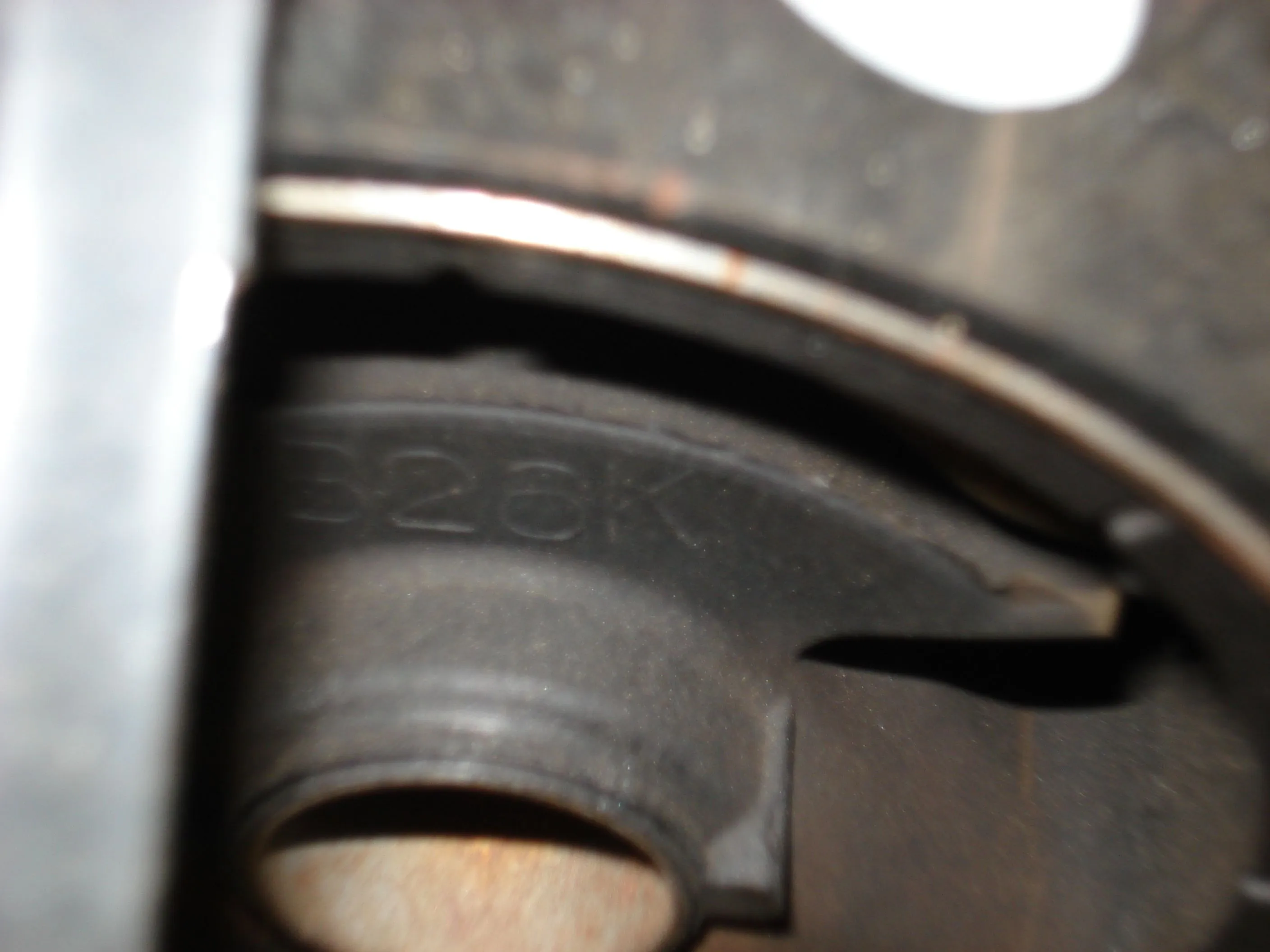

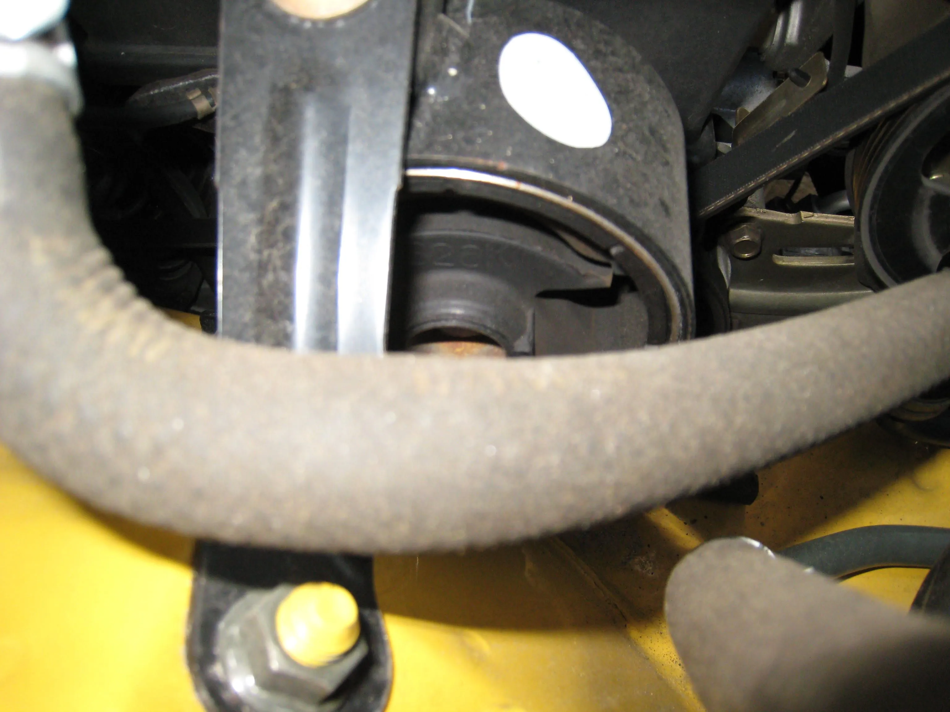

i thought it mite have been. anyone else agree the side is torn? not sure what a good one looks like....

That's what mine looked like (on both sides of that mount), and I know that is what Rob's (liquid_ag) looked like too from what he told me. I think that is as torn as those mounts can get, there's no way in hell you could ever tear the big chunk of rubber at the bottom of the mount.
but aren't those made so they dont connect at the top?
SLS only has one side mount dont they...is it passenger side? would that cause the extra vibration or is it something else? maybe it's just the header doing it? it's not like the car is about to rattle apart, i can just feel it in the floorboard now and the shifter vibrates slightly more.
