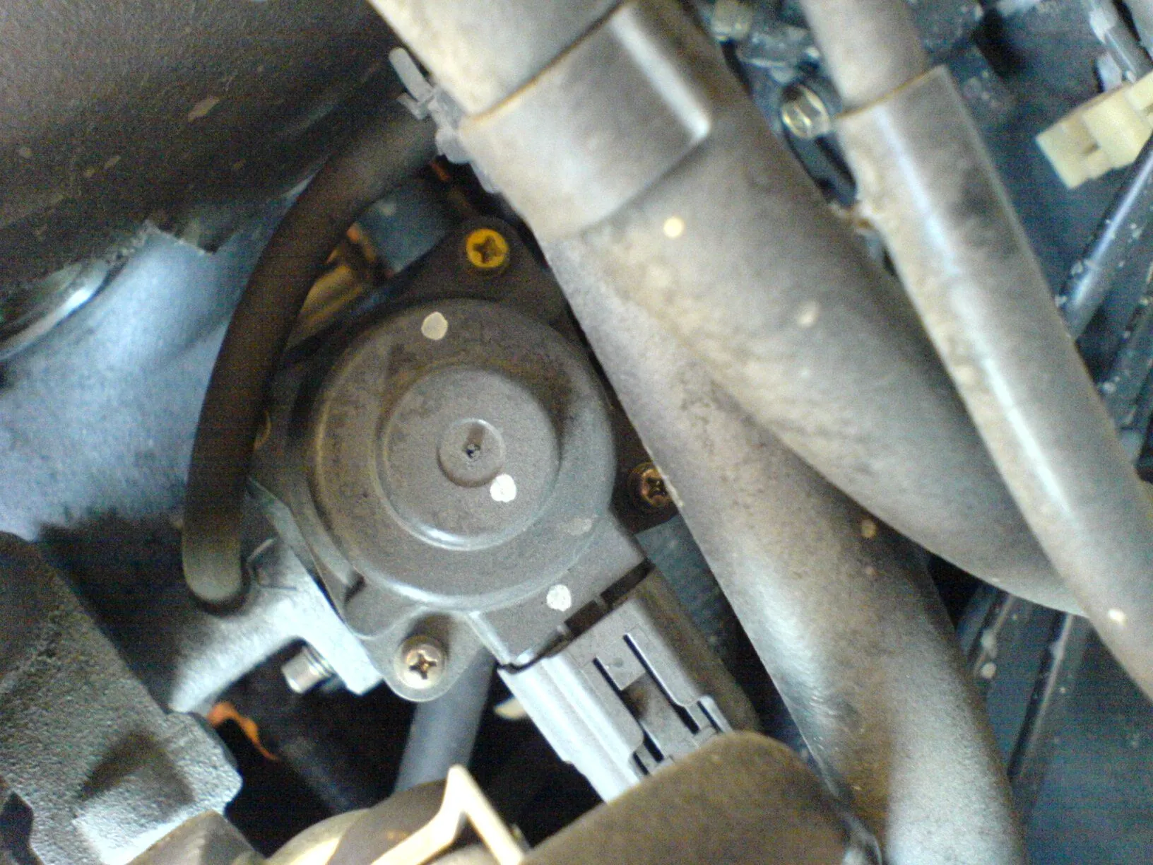

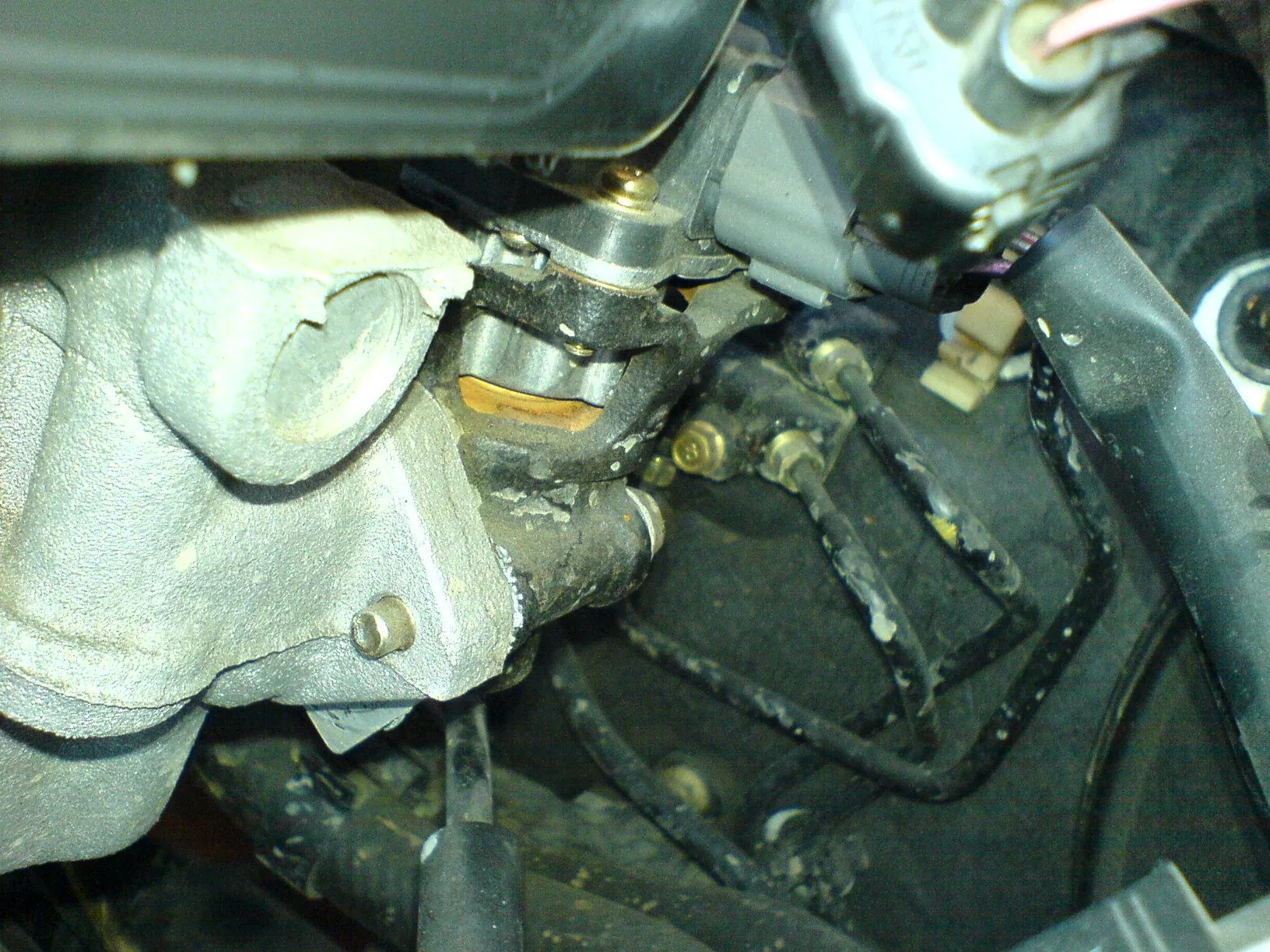

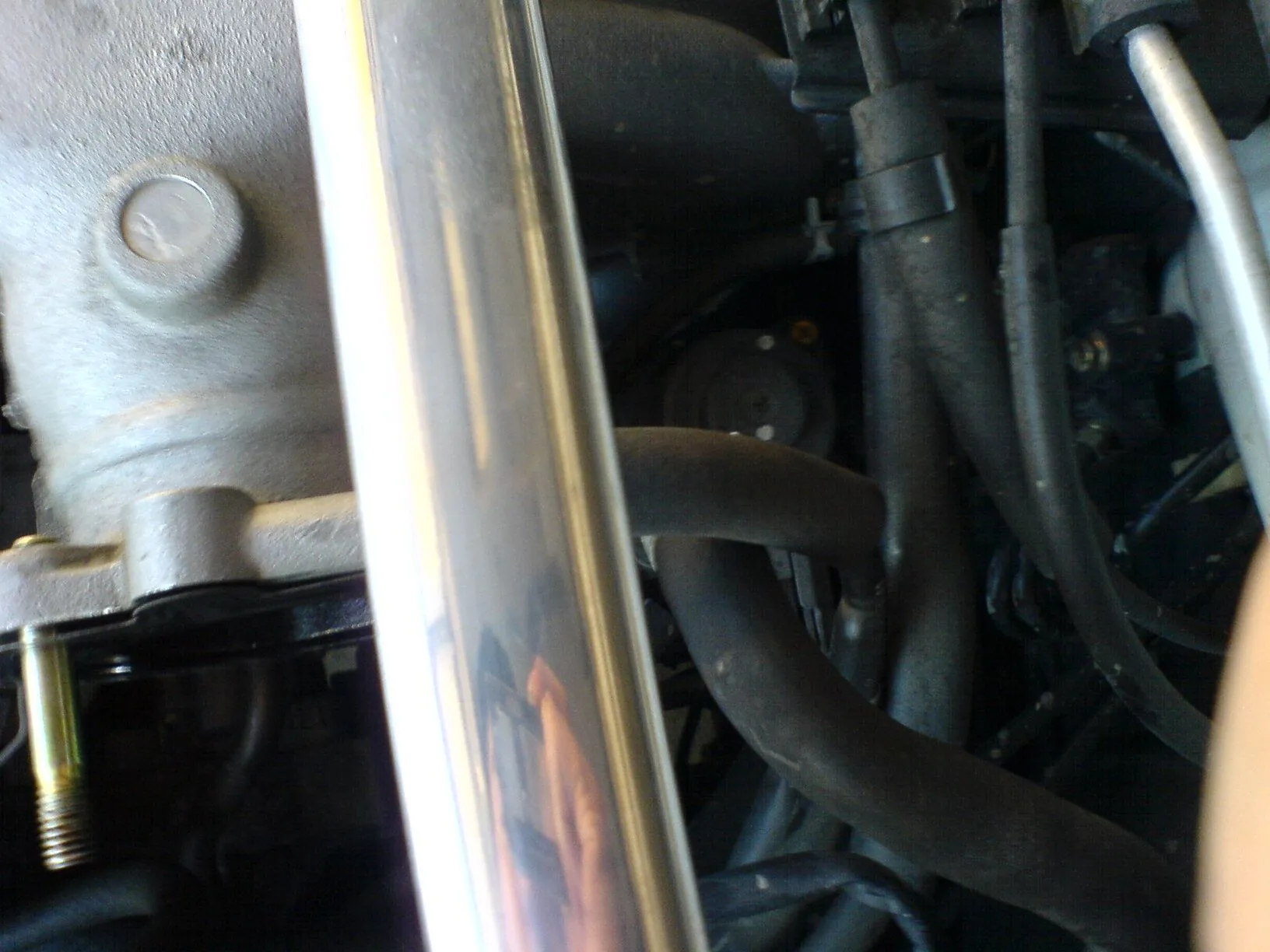

Anyway, I have a 1.6L ZM-DE engine and I took a couple pictures to help other 1.6's find and clean their car. Sorry about the quality. These pics are from my cell phone, but I am hoping they should still help a little.
TIPS AND PICS FOR 1.6L Proteges with ZM-DE engines!
DSC00168.JPG - removing the intake throttle body will help a lot. This involves removing 4 screws and two connectors. EGR in far upper right.
DSC00169.JPG - can you find the EGR? It's hidden just a little to the upper right of the center of the photo.
DSC00170.JPG - closeup picture of the EGR. You can see the 4 screws you will have to take apart later. Also shows the connector.
DSC00171.JPG - view from the same height as the EGR. You can see one of the bolts you have to take apart and the gasket sticking out the bottom. Don't let the gasket slip away from you!
Good luck!
