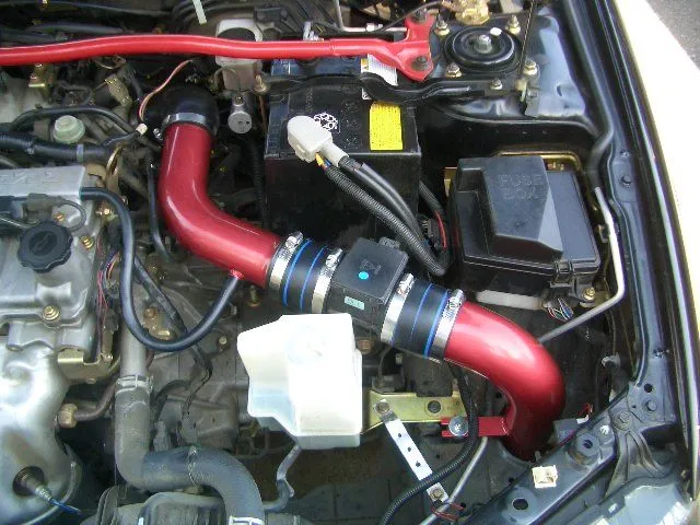

eBay CAI installed
Here's a thumb of my intake i bought off of ebay from liveonspeed.
Looks good, that's the same one I got. (See website)
Interesting thing you did with the couplers, what is that, electrical tape? If it is, you better watch it, the heat from your engine may make it start to shrink or curl.
Did you get the filter to stop hitting the bumper supports?

when ur putting in the intake how do u get it around the coolant container? is there a way to move it?

yeah, the tape's already shrunk, so now i have blue and black striped couplers!!!! I bet nobody else has any of those!!!! As for the filter, it don't hit as long as i keep the rpm's up when releasing the clutch (you know how the engine vibrates sometimes when you let the clutch out too slow @ lower rpm's) as long as i don't do that it doesn't hit. but still, i'm gonna adjust it, cause i have to take the tape off, anyhow, so i'll adjust it then.
yeah, if you look @ the pic about 4 posts down, you'll notice the coolant reservoir has been moved from it's original position. all you have to do is remove the container, rotate the bracket 180 degrees, and bolt it into the hole closest to the wheel-well. the problem i had with this is that both the bracket AND hole are threaded, and this won't allow you to tighten down enough to keep the bracket from swinging around. so I took a metal strip with holes in it, and used it as a supplemental brace. you can see in the pic, also, it's the silver piece. once you've done that, the opening's free to receive the intake piping.

well today was a pretty bad day for intake installing. I went to put in my intake today and all was goin fine til i got to the air sensor. Never wouldve thought those screws were in there so tight. so yea i stripped them and now im kinda stuck. Anyone know of any good ways to get a stripped screw out? oh by the way, Memo79 thanks for the info on the coolant tank, but what did u do about that little steel bar (not sure that it is) that goes directly over the hole? did u just turn it or somethin?
