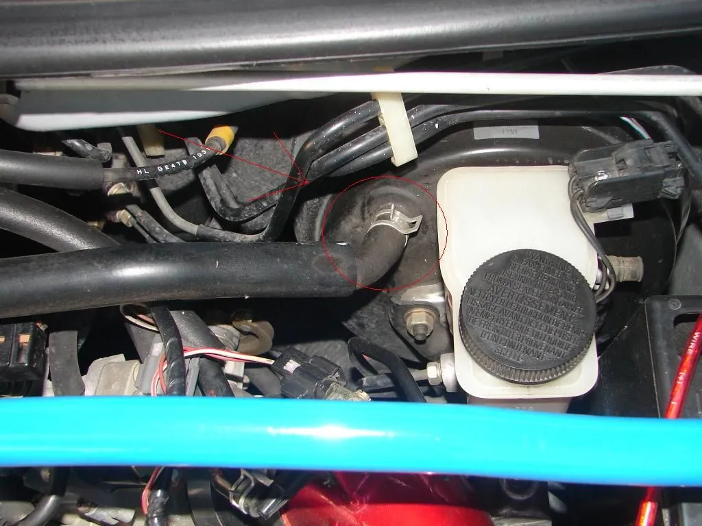

Is this the brake booster line? I need to make sure so I don't f it up...
dont worry if the car is kinda starting up for the first time... its nomral... Whatever you do make sure you hooked up the brake line back up before you go for a drive.
could someone post a pic of the pcv line, i am new to actually working on cars and of course chilton's doesnt make a manual for our cars much less any protege after 2000. I am going to seafom and was told since i have the msp to use the pcv line instead of the brake booster line.
I did mine off the brake booster line. The car could barely idle with it off. It made a huge difference on idle and the powerband. The brakes felt a little spongy for the first minute or so after reconnecting the line. I suggest two people do it, so one can modulate throttle, around 1500-2000rpm to get smooth coverage while the other uses the hose to suck up the seafoam. After that I shut the car off for 5 minutes, then fired it up and got no smoke at first, then I goosed the throttle to smoke out the neighbors, so I went for a little drive away from the house lol.
We did this about six months ago, and actually used this write up because I couldn't find a better location closest to the TB that would allow the seafoam to hit all four cylinders evenly. I basically wanted to see if others used the brake booster line like I wanted to. Only took like 6 months for me to actually join the bopard and start posting haha.
