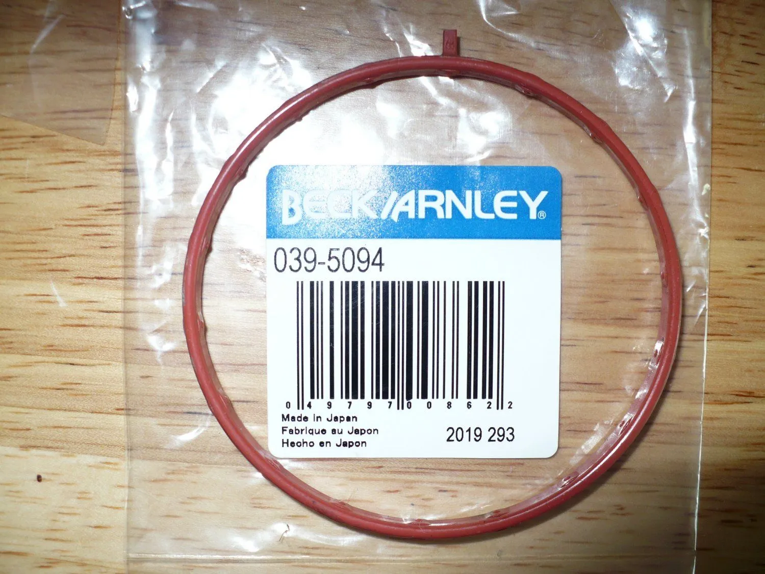

Thought I'd add to this (kinda old) thread. Today, with the aid of felixd's video above (great job felixd), I cleaned the throttle body at 45,515 miles. It had a ring of black gunk on both sides of the throttle plate (butterfly) and took a bit of scrubbing with solvent and stiff bristled brush.
As for the gasket, I can confirm that the Beck-Arnley # 039-5094 is identical to the OEM Mazda gasket P/N PE01-13-655. After seeing prices of around $20 for this little gasket, I got this gasket from ROCKAUTO for $6.61 delivered (half of the cost was for postage - the gasket was about 3.25).
Edited to add Mazda P/N PE01-13-655
