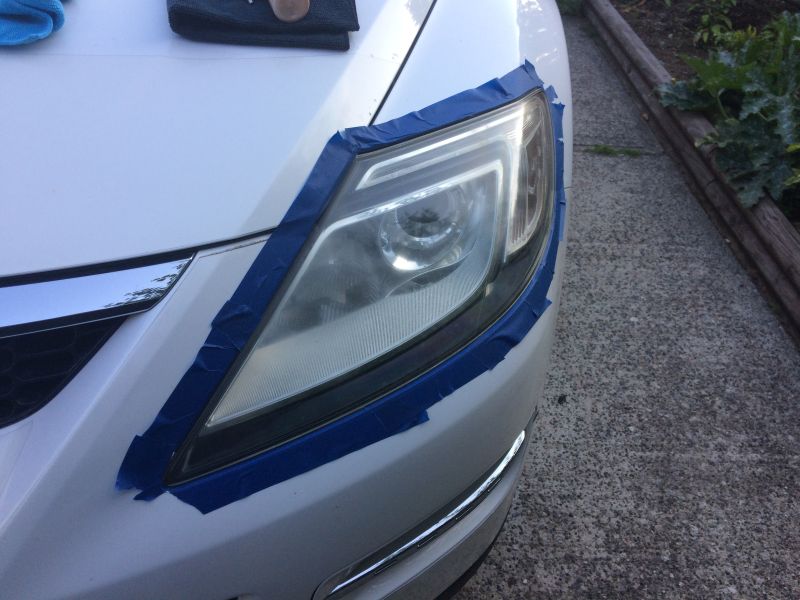

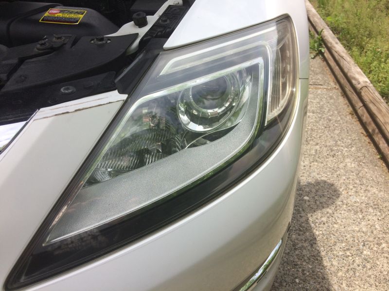

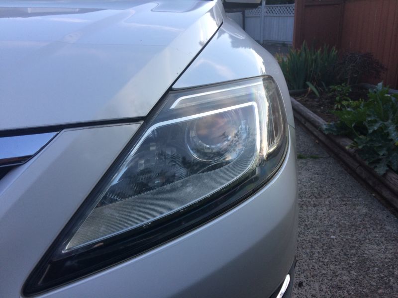

Update.... I polished my headlights back in July 2019 with a Surf City Garage kit. The past few months I've noticed them hazing over again, so today I gave them a good polish with the foam wheel from an old 3M kit, and some Mequiars plastic polish (both were laying around the house). They polished up really nice. I then put two coats of Mequiars car wax on them; will see if that helps keep them haze free for a bit longer that with no wax or anything.
Here is before and after:
