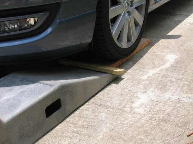

How to make the Rhino Ramps work with the MS3
My car would not clear the ramps without using the 2x6's. I have a 45 degree angle cut on the front edge. I've added a 1x4 turned sideways so that the tire doesn't drop down when it goes off the end of the 2x6's and onto the ramp. This setup works great & makes changing the oil & filter a breeze.

Or you could just buy the correct Rhino ramps. They make two models, the other one works without any lumber.

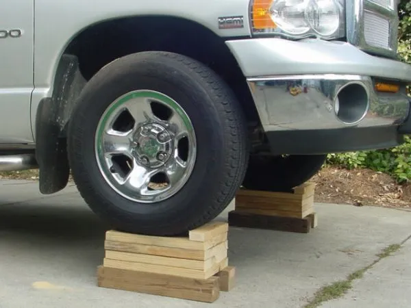

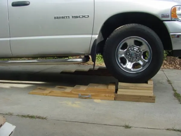

I built these a year or so ago... I use 'em on my Ram, 300C, and the MS3.
hilmark, I'm not sure but isn't the width the only difference between the two ramps? What year is your speed3? Mine is 2008. Could it be that the front end is different on our two cars so that you might not have a clearance problem with either ramp?
Mine is also an '08.
The angle of the ramp is also different, which is why it won't go up the heavier duty version (steeper angle on that one).
