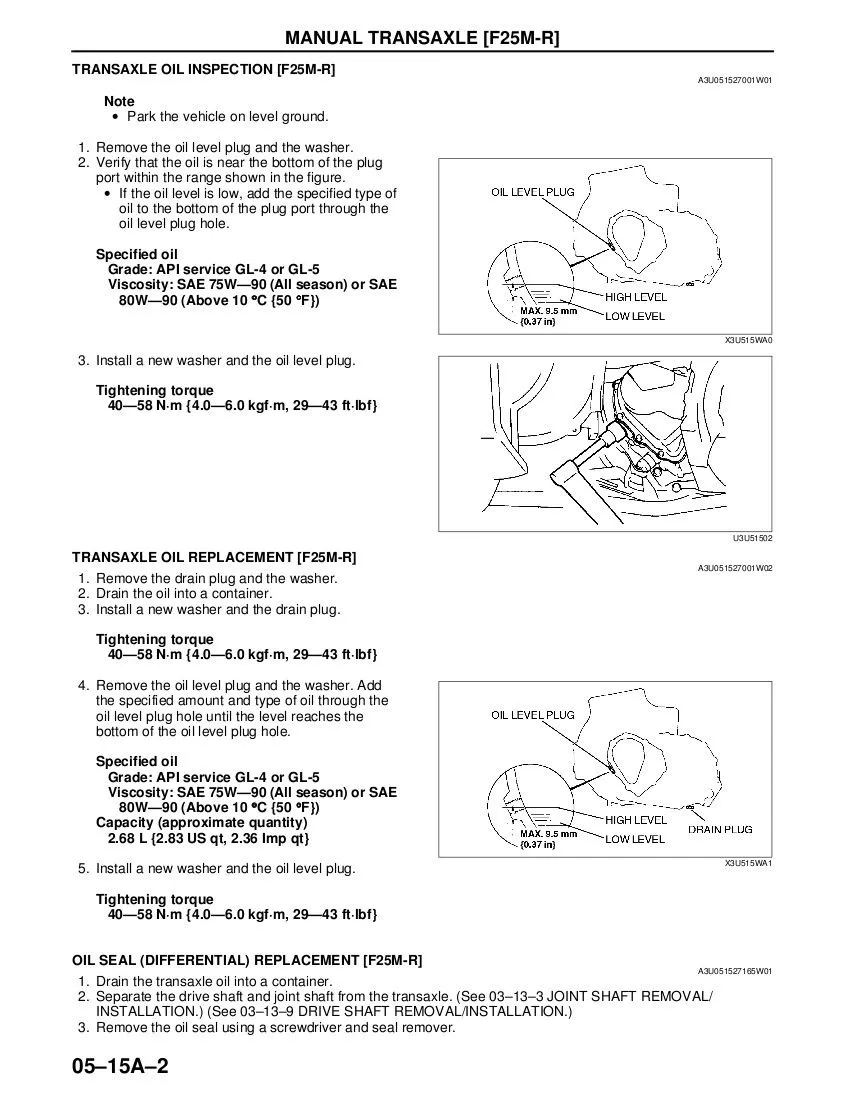

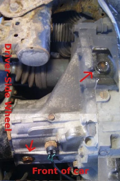

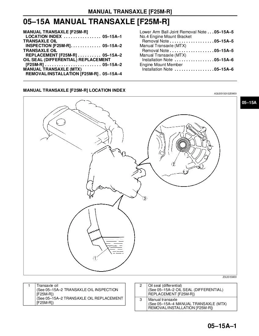

See pages 05–15A–1 and 05–15A–2 of the service manual for help locating the drain and fill bolts. They are attached for your convenience as well as a picture from the underside of my car.
Thanks to all the guys who helped me in my original thread.

which screw is the drain plug? lol stupid question i know but just curious cause im about to see if this works a little on my gears sticking. I took my car to jiffy lube and they told me i should replace my rear main seal. not sure if i should pull the tranny apart..
The bolt on the bottom. (lol2) The one on the top right of the last pic.

Sorry if this is a newb question, but where the hell is the fill bolt? Can someone take a pic?
