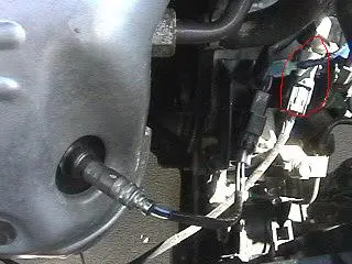

-Pop Open the Hood and get a look at the 2nd Oxygen Sensor
-There is a clip..Push the clip in and pull out the Male-Female Connection
-Using Adjustable Wrench Remove the Oxygen Sensor

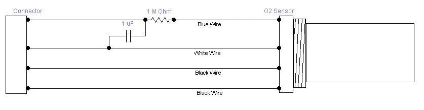

-Go somewhere you can use your Soldering Iron
-Cut the Blue Wire
-Remove the Sheathing on the White wire to expose the Copper Wiring Underneath
-Grab you 1m Ohm resistor and solder it into the bluewires you cut earlier
-Grap your 1uF capactiro and solder it into the wire that you unsheathed/exposed & than solder it on the connector side as show on the Pic!
-Grab your electrical tape and make sure you do a good job covering all the conections
