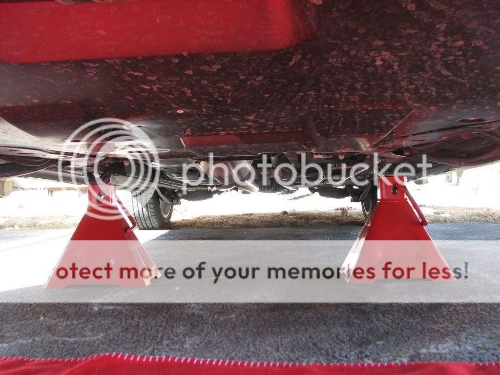

I started off by using the floor jack to raise the car using the front jacking point here...
Once I got it up in the air, I placed a jack stand under each frame rail and lowered the car slowly onto the stands. On my car at least, it seems the front of the frame rails are coated with a rubber-like undercoating which makes them sit on the jackstands without sliding.

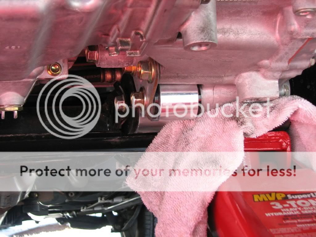

You can see the mount in the middle of the picture. Also take note of the flat area of the block to the immediate right of the stock mount. This is the key to making lining up the holes easier when you are installing the new one. If you use your floor jack to support that area as close to the mount as you can get without interfering with its removal, it makes removing the bolts easier as well as lining up the hole when you reinstall the bolts through the new mount. The trick is to jack up until you just feel pressure on the jack, then jack it up just a hair from that point so it takes tension off the bolts. If you jack it up too much, you will actually put more tension on the bolts. Here's how I did mine. I threw a towel on the jack cup just so the cup wouldn't do anything to the softer aluminum block, but this is probably not needed if you are careful.

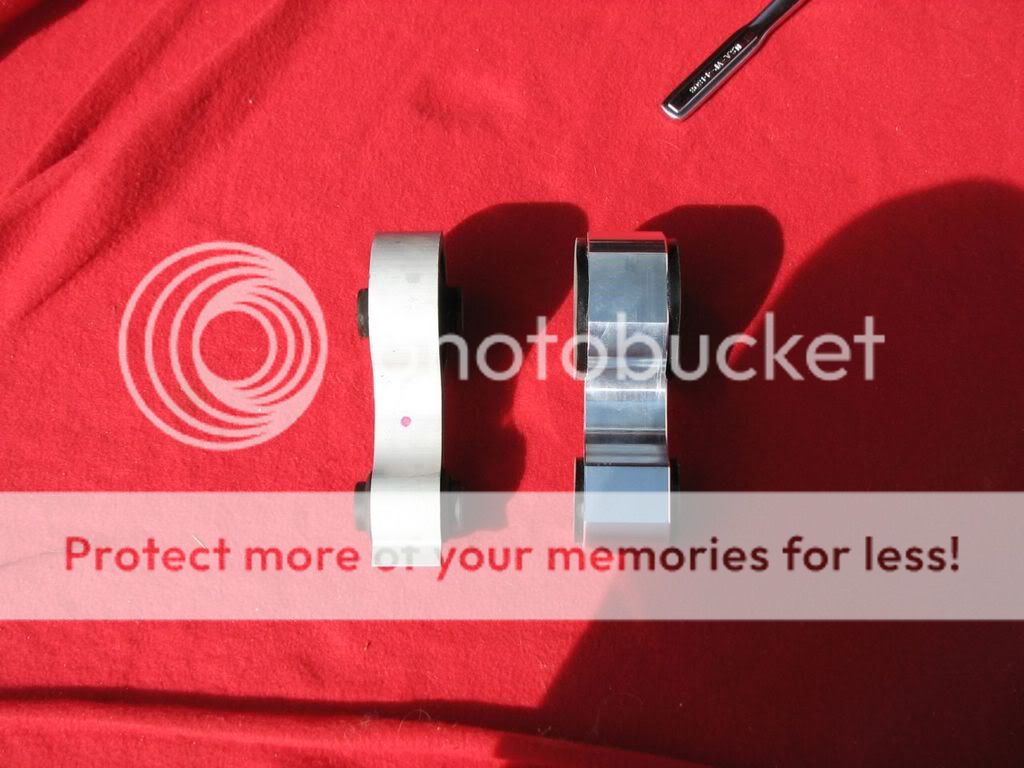

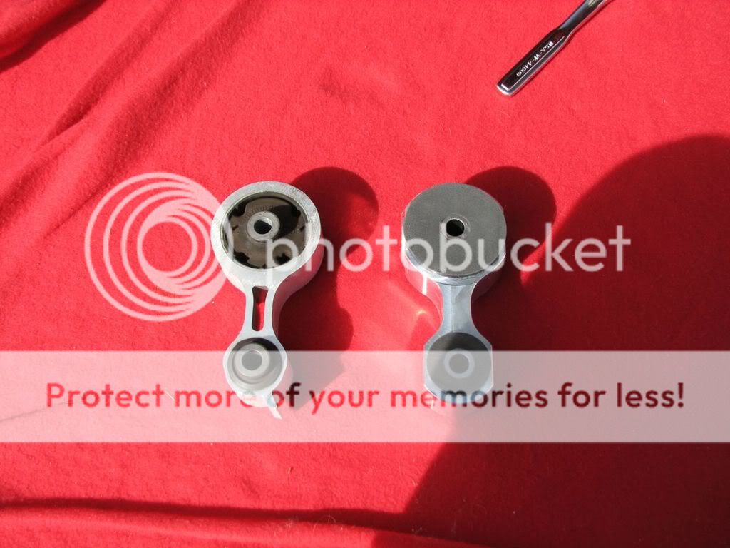

Now, you pretty much just need to remove the two 17mm bolts and pull the old mount out. You need to take the gold colored one out at the bottom of the triangle bracket that goes through the smaller end of the mount into the block. You also need to take out the silver colored on larger side of the mount going through the frame. You do not need to do anything with the two upper bolts on the triangle bracket. Once you get the stocker out of the car, you'll see just how flimsy it is compared to the new piece..
NOTE - If you purchased the AWR you will NEED to do the following, on the inside of the upper black bracket are L shaped tabs. These will need to be removed or bent back. I used a pair of needle-nose pliers to break the tabs away from the brackets, then just bent them back out of the way.
Now, the install is pretty much the reverse of removing. The first thing you need to do is grease up the sides of the rubber bushing in the new mount. This will help things slide in there easier because it will be a tight fit. You can see from the above pictures the SU mount is thicker, and the fact that the bushing has a "face" that adds some thickness as well makes it an even tighter fit. Some people have had to bend out the tabs that the larger end goes in between, but I didn't have to do that. It was a tight fit, but with the oil on the bushing, it slid right in. If you need to you can probably use something to bend those out a little to give you more clearance. Once you get the larger end in, hand tighten the bolt about half way in.

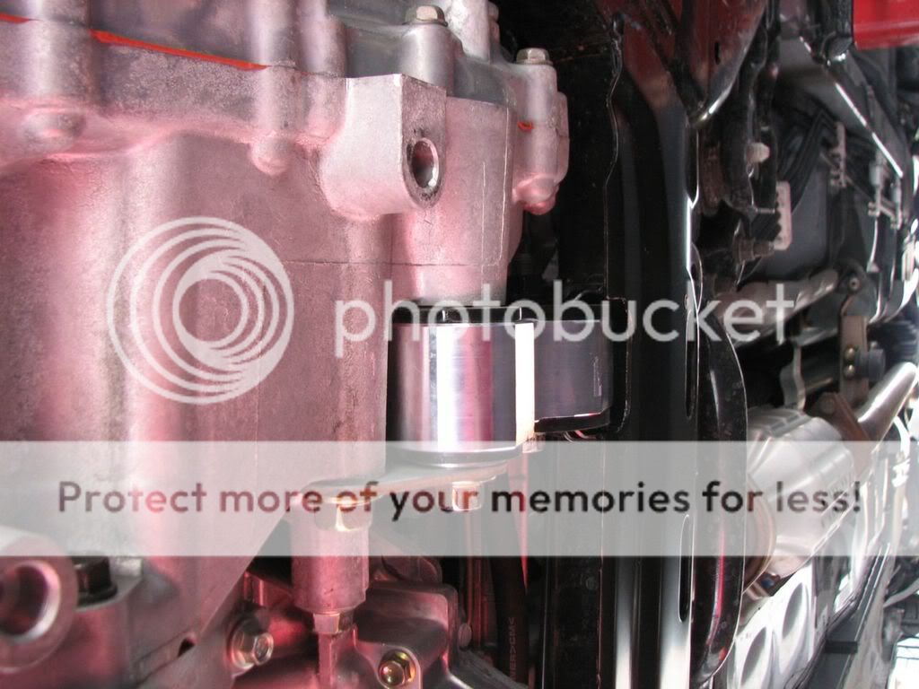

Now comes the tricky part, but it really wasn't bad at all with the jack supporting the motor. You need to slide the smaller end into it's spot, and make sure to get the washer in there as well. It's a really tight fit with the washer, but keep at it. I actually found the towel on the jack helped because I could cover the mount with that and tap it up with my hammer. Once I got it in there, I found the bolt would go all the way through, but the hole in the block was just slightly out of alignment because I had tapped the mount up to far. I backed out the bolt and used a punch thing I had to line up the holes, and re-installed the bolt. It threaded in fine. I never had to mess with trying to hold the motor in place and feed the bolt through. By supporting it with the jack, you make it a lot easier on yourself.
NOTE - once again on the AWR, the engine side of mine DID NOT fit. no matter how hard I tried, the metal ends of the mount just would NOT clear the bracket. this was easily fixed with my dremel, i just shaved about 1-2 MM off the end and it went in without much of a fight.

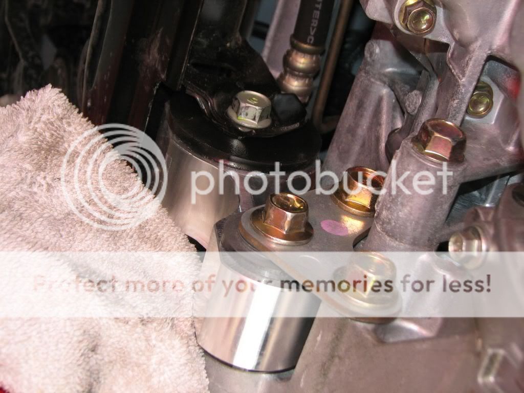

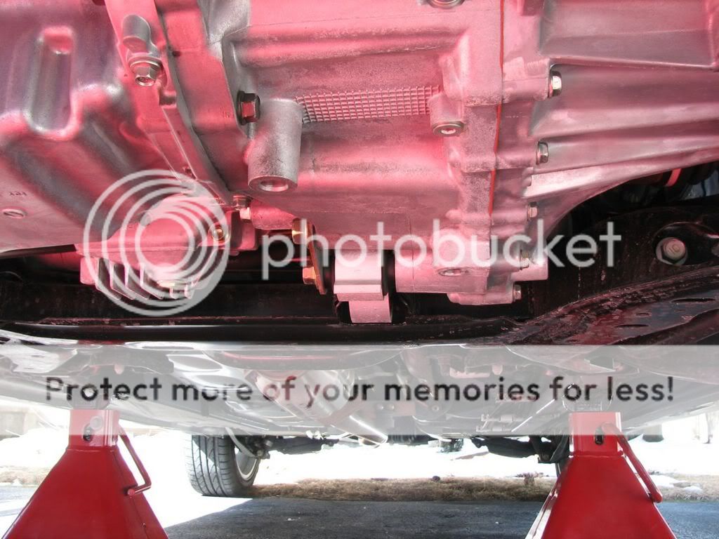

After I got everything tightened up it looked like this on my back...
It looked like this with me looking at it normally...
One more installed pic...
I put the car down and went for a test drive. The difference is night and day. There is no more shift thump, and when you shift under power from a stop, it's much, much smoother. I also adjusted the clutch on Saturday, and between the two, this is like a whole new car. I have noticed a tiny bit more vibration at idle, but nothing that will bother me. I'll keep an eye on it and see if it goes away once it breaks in and we get some warmer weather. The whole job probably took me an hour including getting everything outside, jacking up the car, and taking some pictures along the way.

I'm a little confused. You said that you purchased and installed the AWR mount but isn't that the SU mount in your install pictures? Sorry if I missed something. Also, do you have to bend the tabs out of the way with the SU mount?
I bent the one tab out of the way but easily bent it back when I wrenched the bolt back in.
see the first post ;)
