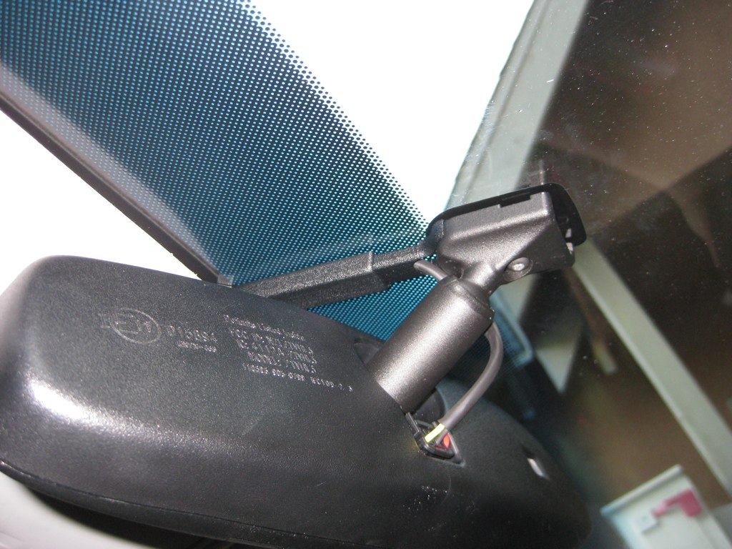

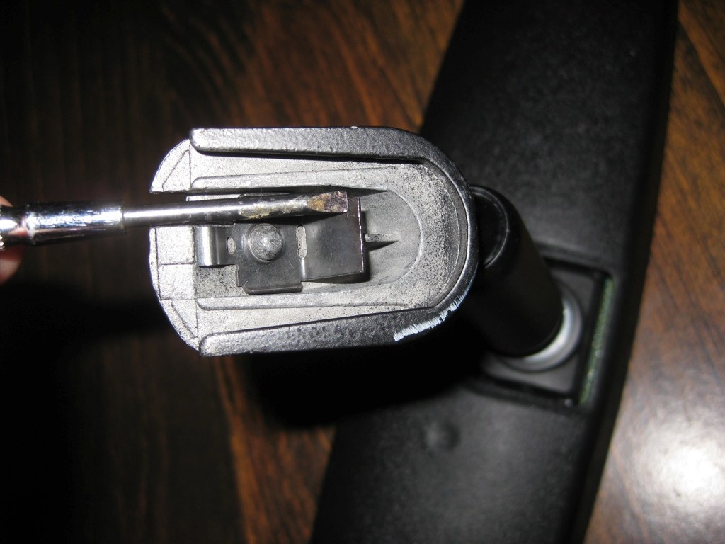

1) Remove the old mirror. Take a long, thin screwdriver (like a jeweler's screwdriver) and push it into the small notch in the bottom of the rear view mirror. As you push, the spring clip will be released; pull the mirror carefully toward the headliner and it will slide off. The picture shows the inside of the mirror when you do this.

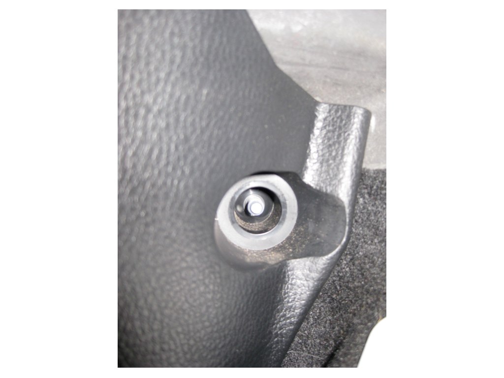

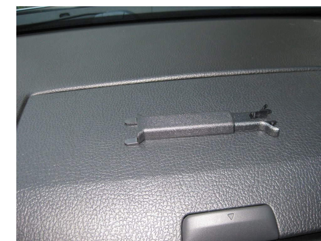

2) Remove the left A pillar plastic cover. There are two tabs in the middle of the cover; pull it outwards to release them. Then, slide the cover up towards the headliner, off of the square button; eventually it will slide up and away. Step 7 has a picture of the inside of the A pillar, refer to it for this step. Pull the cover out and set it aside.

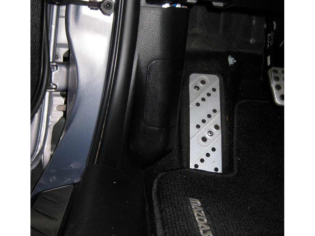

3) Remove the driver door kick plate. Release the clips on each end by pulling up towards the interior, then pull the entire kick plate up (under the metal works best) to release the three clips.

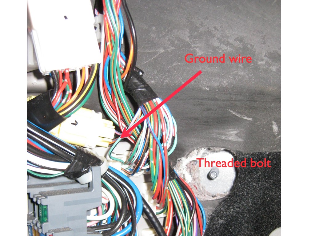

4) Remove the fuse box cover by opening the fuse box and pulling towards the center of the car. The front pin will release; a threaded bolt at the back corner takes some effort the first time to pull out but eventually it will come loose as well. Use a flashlight to see it and figure the best way to pull it off.

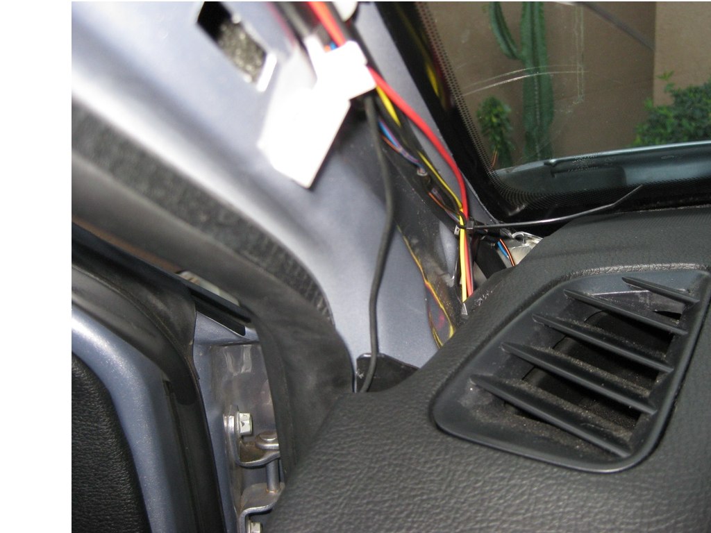

6) Plug the wire harness included with the mirror into the back of the mirror. Run it straight up to the headliner, and tuck it along the inside of the headliner to the driver's side A pillar.

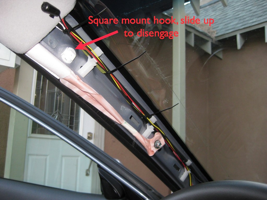

7) Run the wires along the A pillar as shown (the wires zip tied are for the mirror, my Bluetooth mic is the thing at the top left). Zip tie them in place, but be careful not to tie around the rubber hose.

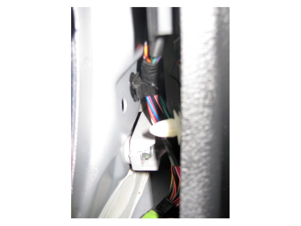

Thread the wires down into the hole at the base of the A pillar; this leads behind the dash, so look up from below and pull the wires all the way down.
8) Once the wires are zip tied in place, you can reinstall the A pillar cover by first sliding it onto the top square hook and then snap it into place (it won't feel that solid, compare it to the passenger's side cover to be sure you have it down). Unplug the mirror at this point, so you don't cause any problems while you are wiring it up.

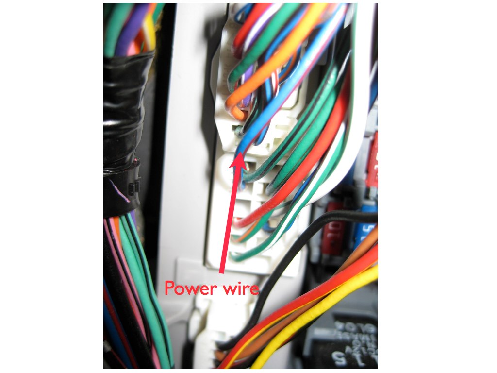

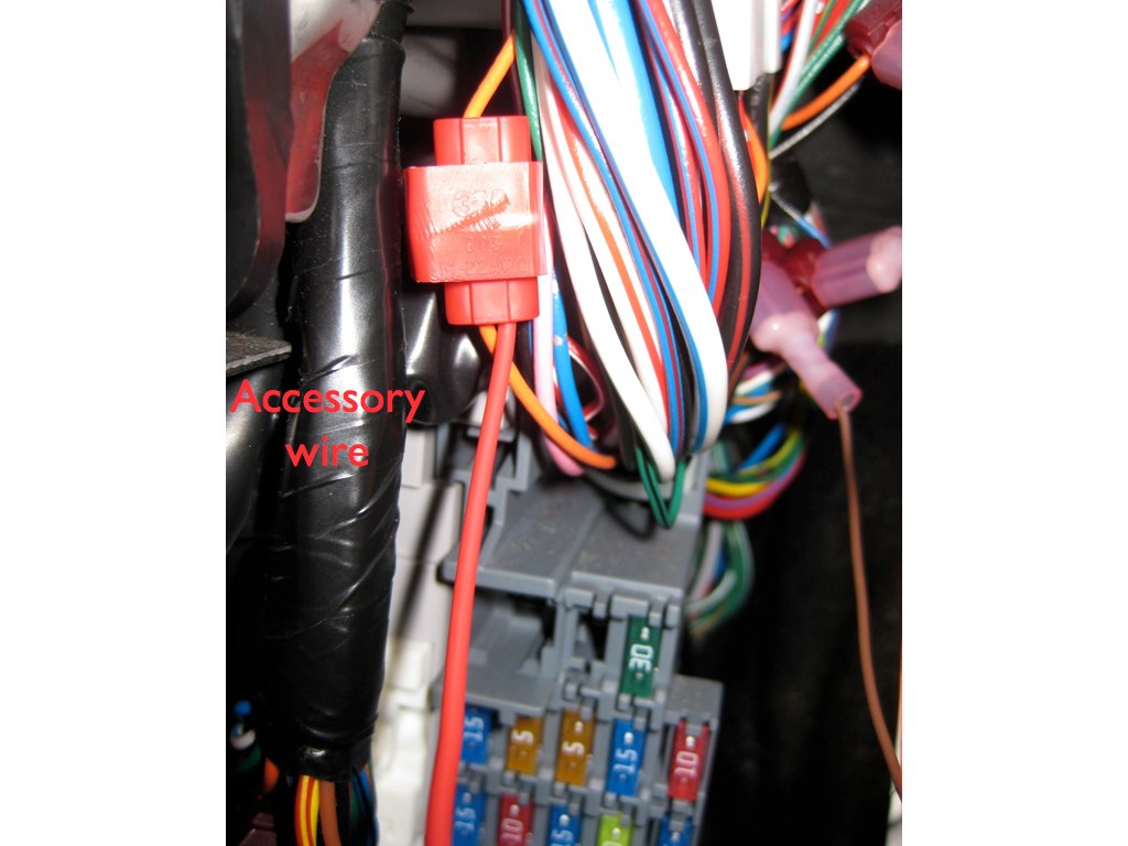

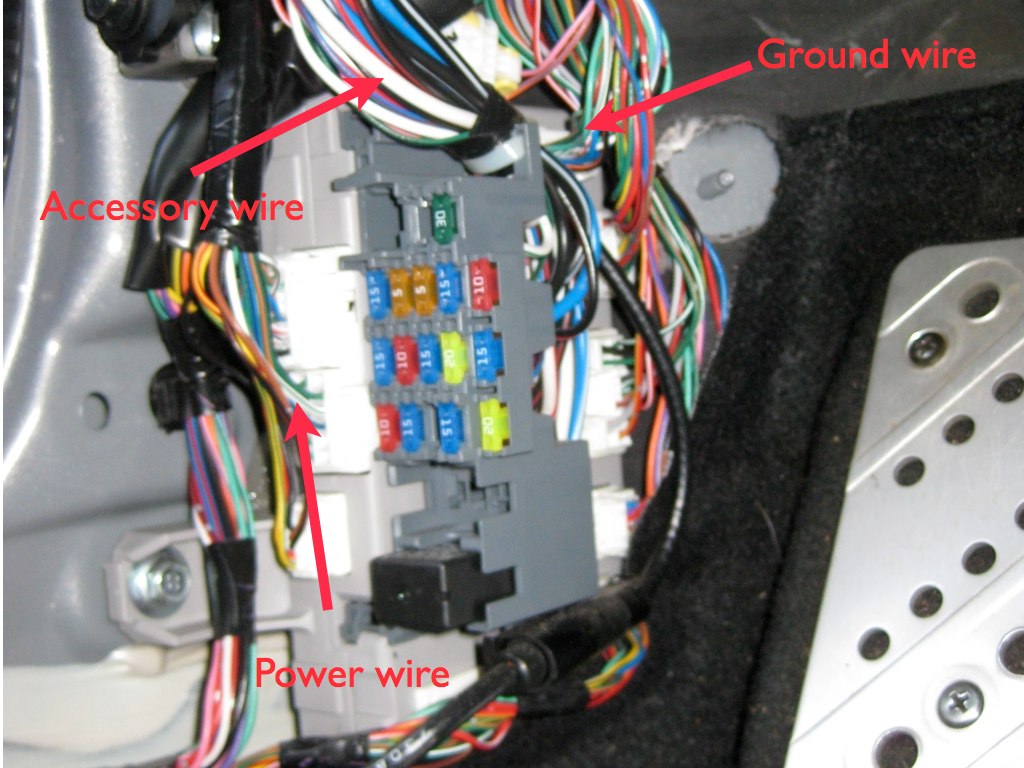

9) The Homelink mirror comes with three wires, one for accessory power, one for ignition power and one for ground. The red wire goes to accessory; connect this to the orange wire in the wire bundle at the top of the fuse box.
You may have to dig to find the orange wire, it is hidden within all the otter wires. Carefully pull it out, and use a wire tap to connect the red mirror wire to the orange wire.
10) The yellow wire goes to power when the ignition is on; if this wire is powered all the time it will drain your battery. There are several wires you can tap into, I used one I already tapped for the shock sensor. This is the blue/red wire in the middle left plug, right to the left of the fuses.
11) The black wire goes to ground; this is apparently a standard green/black wire seen in many spots. There is a green/black wire next to the wire tapped in step 10, you can try it, but I used the wire in the pictures since I had already tapped it before. That wire is in the top plug at the back of the fuse box.

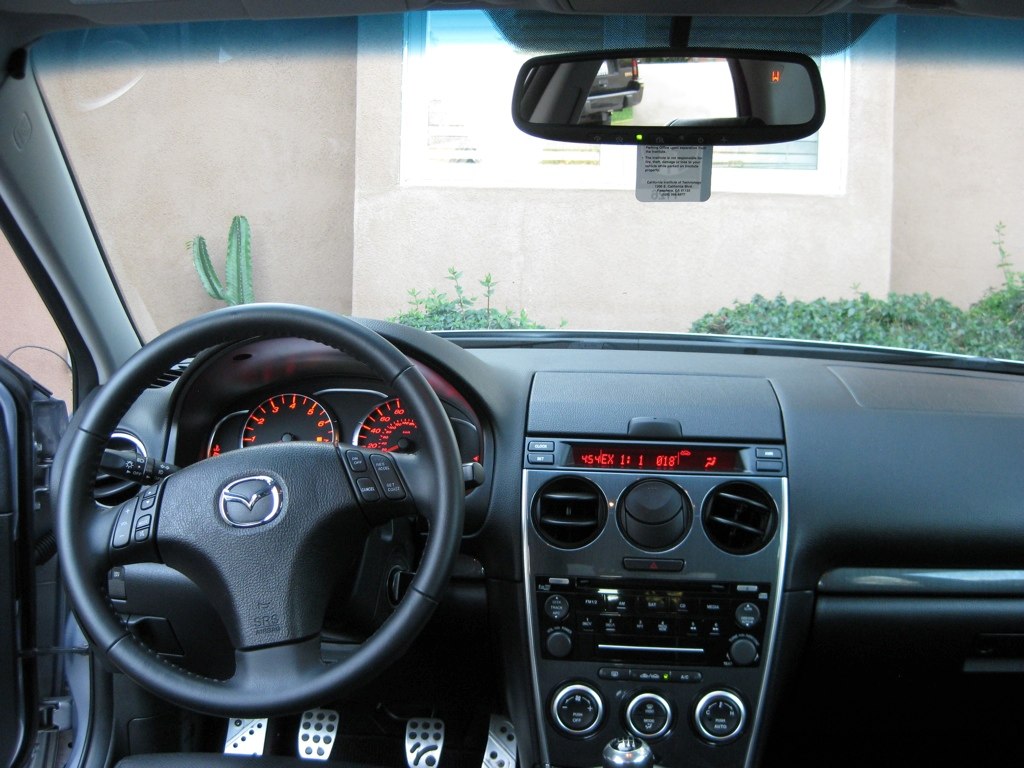

In the pictures, you can see that the mirror glass in my mirror doesn't have a box around the display. The guy who set this up for me put the glass on that way. The advantage is that you don't have the box cutting out a part of the reflection, which I liked. The drawback is that it's harder to see the display in daylight, and the display is also polarized so if you wear polarized sunglasses it can disappear (tilt your head to make it reappear). If you want to see the direction at all times, get the display with the box.
The color is an amber color; it's not a perfect match to our lighting, it's a bit too orange. Red is probably a better match if you can get it, but the amber works well I think.
A better alternative to the Jeweller's Screwdriver would be to use a small sized allen key and poke the long edge into the hole, that way you don't have to worry about scratching the windows tint. I learnt that the hard way then i used a screw driver. I would also be easier to manuever an allen key due to it's "L" shape than a straight screwdriver at such steep angle.
Yep, that should work as well, as long as your Allen key is small enough to fit int he hole and stiff enough to push the spring without bending. I didn't have a problem getting up there with the screw driver...the biggest problem is that there isn't any feedback when you push on it if it's enough, and in my case the mirror was a bit sticky and wouldn't move until I gave it some real force.

Hey Folks, I bought a 2009 Mazda 6 GT v6 version just yesterday.The rearview mirror light doesn't come on.It doesn't do any auto dimming. I checked the fuses,But they are good.Need your help guys.Thanks in advance.
As the pic shows, pull the left side kick panel and check the connections (power/ground).
There are two power lines (switched-for auto-dimming, and constant-for garage opener).
If not, the unit could be broken.
