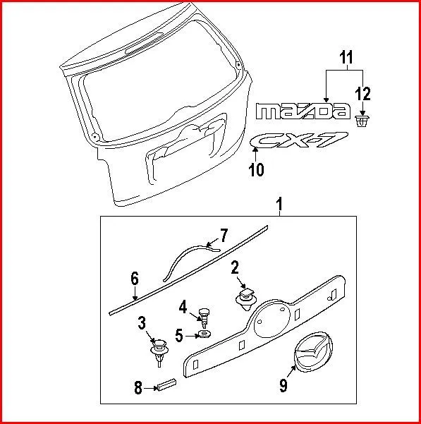

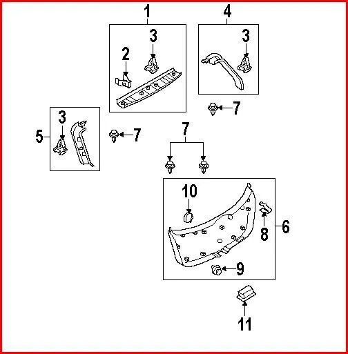

My mazda badge on the trunk door is broke off flush with the body. I need to get the inside panel off to access the 3 holes where the broken plastic pins go in to push them out. Does anyone know or have a diagram of how to get the door panel off?
Thx.
These are not that detailed, however they may help.(uhm)

Start by taking the top pieces of the inside and work your way down easyyyyyyy
