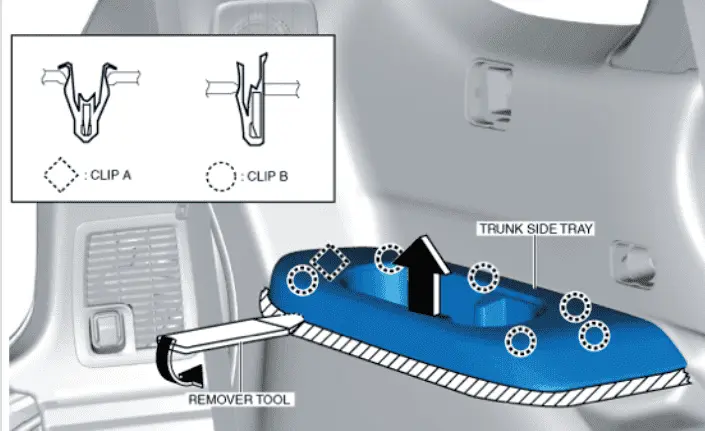

Can anyone tell me how to get to the upper rear shock mount on my 2016 CX-9? I'm still trying to find the elusive source of a squeak. It goes away for a few minutes after I remove and replace the wheel. I can squeak it bouncing on the open rear hatch, but when I have a jack under the suspension with the wheel off, it'll bounce silently.
Also, I am not quite sure, but you may be able to access the shock mount by removing the side tray (the third row cupholder) ? It is held in by clips.
