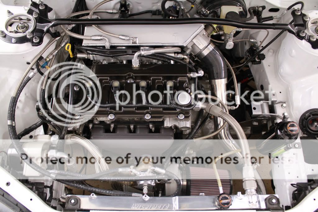

The bottleneck is under the hood. The rest is fantastic.
I had to replace almost everything to get "Race Car" performance.
