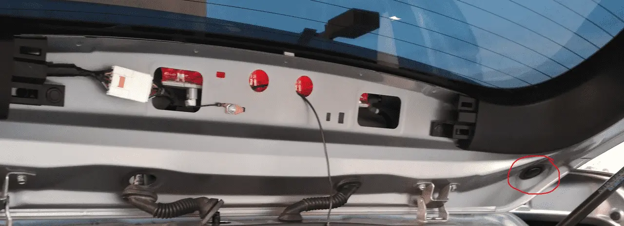

I was thinking about adding a spoiler to my Sport 6MT. I found one on a wrecked GT but I don’t see how it is attached since I don’t see any fasteners. Is it just adhesive? What’s the easiest way to remove it?
I'm not 100% but I believe that it's bolted on.
There's a plastic plug in the corner and there should be a nut behind it.

Thanks for the info. Yep - it's just bolted on, with a couple of foam pads to keep it from rattling but they don't have any adhesives on them. The strange thing about removing the spoiler was that it was held on with an 11mm nut on the left and a 10mm on the right. I didn't have a deep 10mm socket with me but some guys in the yard let me borrow theirs after I loaned them a 3/8" extension.
