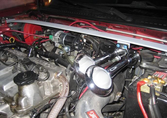

Stock horn sucks. Swapped that out the first week i had the car with the same horn pictured above.
Save your pennies though and do the Hella supertone kit. It's the nicest loudest horn you'll get without going full airhorn setup
if you wanna step up your horn game, hella horns are the way to go!
