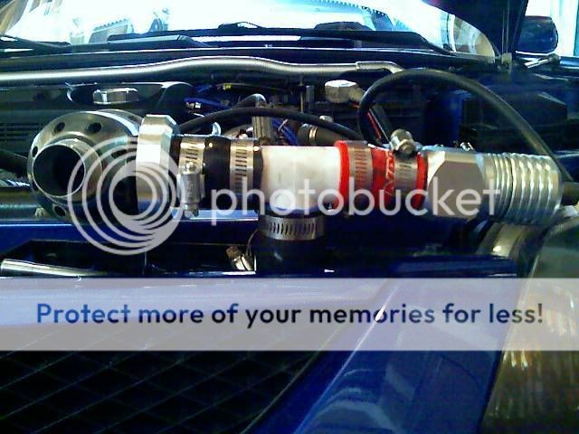

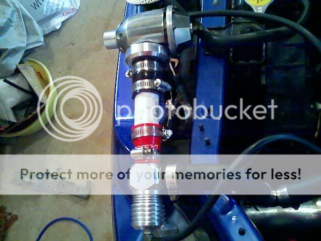

Things i've done today, plus some pic, still have turkey

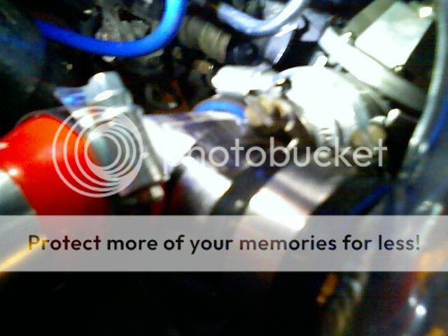

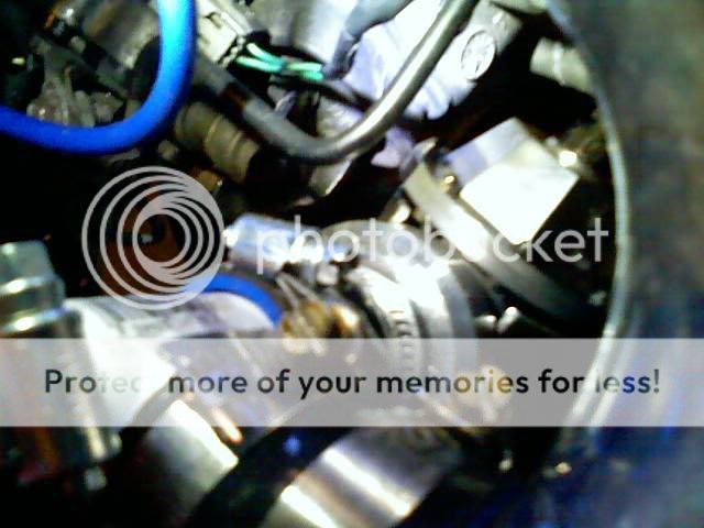

Ok today I tried to set up a dual system to kill my turkey. I'm not using the stock bpv but a turbo xs that was recirculating and for my bov I used the ssqv. I tried to split the opening in the perrin fmic for the bov into two. I did this by picking up a pvc t valve. I then put the ssqv on one side (vta) and the turboxs bpv recirculated on the other. My results still failed and have turkey. I took some pics with my camera phone so please be easy on the judging the quality.
My contraption
The setup is a little hard to see but its there the , ssqv is on the bottom or more to the right of the pic, and the red coupler is where the turboxs is connected. I mean i was able to vta on the hks without stalling so i mean something was working right. But yeah ajusted the hks from tight to loose, nothing. so I took the setup out and put just the turboxs back in for now.

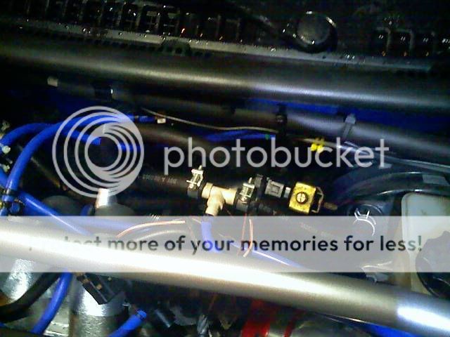

Oh heres my brake booster tap for the one who wanted to see it.
