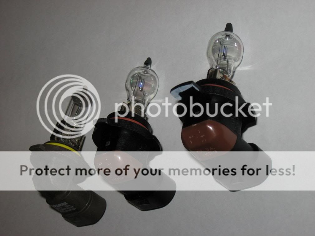

here are the bulbs lined up-

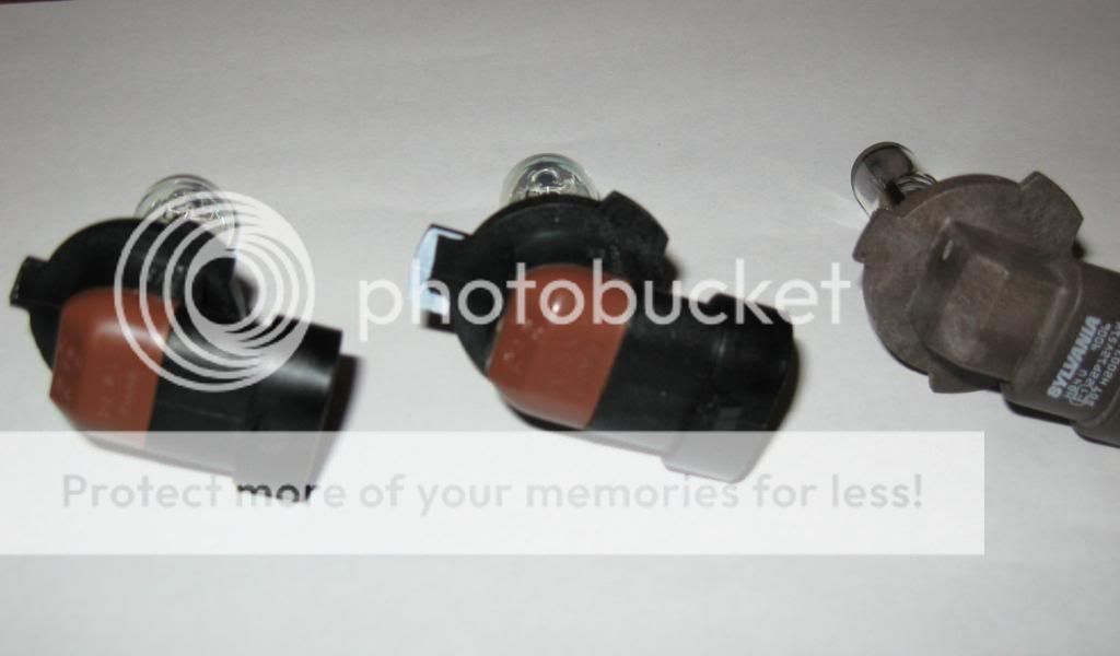

you can see the difference in the shape of the capsule from the stock 9006. note the trimmed tab on the middle base, and the marking they use to note where to trim on the right bulb. i have to note that their marking work is sloppy, so you have to mark it better using a pencil, studying how the stock bulb tab is shaped.

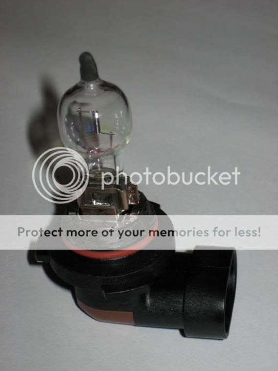

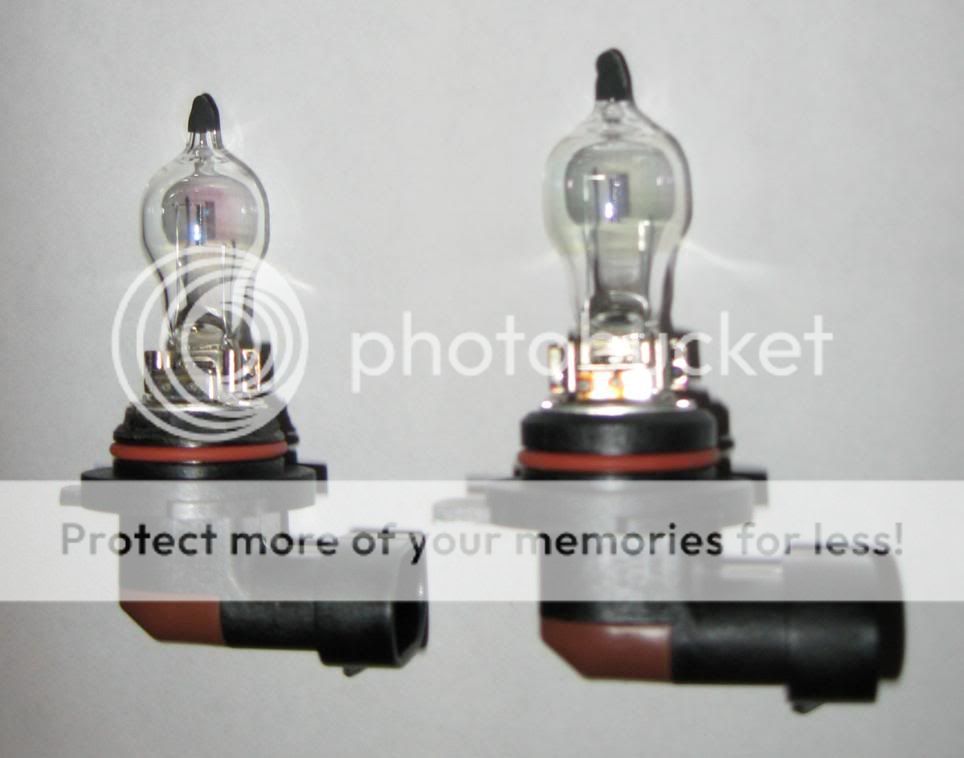

so i thought that all i had to do was trim the one tab, but i found out that the plastic base toward the capsule, above the red o-ring, interferes with the bulbs inserting all the way into the spot on the light. So, i had to in essence shave down the base, leaving just enough above the red o-ring to allow it to stay in place.

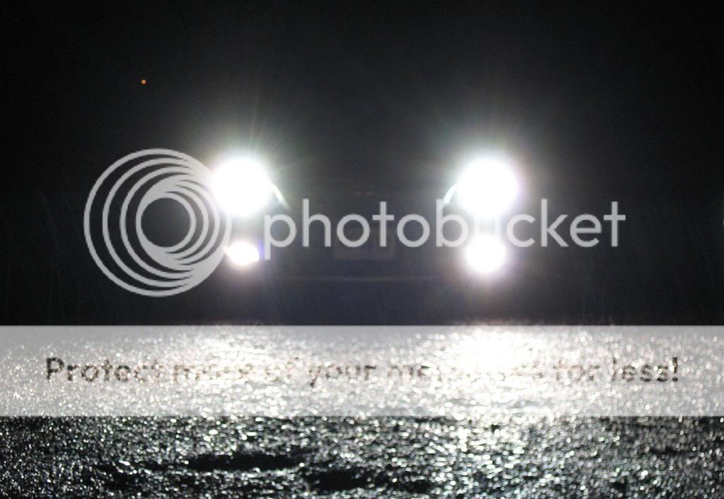

after that little realization and modification, everything went in like stock. It was POURING rain, so the pic quality is not the best as mentioned, but i took a pic with one stocker left in vs. one HIR. i think you can tell which one is HIR and which is stock.
the light color is a bit whiter than stock, but the overall intensity is definitely increased vs. stock. all that with no more heat and no more current draw than stock. It's more noticeable now when the fogs are on vs. off, but due to the aiming of the fogs, it's not going to be night and day until you actually are in the fog. i believe it is THEN that you will really see the function benefit of the upgrade.
