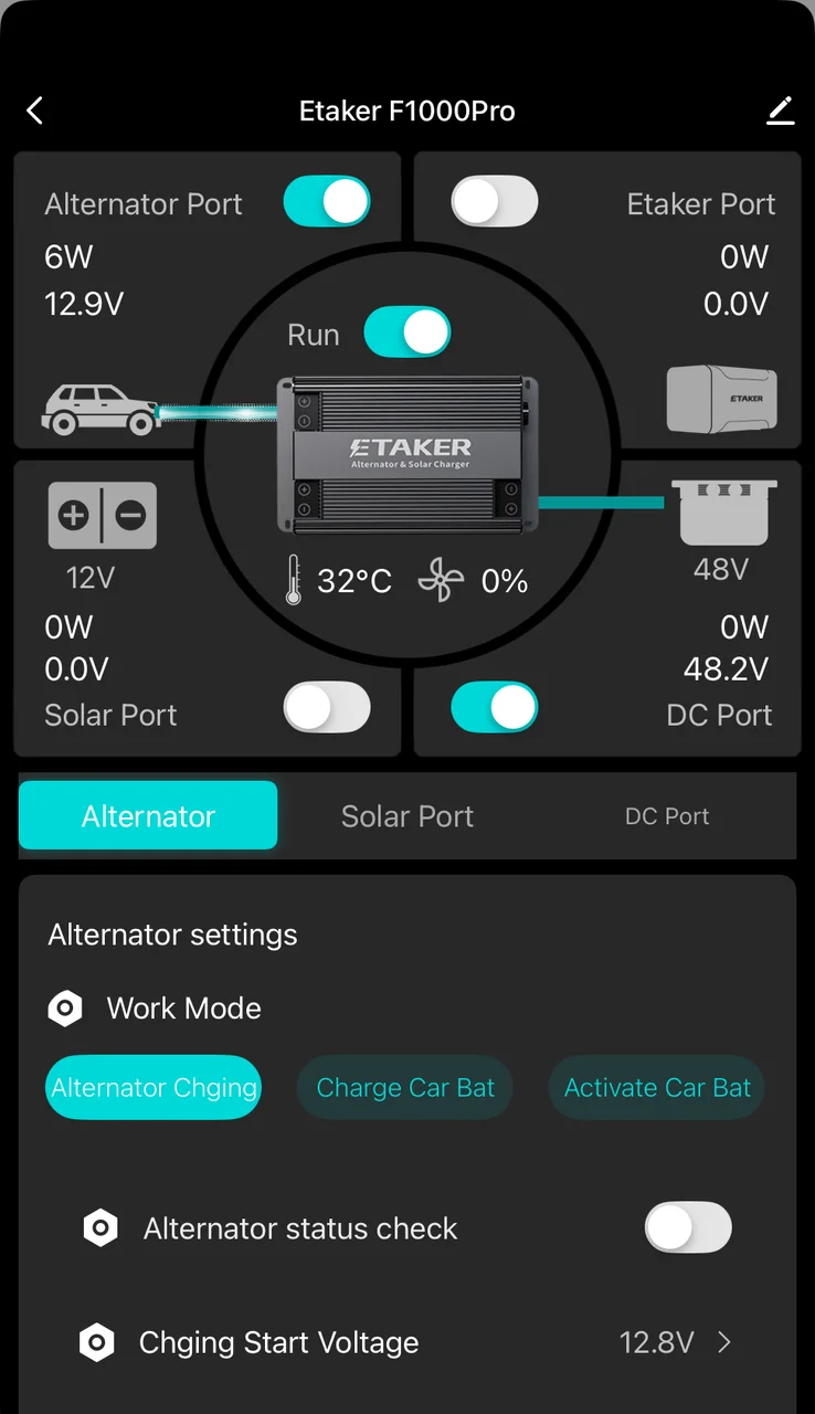

If you are looking for a DC-to-DC charger I highly recommend the Etaker units

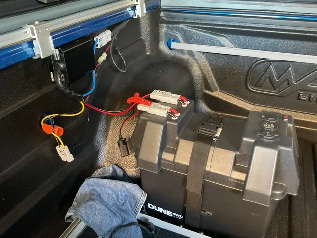

Keeping it simple, one of those battery boxes that include a number of different input and output plugs works well. Mine has a couple of Anderson plugs, a voltage meter, cigarette lighter sockets, usb ports etc. all came pre-wired. Just drop battery in, connect it to the charger. Done.
Photo attached of my setup. The charger is mounted to the left.
