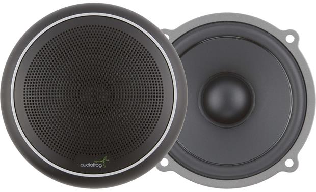

Moving on to the next phase, and that is adding "rear fill" to the system...
I am either going to put the speakers inside the trunk lid or in the side panels in the trunk, and I'll also need to stash a very small amp back there to power them.
Probably going to go with AudioFrog 4" mids and a Mosconi Pico 2 amp:
