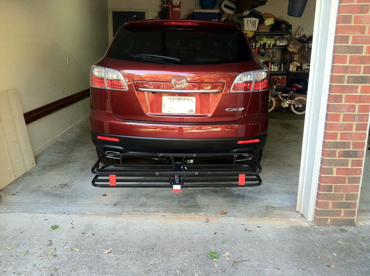

The stock reflective bits (the 2 red decals to the sides) aren't, IMO, enough visual indication of the carrier. Also, I have 2 needs -- one where the carrier can be close in to the vehicle, and one (tall cargo) where it needs the stock distance.

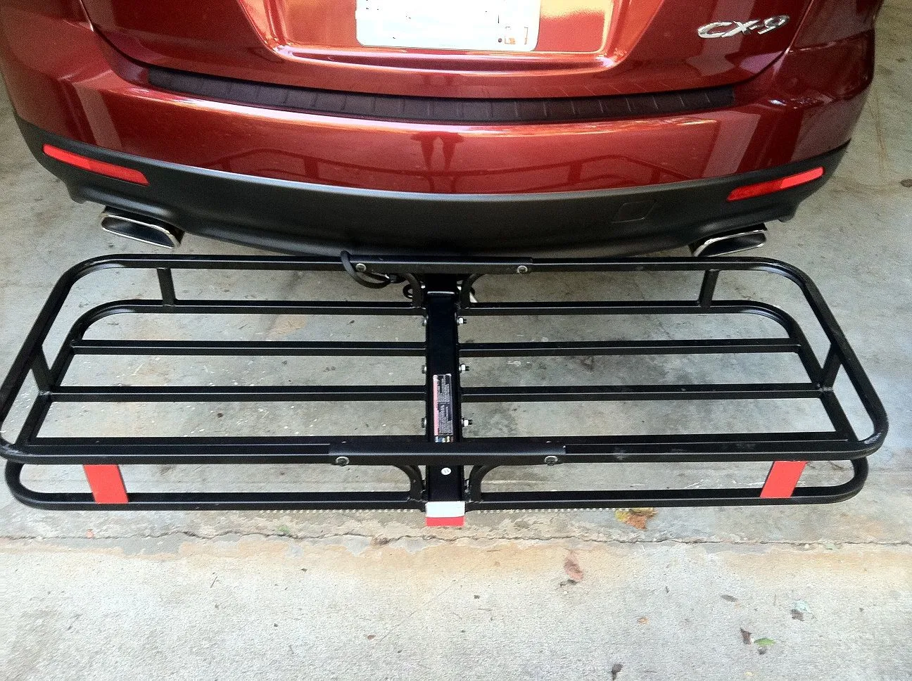

So, to the stock HF carrier, I:
- Drilled another set of pin holes for a 5/8 pin which position the carrier closer to the vehicle (the pictures reflect that, no pics of the stock distance). Dressed the new holes to prevent chafing and rust.

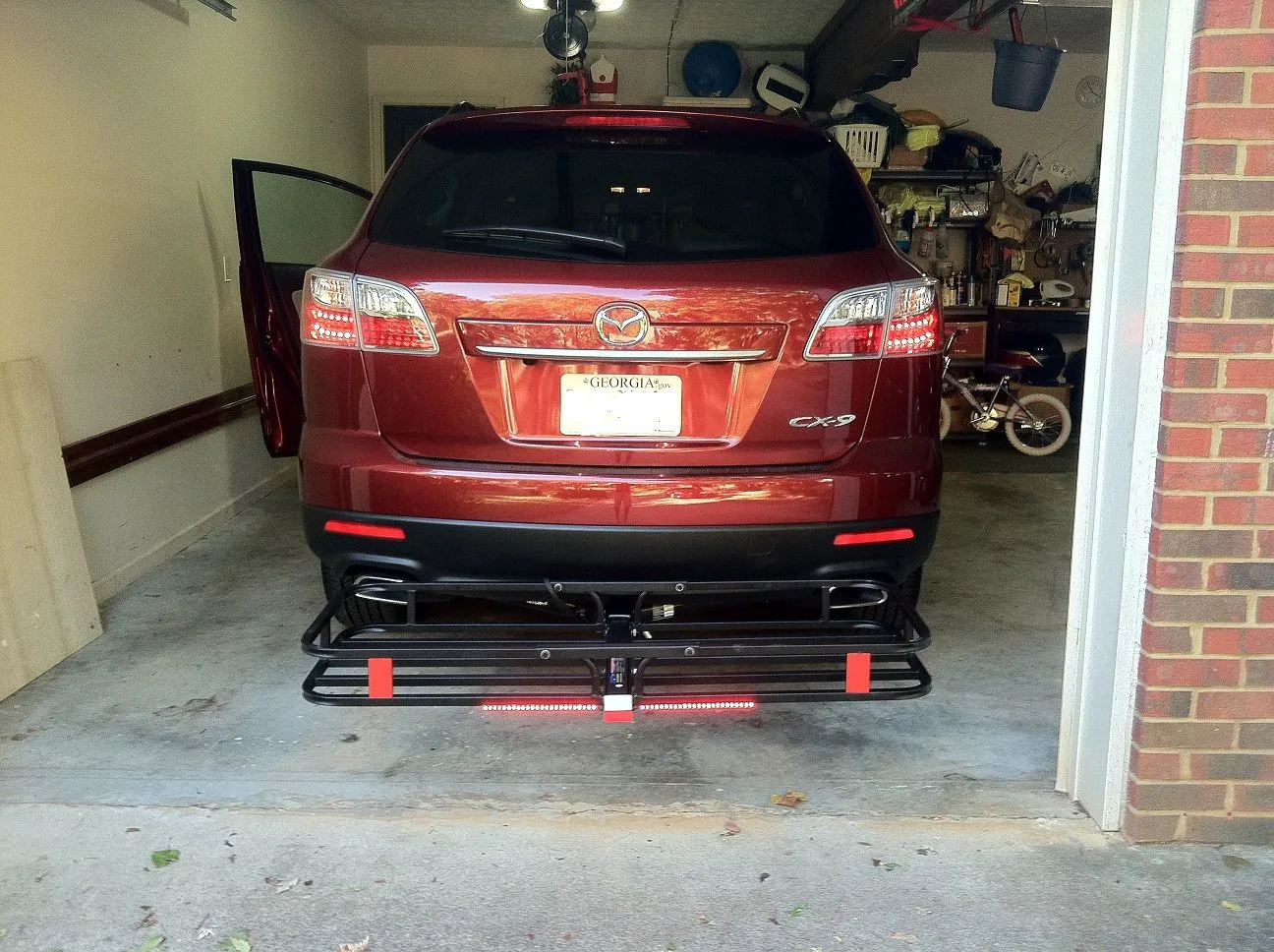

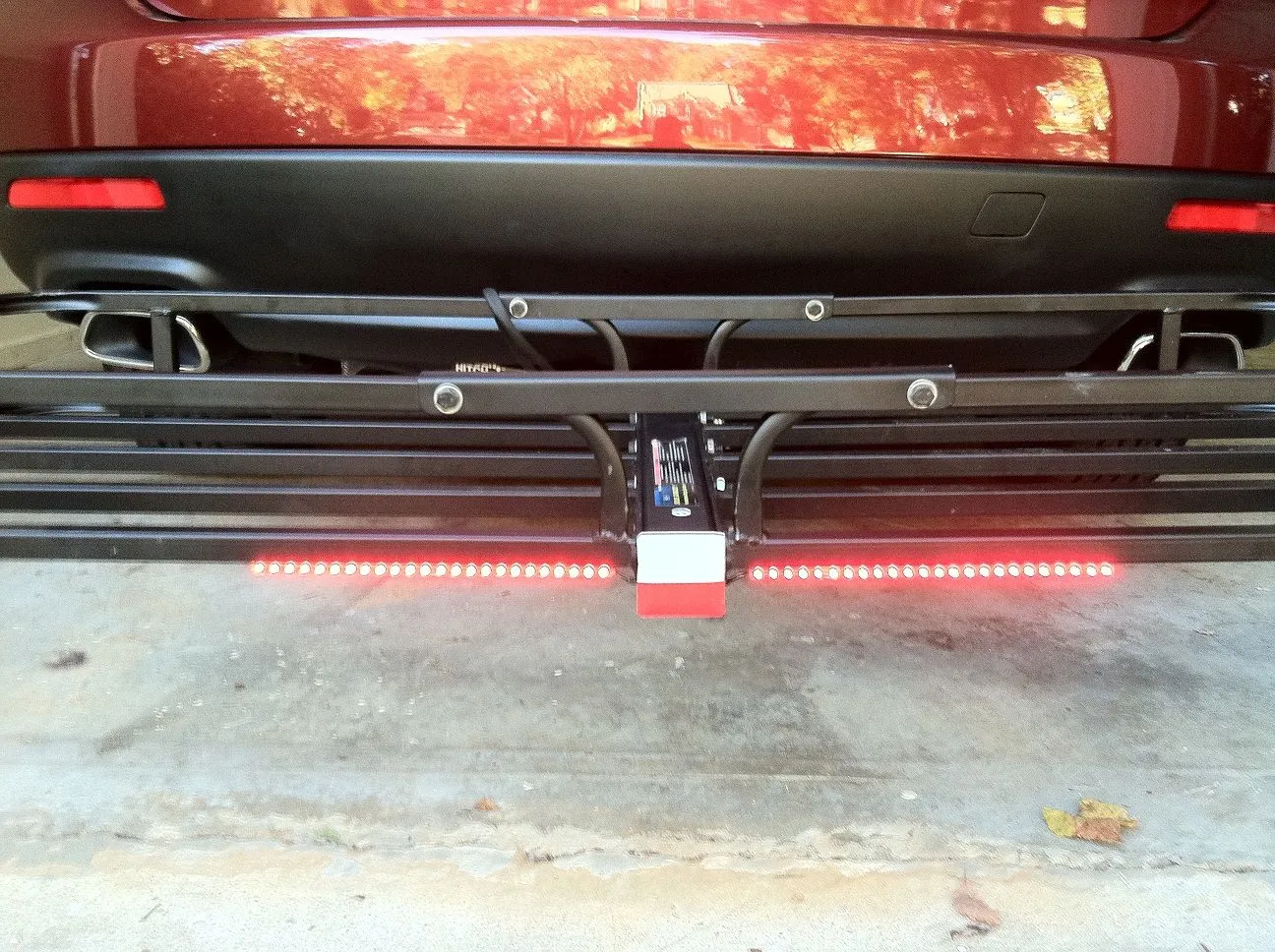

- Added 2 LED strips and wired them up to a 4-pin standard trailer connector, for running lights only (no turn signals). I ran the wiring through the center channel, with the appropriate holes drilled, dressed, and then sealed. The wiring exits the Hidden Hitch reciever at the front, and then wraps behind. I really like this wiring job, and the conduit is extremely heavy duty (its some spark plug wire wrap i had laying around). Connections all soldered.
- Added some reflective tape to the center button (it was just painted red). I had this laying around as well, thought it was a nice touch.
