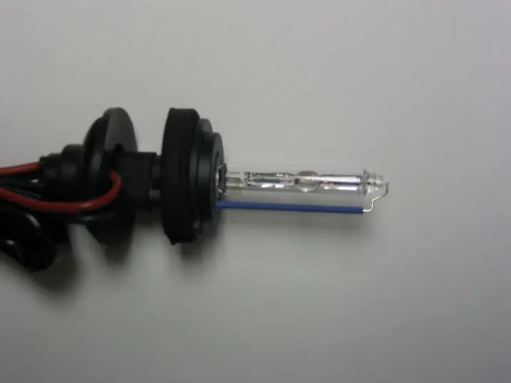

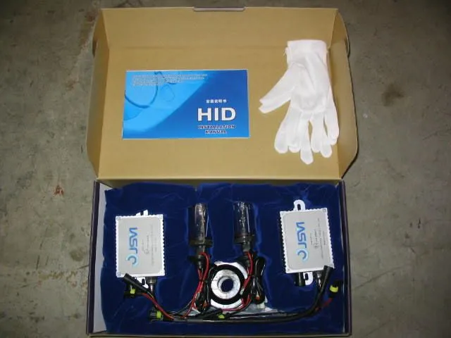

care to share what kelvin rating you have?
my friend is retro-fitting HID headlights for his SRT4 and other peoples so im going to learn how to do it and then do it for my car and possibly other peoples car
heres photos of the box, content and bulb
