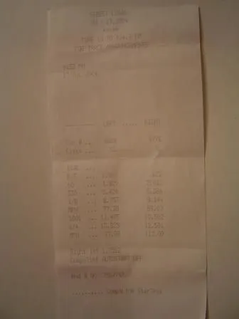

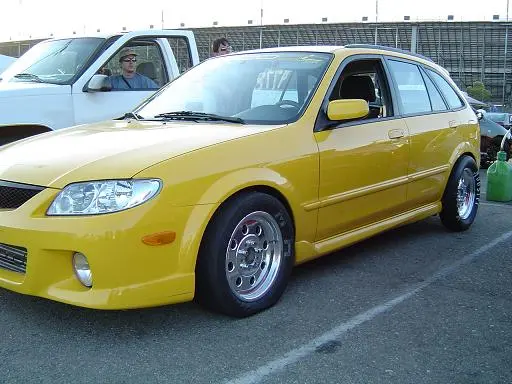

We went to the California Speedway yesterday with full race MH drag slicks and Hoosier skinies in the rear.
We made 3 runs. 1st was 12.9 at 106 MPH, 2nd was 12.6 at 110 and 3rd was 12.5 at 112 MPH.
I did not launch hard in any run since we have stock tranny, axles and organic clutch and didn't want to brake anything.
The car performed perfect in all runs eventhought it was around 100 degrees F.
R/T .622
60 foot 2.013
1/4 12.501
MPH 112.07
1FASTMP5 was with us in his P5 with the MSP setup and run very good at 13.9 and 102 MPH. With slicks, his car can be easily in the low 13s.

The only thing you need other than the basic kit is a high performance clutch, forged rods, race slicks and larger injectors. (of course race gas to run 20 lbs of boost)
We don't have any aftermarket engine mounts or LSD which can improve the times a bit.
HiBoost TS said:
20 psi on race gas.
With some more practice, the car can be a little faster.

I know, in fact in one of the runs I did 1.9 in the 60 mark, but i was really scared to launch as I should and also the rev limiter was set at 6500 so I had to shift early form 1st to 2nd so I am loosing a bit of time there. We should improve.
duMb KeoLa said:
what about my question??? hahaha...just playing
We are running the basic kit with upgraded Haltech E6X engine management system, 440 cc injectors, stock fuel pump, Pauter rods and stock pistons (a setup exclusive from HiBoost) ACT HD pressure plate with organic disc).
The turbo is an IHI VF22 capable of 350 HP and it is full ball bearing with our cast 4 into 1 turbo manifold and 2.5 ID downpipe.
The rest is stock. No other engine mods, stock engine mounts, stock axles, stock tranny with no LSD (yet) Quaiffe in the plans.
I think that our setup is perfect for both the street and race. We can sell the kit with a Garrett GT30R but then it will be a lot laggier than the IHI which spools very very fast for good throttle response.
