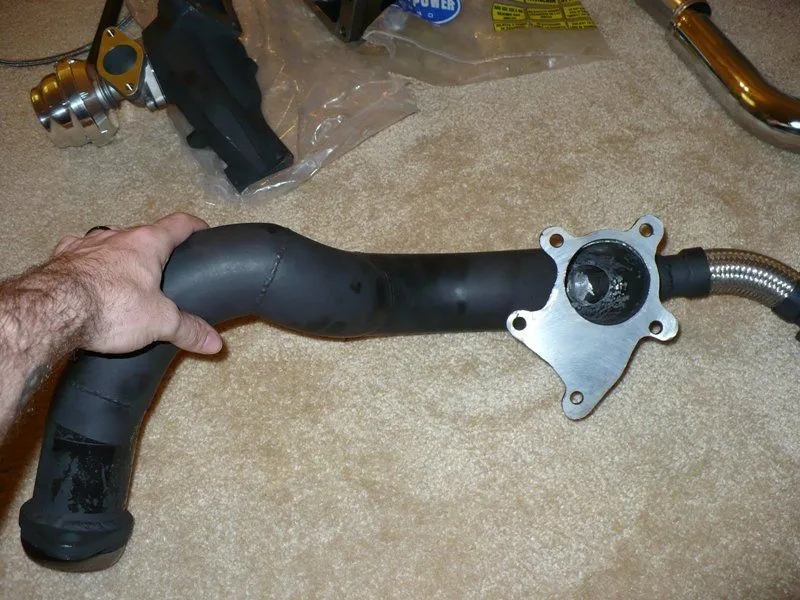

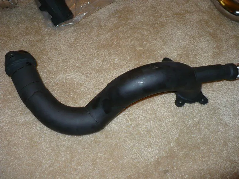

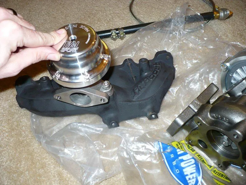

ok thanks for the help i got the fittings i need. now one more question and im all set. i dont see anywhere for my o2 sensors to go. there are no spots on the downpipe or the manifold. i took some pics, just wondering if im missing something or if i need to go to an exhaust shop to have them put some in. thanks.
ya, you'll have to have the bungs welded in or run without them??? of course you won't pass emissions fo shua!
Ya I ordered the same DP and mani as you have from TBK, I'm just waiting on it. Only mine won't have the gay flex pipe for the wastegate.
You will need to weld in your own bungs for your wideband and EGT.
wont it hurt me to not run the o2 sensors, like a cel or something will pop up? ill probably just end up getting them welded in.
