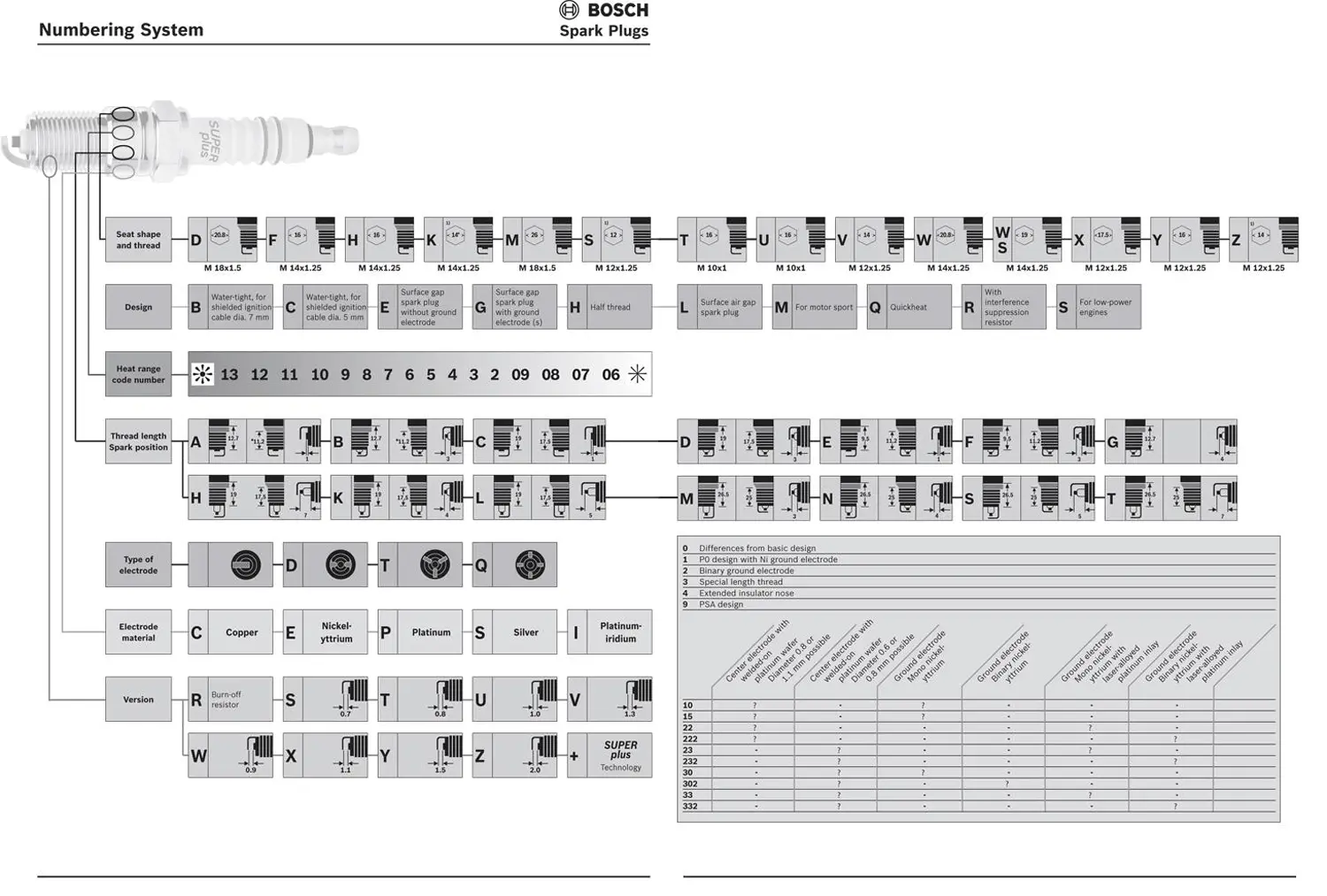

A little investigation info:
Bosch plug 4515 should have this number on the plug - HGR8MQI
If it does, it is my understanding that the 8 represents heat range 8 under Bosch's system. See attached chart to decypher Bosch's numbering code.

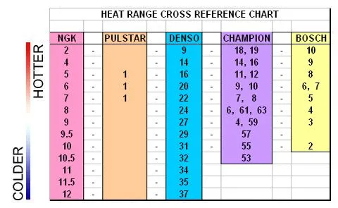

Then consult attached cross-reference chart.
If I am reading the chart correctly, that would be equivalent of an NGK 5 or a Denso 16.
If that is right, the Bosch plug is one to one and a half heat ranges too hot. This could be the cause of your problem.
