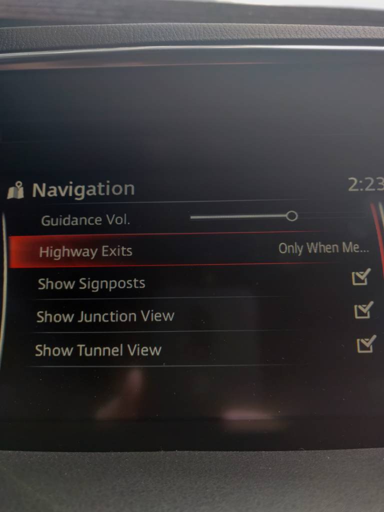

9. If you use Mazda's GPS, I recommend setting the "Highway Exits" setting to "only when menu is displayed". This gives you a full screen view while driving and if you want exit info you just click the knob to pull the menu up. Default setting is always show. Lots of settings in there. Recommend going over it closely. - 7eregrine

* If you use Mazda's GPS, I recommend setting the "Highway Exits" setting to "only when menu is displayed". This gives you a full screen view while driving and if you want exit info you just click the knob to pull the menu up. Default setting is always show. Lots of settings in there. Recommend going over it closely.
