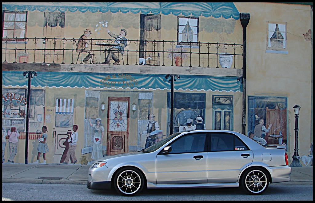

Hrm, that's interesting.
Would it be an even 1.4 drop, or would the fronts be lower as well?
The fronts in both kits are actually the same. The P5 rears are either a little bit taller or have higher rates to compensate for the extra hatch weight. Here is the sedan with the sedan pro kit... (mostly to see what the front looks like)
