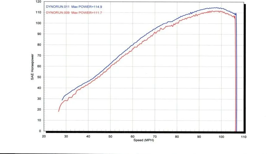

Hmm, doesn't sound like the dynojet operator is very experienced. On a Dynojet, you can plot the horsepower curve over speed, rather than RPM. It's actually more accurate. You should be able to go back to the shop and have him load up the file, and show the scale in speed rather than RPM. Like this.

Thanks for the reply Josh. He may have tried this, but I dont know for sure. How does the dynojet determine speed? Just by how fast the drum is turning? So no other sensors are needed (the wire clip)?
I honestly prefer the RPM scale (I like to know where in the RPM band the engine is doing what), but if mph will work I would use that.

force=massacceleration
The roller is a known mass and diameter, and by how quickly the car accelerates the roller, the computer calculates power and torque A dynojet doesn't even need an RPM pickup to give it's figures. It's just a valuable tuning tool. I've done a couple runs where we had a bad pick-up and weren't able to use the RPM chart.
It doesn't really say why you had issues with yours though. We just made sure all the connections were good, and the pick-up was over the ignition wires properly and it all worked well again the next run.....

the only problem i have with the speed vs rpm (my dyno's are all speed not rpm) is that when i changed from the stock 195/50/16 tyres to the current 205/45/16, speed dropped. so instead of going to 124kph in 3rd i was only going to 118kph. also, that speed is not what i see in the car. in 3rd my car can get to about 135kph
