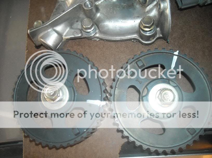

I need to know which cam gear goes on what damn pin. i did a rebuild and forgot to mark it down so now i need to figure out what the markings are and which of the two pinholes to use for both intake and exhaust cams. please help fast!!!! its a common fsde motor!
I just took apart my new donor block. The cams tell you which slot goes where. The cams are universal I guess. Align the markings/dots on the cams accordingly.
Doesn't matter just line up the I and E marks at 3:00 on the intake and 9:00 on the exhaust they're interchangeable. make sure though when they are on the the cams in these positions that the intake #1 LOBES ARE POINTED TOWARD FRONT OF CAR AND THE EXHAUST #1 LOBES ARE POINTED TOWARD THE REAR OF THE CAR.
