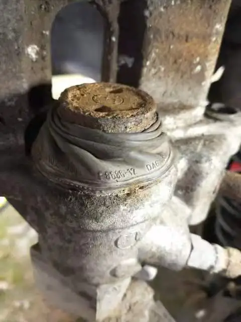

Help! Rubber seal twist when I turn the brake caliper piston back
cx5
Hi, I'm changing the rear brake on 2010 Mazda 5. When I'm trying to turn the piston back, the rubber seal also twisted. Can anyone help me on this? Thanks a lot in advance!
Answered this by myself for others to reference. The rubber seal was stuck with the piston because of the rust. Just clean the rust between the seal and the piston and try to detach the seal from the piston using a screw driver. You can spray a little wd-40. Someone says the wd-40 will dry quickly and is not harmful to the rubber seal.
