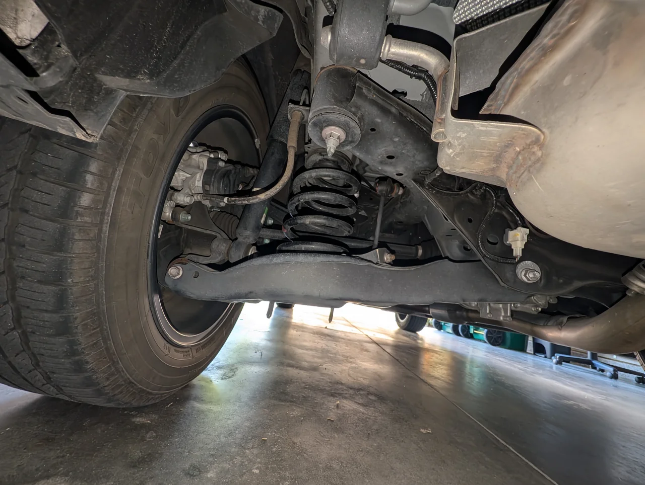

I own a 2021 CE AWD(non-turbo). I had to replace the rear wheel and suspension due to a bad T'bone collusion. I think my original part number is probably KD35-28-300 and the replacement is probably KD35-28-300A(This was mentioned by the repair shop before the replacement).

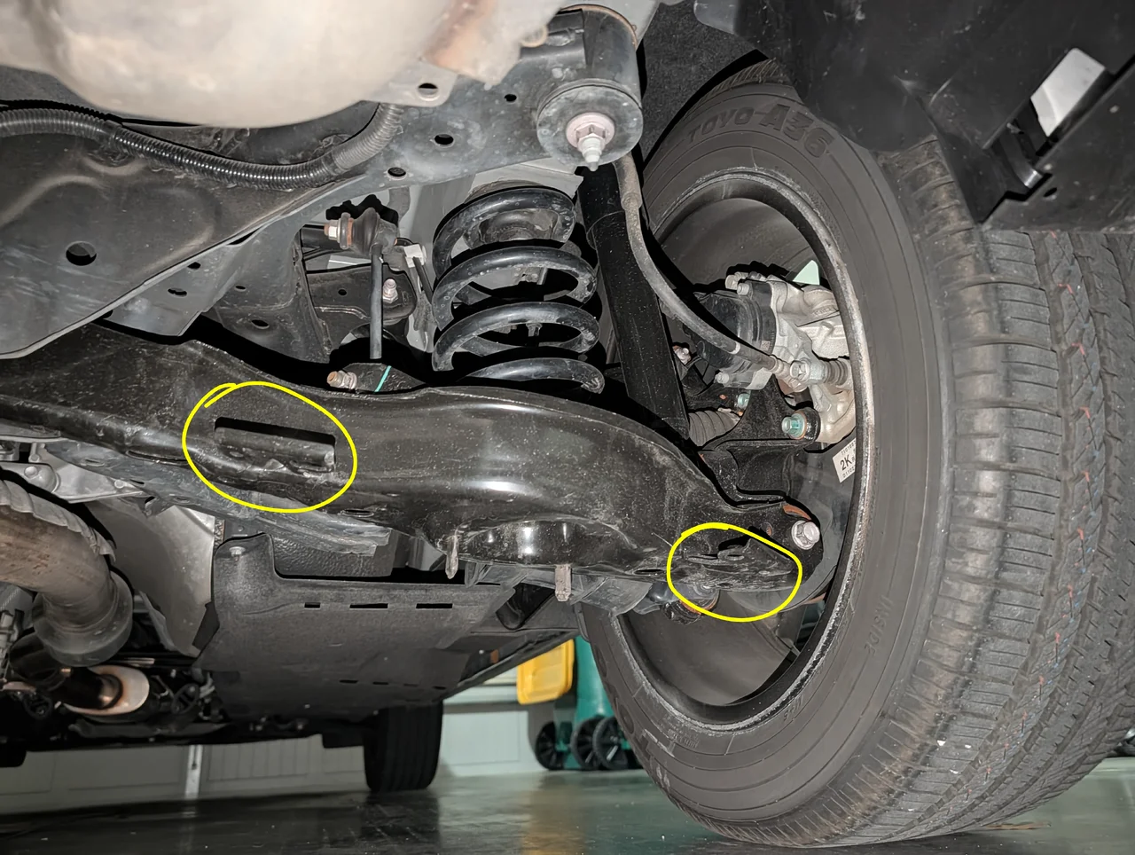

The official mazda part mentions both parts but some parts store mentions that KD35-28-300A is not for AWD. The replaced part looks a little different from the original. please check the highlighted image that has mounting brackets(Maybe?). I want to make sure they used the right part.
1. LEFT Wheel Original
2. RIGHT Wheel Replaced

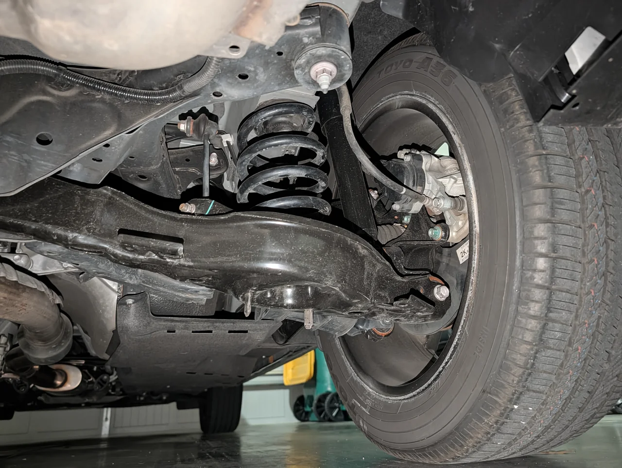

3. Difference on right
When parts in Mazda's system get a design revision, they add the "A" to the end of the number. I wouldn't think twice about the new arm not being exactly the same as the other side.
If the part ends up with a second revision, the part number will get a "B" at the end, and so on.
