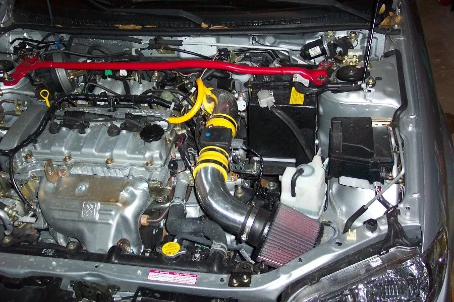

I basically installed it with no instructions. Take off all the plastic stuff up to the intake manifold. Assemble ebay SRI as needed. Use the brackets supplied on the corner of the battery box to push the intake away from the master cylinder. Otherwise, it will rub the intake. Here is a pic of mine completed.

CRAP.... I lost bracket bracket for my eBay intake after a move. (Never try to do anything before a move.) Didn't think I needed it but it rattles sometimes at clutch engagement. Anyone know what size piece would work?? Size bolt?
It could also be the extra weight of my Monsterflow intake on the piping vs. regular eBay cone filter.
thanks
It is rubbing the master cylinder, that is the noise. I would go to the hardware store, and see if they have any metal stock. Then take it home, make a bracket. I am using the stock hardware to secure miine to the battery tray and the maf.
Or you could cut about 1/2 inch off the pipe going into the intake. Then you will get no rubbing......use a hack-saw and just make sure you file afterwards.
