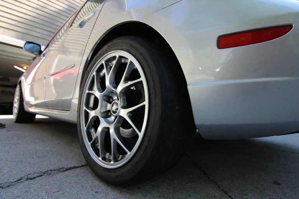

Tires are 245/40/18
the back tires rub on the fenders (my fenders are not rolled)
Are my tires too wide?
If I switch to a 225/40/18 and roll the fenders am I good?

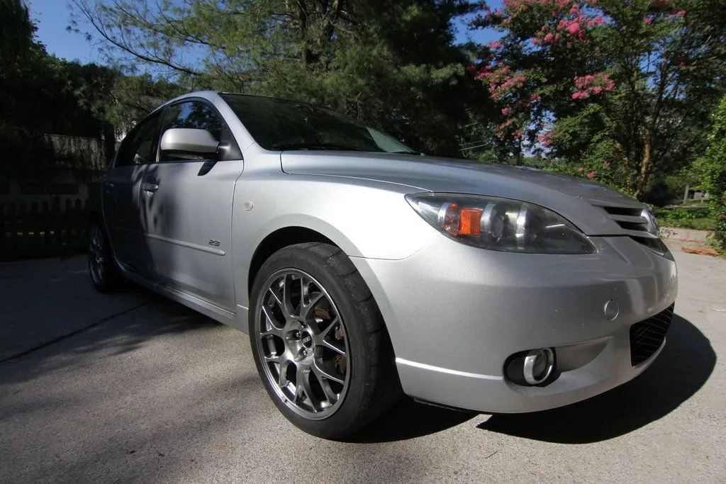

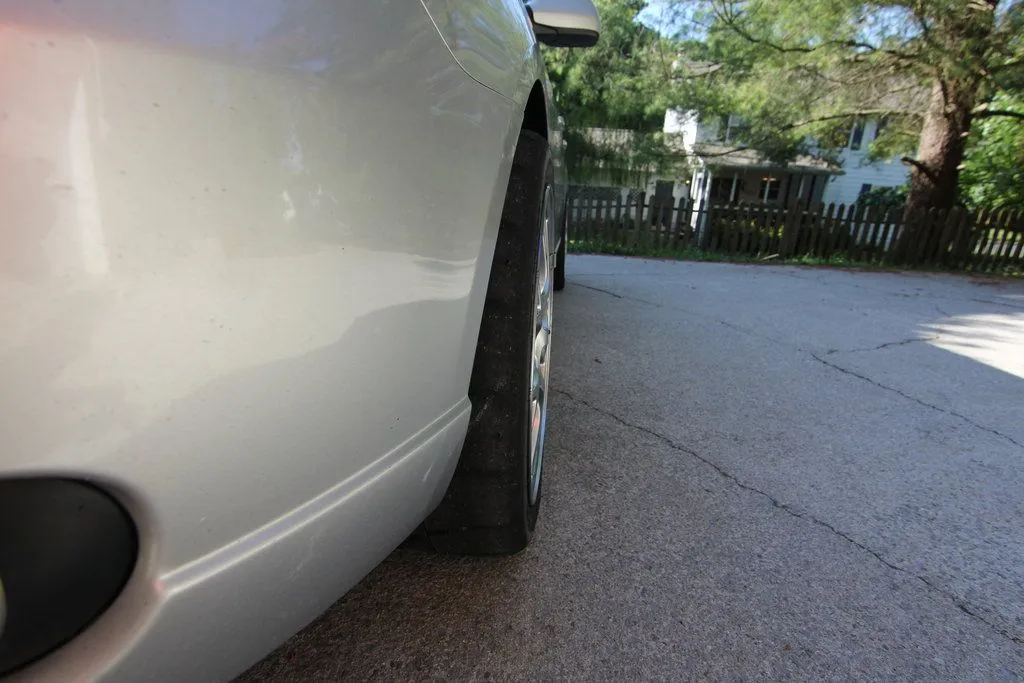

The wheels are 18x8.5 with a +38 offset the front wheels poke out about 30mm so how would I fix that?

Also, how are you rubbing when you have a good 3-4 inches of space? You dont seem lowered.
245 is way to big for an 8.5.
GO with a 225 or 215 40 40 40 40 40 series tire always. Roll your fenders regardless. Rear that is. YOur fronts are fine.

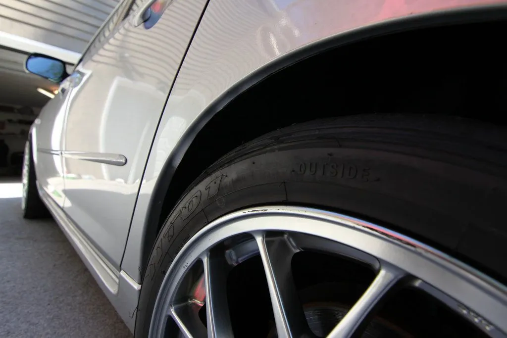

I honestly have no idea. I have stock everything and when it is sitting no problems what so ever. When I start driving especially in turns the back tires start rubbing and hitting the lip on the fenders. I am probably going to sell them and just pick up some BBS RGR's 18x7.5 with a +50mm offset when I get some money.

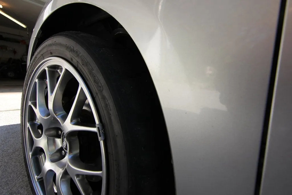

Keep those wheels. I like them. Jiust save up for new tires. Are you rubbing from the INSIDE of the fender? Can you take some pics wheere you see rubbing accuring?
attachment.php
You can see the lip is bent a little from the tire rubbing, leaving a mark on the outside of the tire. I know I need to roll the fenders anyway. But I do not want to get smaller tires then have to do more work for these wheels. I know I just need to roll the fenders anyway but it still looks like the wheel/tire will rub even with that.
