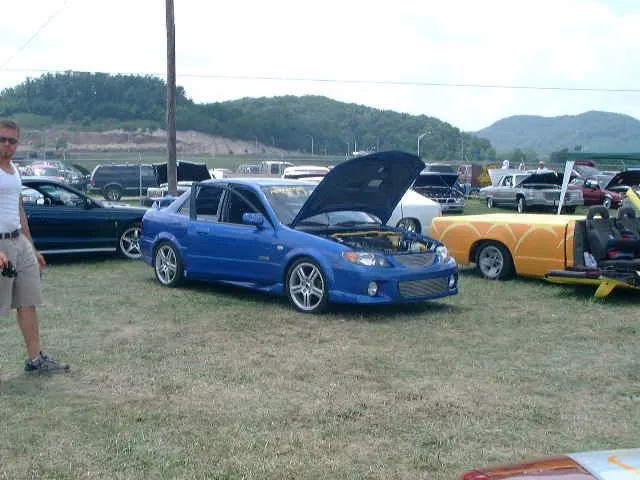

here is a pic of my car at the car show this past weekend, you can only put one finger inbetween the tire and fender well.

Hey tightMP3, where did you get that grill? It's not an AT grill is it? It looks pretty cool, I'd like to get one unless it's an AT grill.
