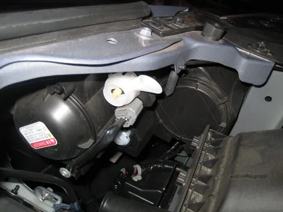

Hi. I'm hoping someone can provide guidance on adjusting the headlight vertical position on the CX-9. I've searched the forum and didn't find any info that can help me. My driver side headlight is higher than the passenger and therefore would like to adjust the driver side headlight lower.
Here is a picture of the driver side headlight of my CX-9. Can someone point me where the vertical adjustment is located?

i dont have a cx9, but im sure that there is a screw somewhere on the top of the headlight housing and somewhere on the bottom of the headlight housing.. basically screwing the top one "tighter" would make the headlight aim down slightly (adjust to whatever suites you best), same with the bottom screw, "looser" and the headlight should point downward also..
***someone correct me if im wrong though... like i said, i dont have a cx9 but this is usually how it is with most cars 'unless' you have the automatic adjusters inside the cabin..
but to get the most accurate results in calibrating your headlights, you must be 25 feet away from a flat wall on a leveled surface, then you adjust your headlights leveled to the height of the headlights on your vehicle..
i hope this is of some help to you..

Hi RJ, thanks for the response. I do have the leveler knob in the car, but by using this adjuster, it moves both headlights at the same time. I need to adjust the driver side only as it is higher than the passenger side.
I tried to look for the screws but if someone knows the location of the vertical placement it would help me before I screw around with it and make matters worse :)

For anybobody still looking to adjust their xenon headlights on the CX-9, the headlight adjustment link on this thread does not accurately diagram the CX-9 headlight, it's probably a link to another Mazda, but not the CX-9.
I just had to have my right side headlight lens replaced due to some type of smear inside the lens. You actually have to drop the bumper cover to access the lens and remove it. Dealer did it without damage, but didn't align the light to my satisfaction. The replacement was lower than the other side by a considerable margin, and I like my lights level with someone in the driver seat, not one higher and one lower.
The adjuster is in between the two round housings that contain the low and high beams. There is a translucent plastic round cap over the adjuster that just spins on its axis if you try. Just take a small flat screwdriver and place it in one of the slots all around the translucent cover, and pop it off. This reveals a bolt head that turned counterclockwise raises the low beam xenon, and turned clockwise lowers it. Upon completion of the adjustment, just pop the cover back on, and that's that.

This is a very old thread, but wanted to call out @badself instructions. The "hidden" secret is take the plastic cap(no easy feat without destroying it) to expose the adjuster. once there it is simple as pie to adjust. This information is very hard to find. Vertical Height Adjustment for Headlight on 2010 Mazda cx9
