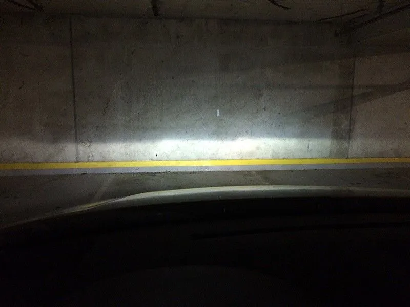

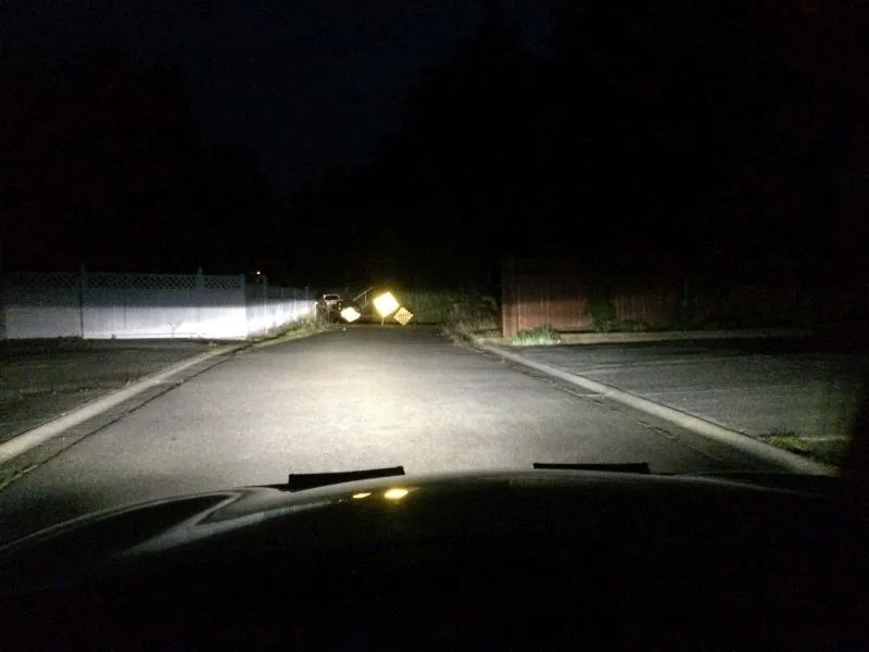

Here are a few images for reference.....
Here is a good comparison. Images taken in almost the same spot. The CX-9.....
And my old car with my home made projector retrofit (further from the wall, but more intense light).....
Your cutoff is set really low. Mine are much higher. I have only adjusted a couple of times but I would road test then find a wall, make an adjustment, road test again, adjust again. That seems like a really low aim.
The cutoff is higher than my car. If I adjust the with the dash dial, they get worse as they move up. Notice the lack of forefront light. That is my issue. It's like the intensity of the bulb isn't there. I will keep this in mind though.

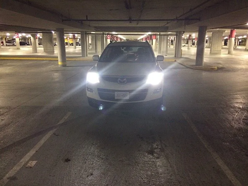

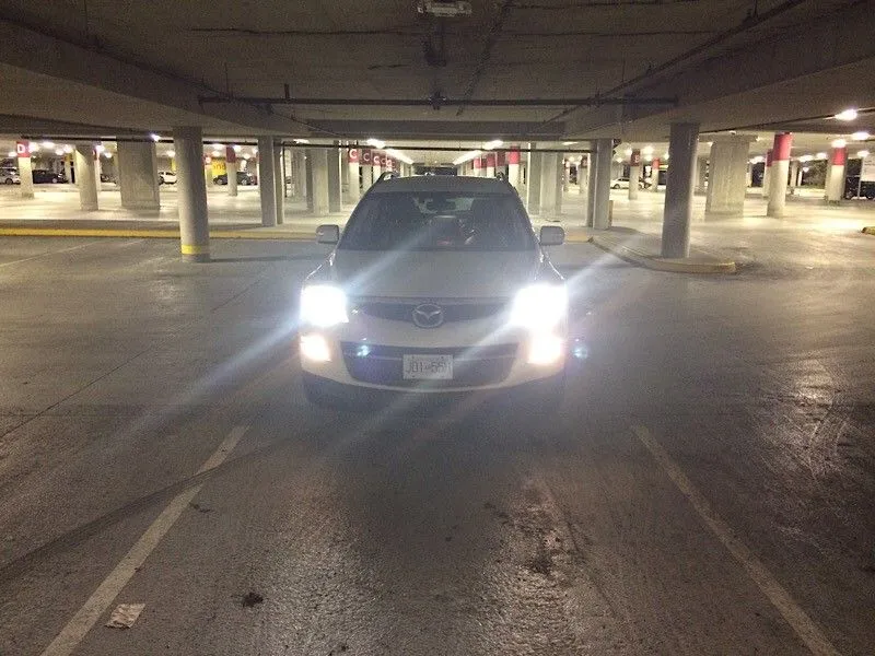

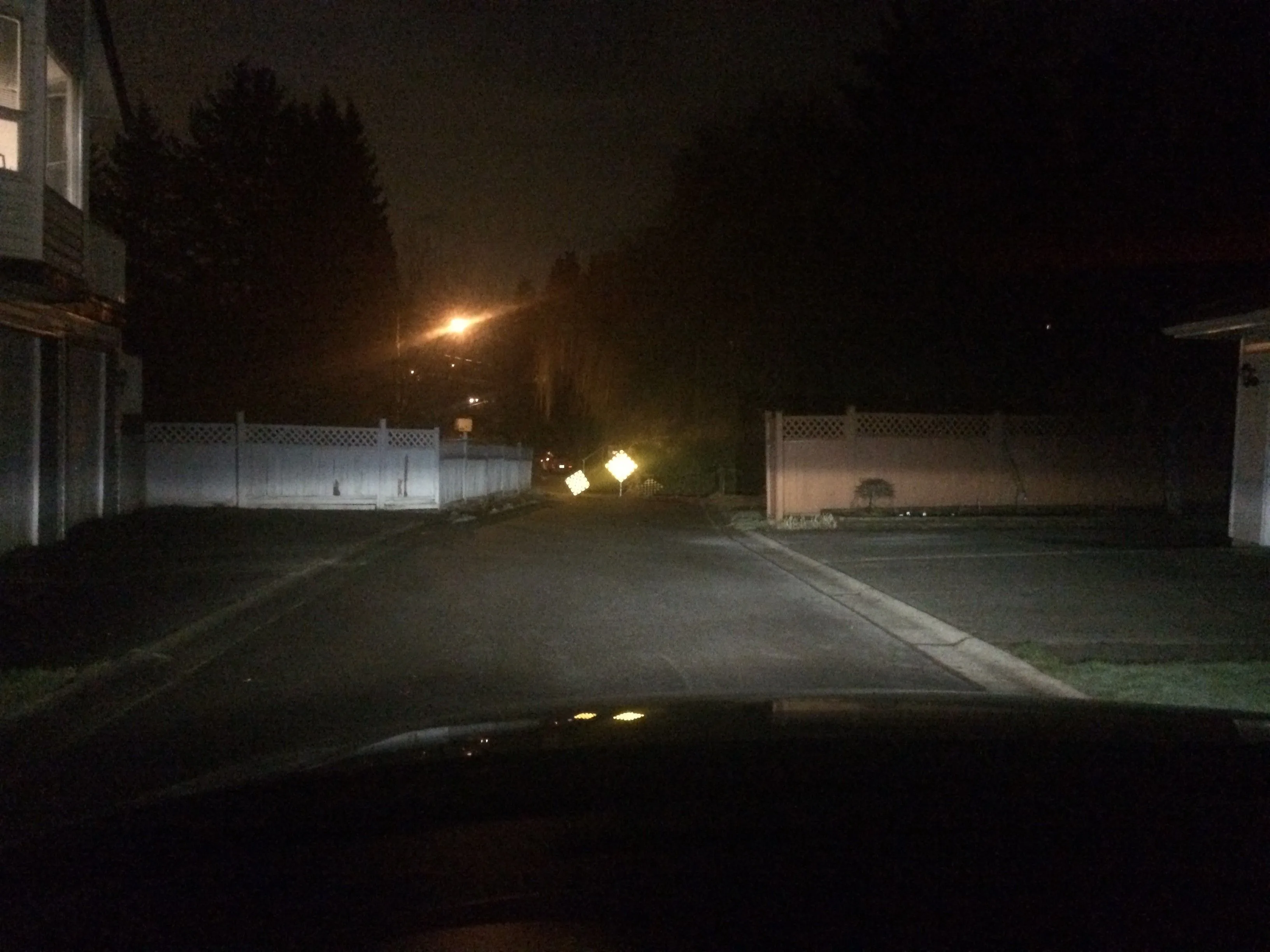

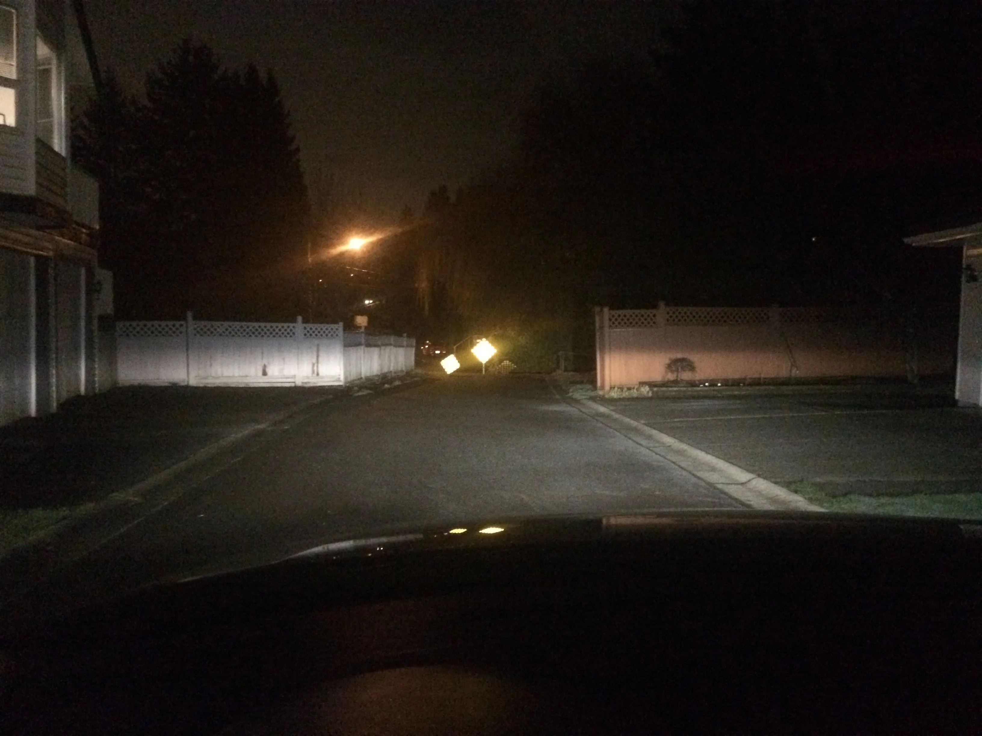

Just wanted to post this for future reference. The first image is my old car and the second image is the CX-9; same location and roughly the same time at night. It shows what I am talking about; the amount of light produced by the old car is WAY more than the CX-9.
And here is the CX-9 with the foglights on as well (you can hardly tell).....
