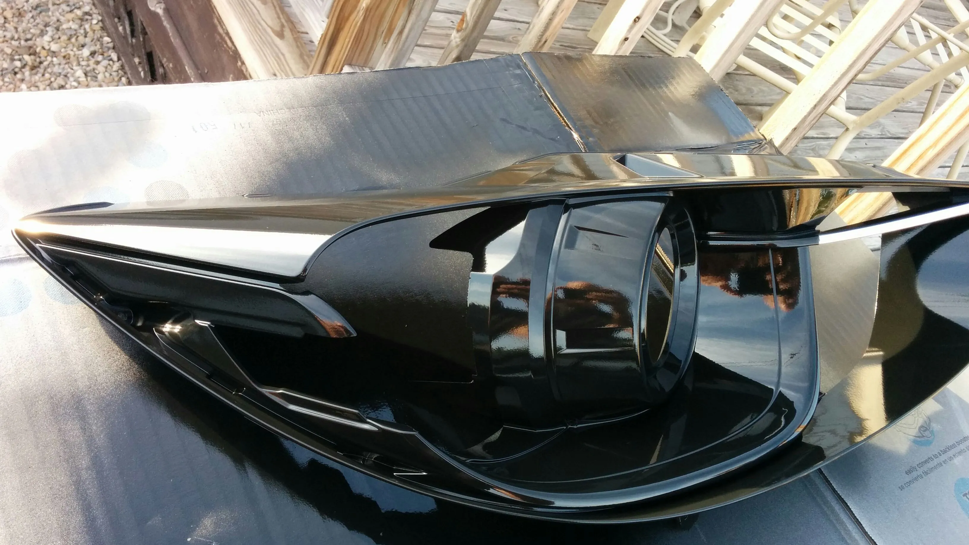

Retrofitted Maxima projectors last night and blacked out the headlight bezel. Came out great! I'll have to get some pics later.
Pics please. How much of the mounting points did you have to modify (if any) for the Maxima projectors?
I don't have pics of the mounting, but you won't be able to go back to stock projectors, and I had to trim the outer portions of the projector shield as well to get them to fit.
I do have pics of the blackout though ..

I'll get some better day time pics, as the wife had to take the car to work and I didn't get any shots of it yet with the lights in.

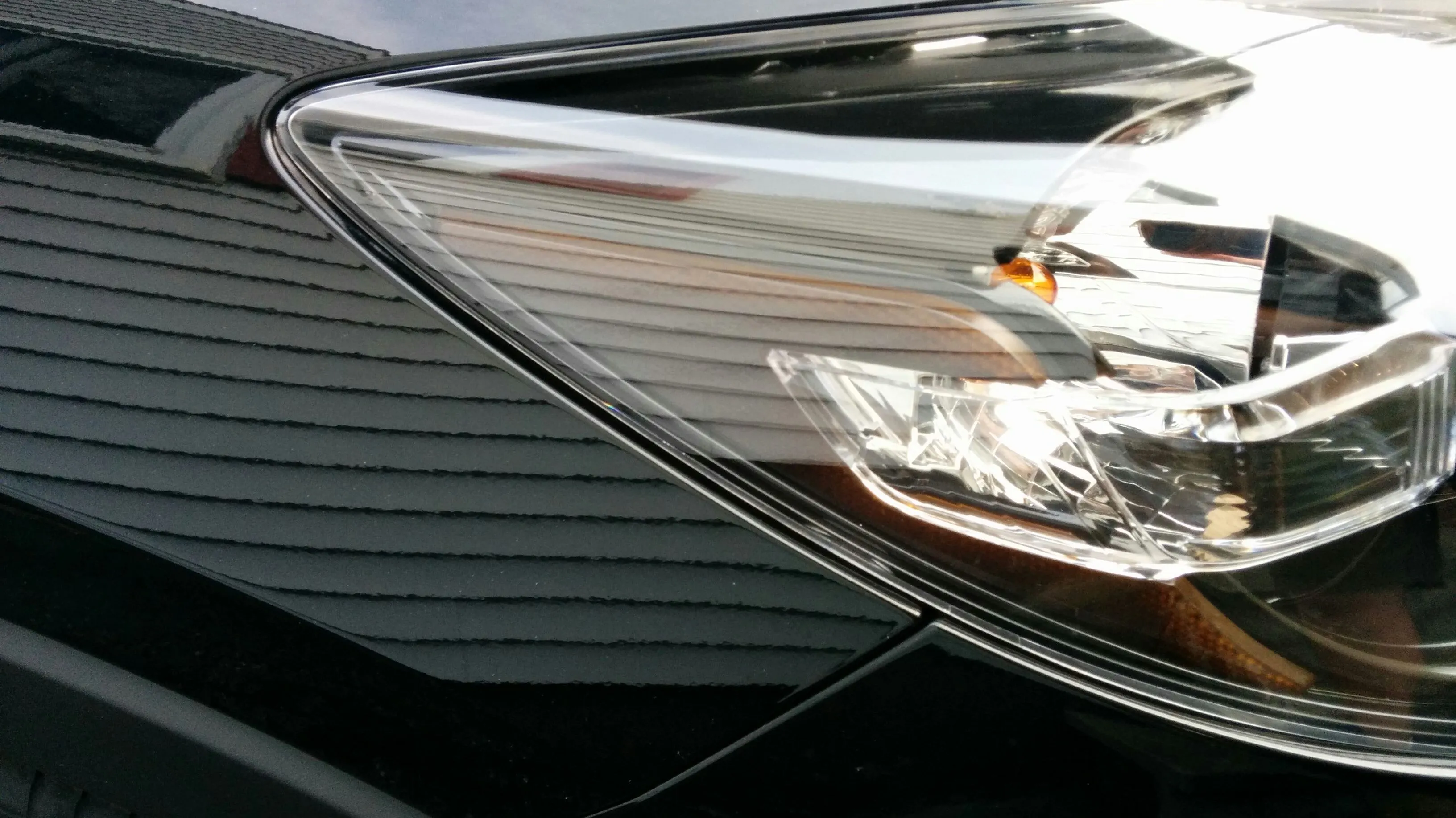

After doing a full Bi-Xenon retrofit in my Tundra, I don't want to drive anything with Halogen lighting, and doing the retrofit worked out great. Going to try the pics again ..

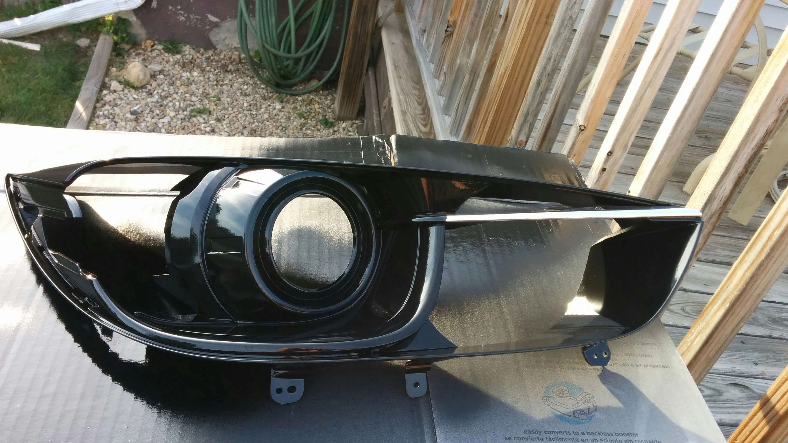

Couple more pics .. Tinted reflector and close up of sealed lights ..

Oh yes, that looks good. Real good. Was the disassembly difficult with the factory adhesive?
Looks good. IMO, some chrome amber bulbs would complete the overall clean and stealth look.
Not at all. Uses a type of butyl sealant. 250* for 8 minutes and they opened right up. Compared to my perma-sealed Tundra lights, these were a cakewalk.

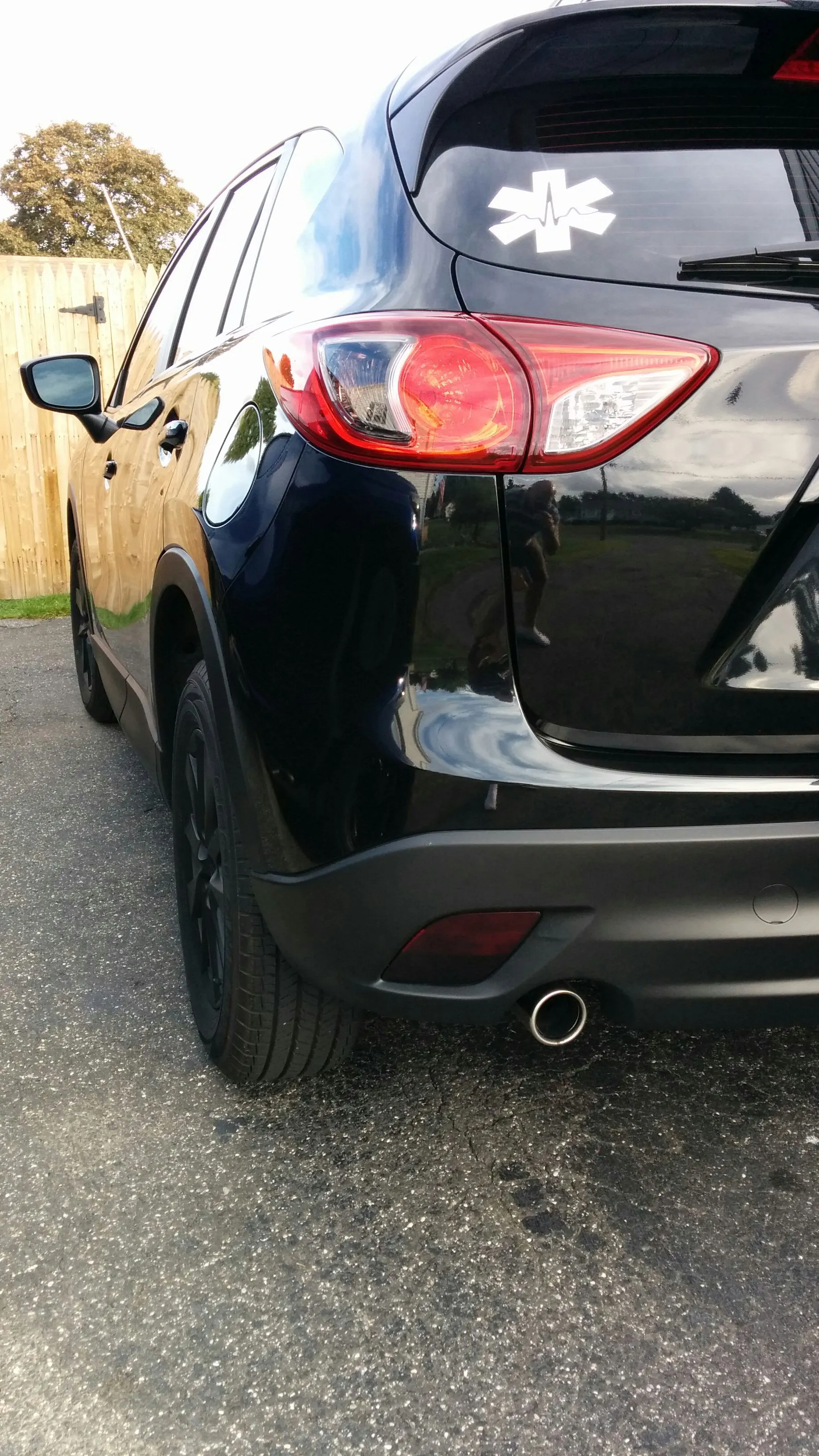

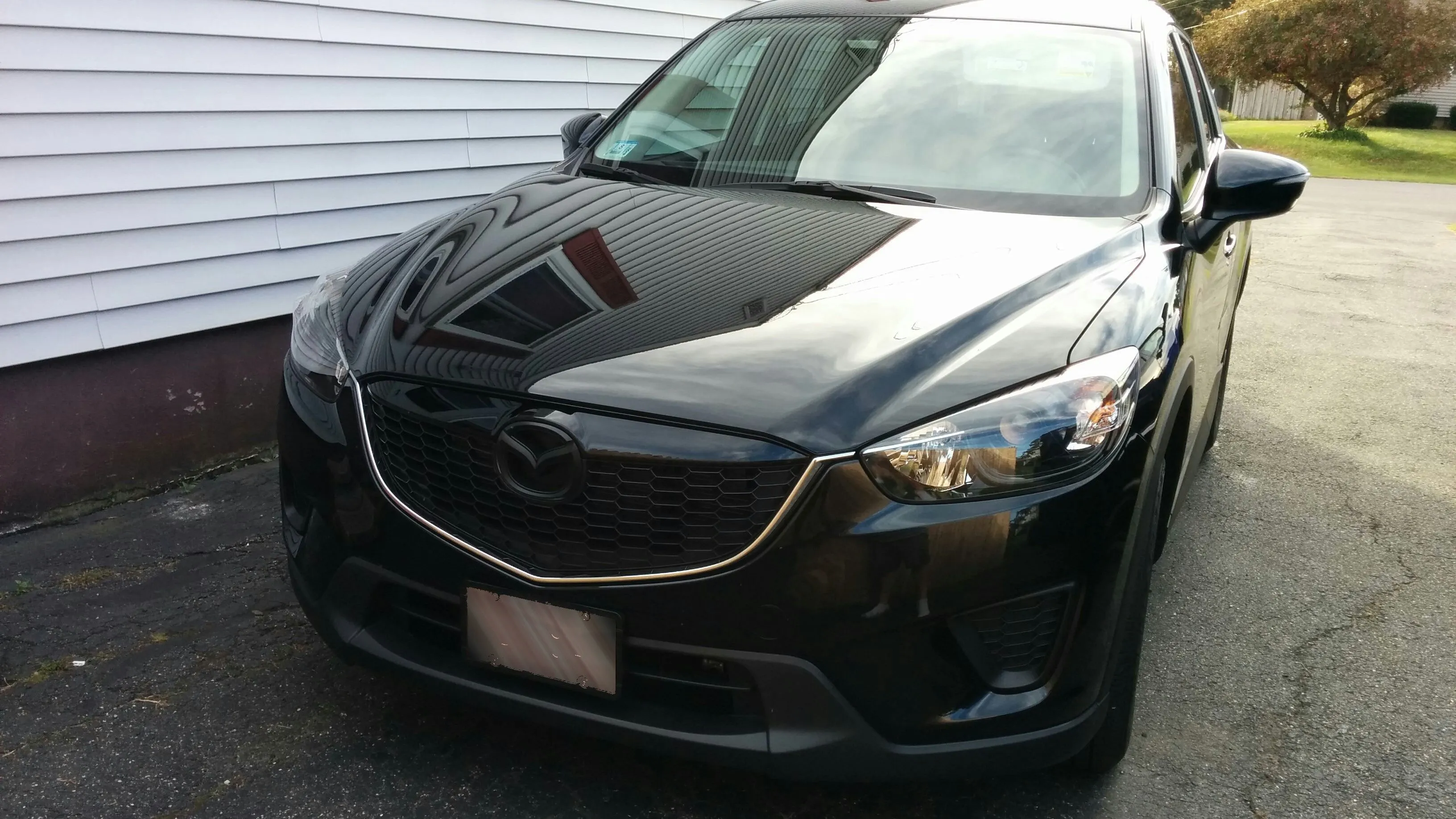

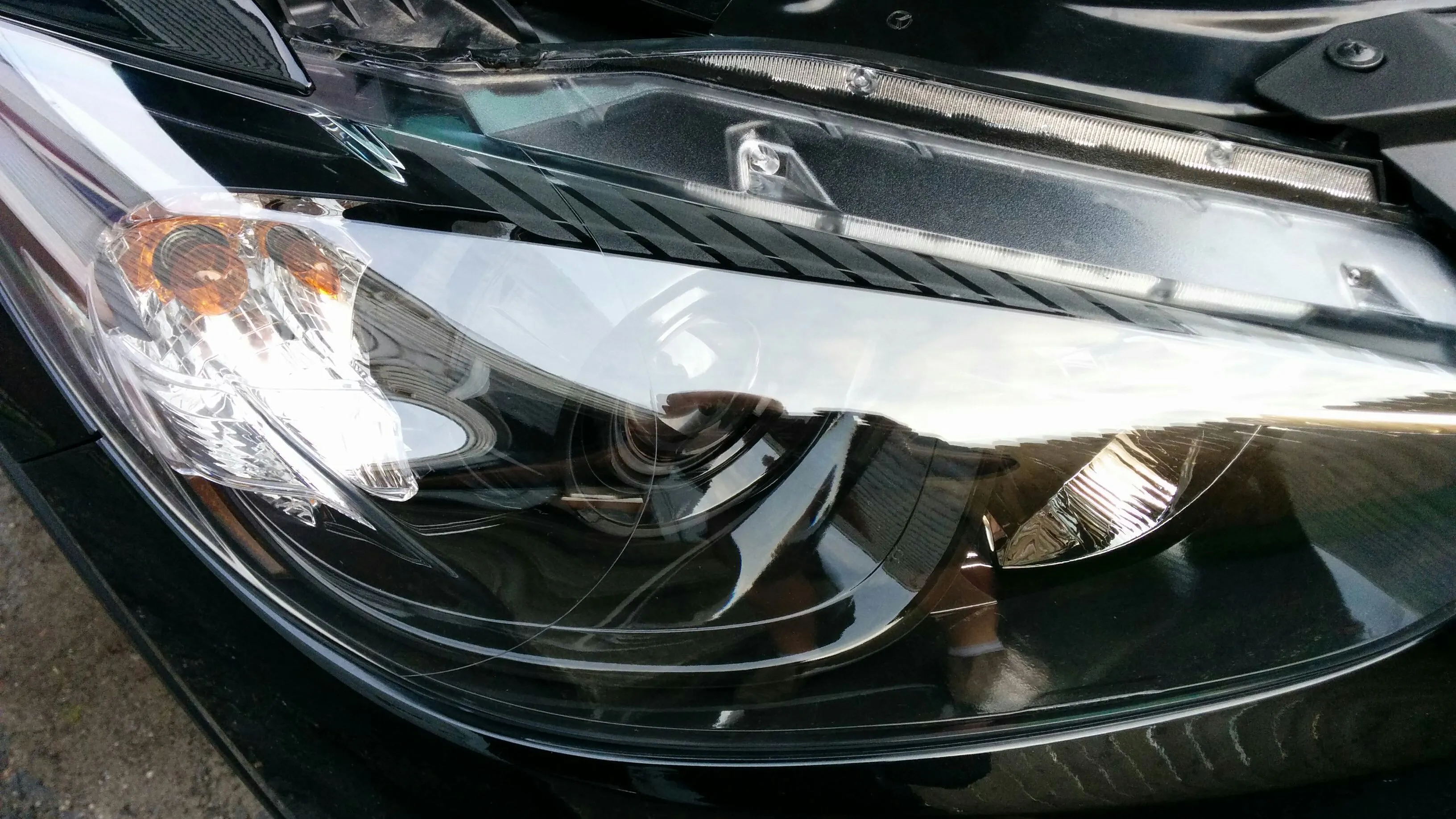

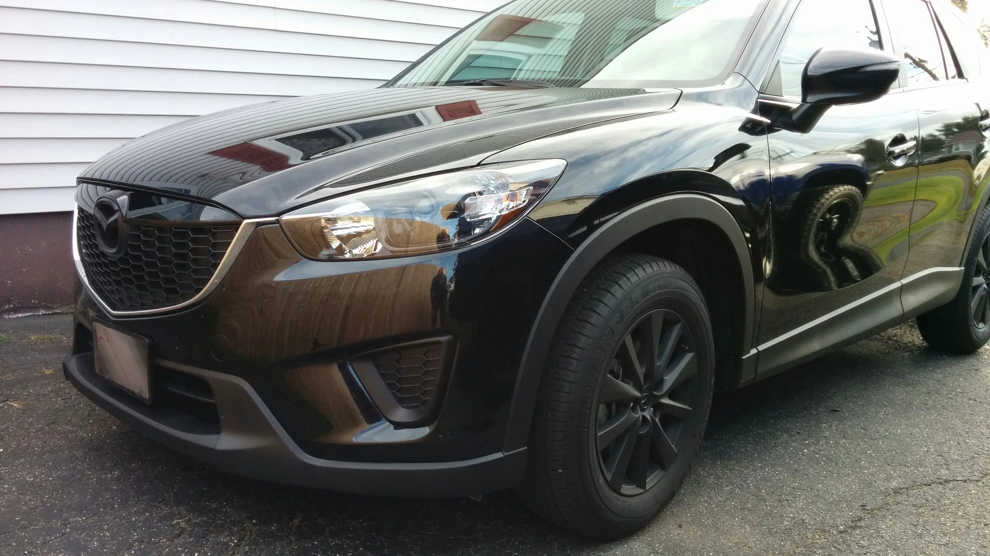

Couple of front shots to try and show the black housings again .. and a shot of the rear dummy fogs that I tinted as well.
