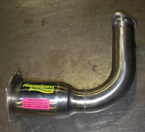

Here is the custom downpipe I mentioned above.

Also, after many hours of reading on this forum, there never was any follow up on the custom downpipe Wagnermotorsports was producing. I believe this was specifically for turbos -- it had a 2.5" diameter and came with a hi-flow pre-cat. I assume he could make one with a 2.25" diameter pipe and no pre-cat for n/a applications. Has anyone ever just removed the stock pre-cat and downpipe, and replaced it with a custom built piece? I wonder what kind of gain could be made with that? I imagine it would be pretty cheap to fabricate. Everyone seems to say the pre-cat and downpipe are the most restrictive part of the exhaust. Why not just eliminate that and save some $$$?
