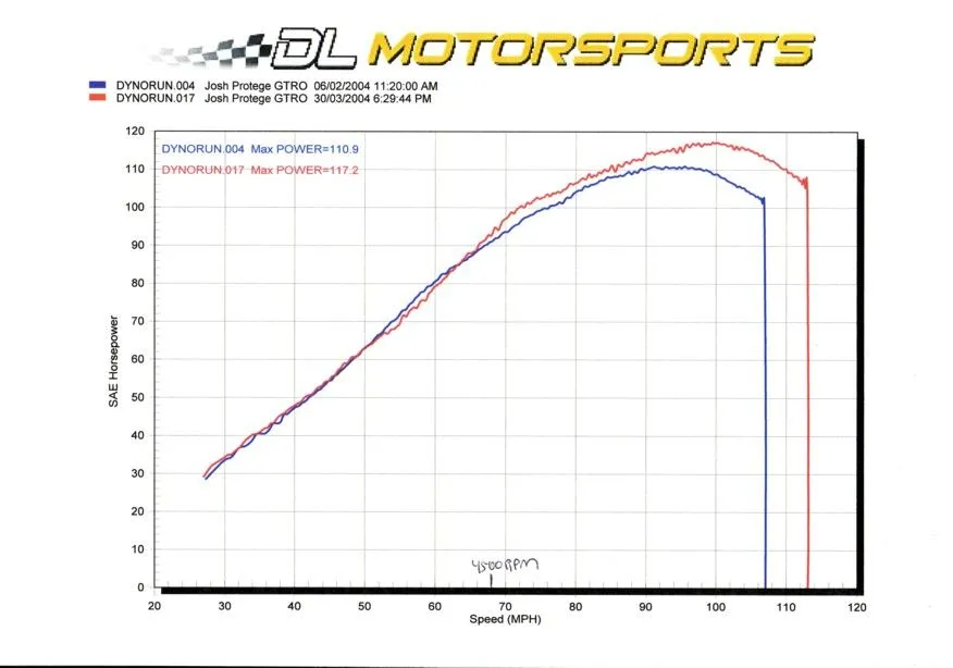

Velocity, not backpressure is what you're looking for. 2.25" is normally perfect for a smaller 4 cyl. I chose 2.5" because of the mods I'm going to be doing, and how high I'm going to be running(future 8000-8500RPM redline, 170whp). As you can see, I haven't made any gains with any of my mods below about 4400RPM(66mph, I mistakenly printed the MPH graph instead of RPM. The red line runs to 7400 or 113MPH in 4th), but it really opens it up, up high. But 2.25" would be perfect for your needs.
